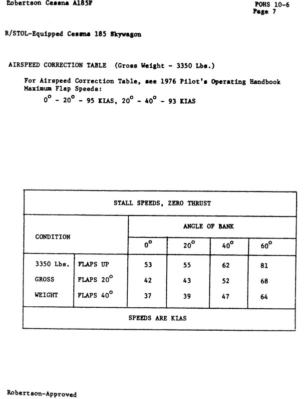

Robertson publishes 37 knots at 3,350 pounds.
What the hell is wrong with my plane?

"Robertson publishes 37 knots at 3,350 pounds."
-- Correct, at Gross Weight and specified CG. Every RSTOL 185 I've flown (a bunch of them) has stalled down around 37 kts in those conditions. And, the A/S indicators SHOULD be marked with the white arc down to 37 kts. I've flown one with a Sportsman cuff and RSTOL, and the A/S in that plane went to near zero at the stall....totally useless,
--There are a few possibilities: Pitot/Static system error, for any of a number of reasons. Improper wing rigging (eccentrics). Improper installation of the RSTOL kit.
I have met two Cessnas on which the RSTOL kit was improperly installed.
Here's a quick check you can run to verify proper actuation:
Sit in the pilot's seat, and observe the AILERONS as you deploy and retract the flaps. At 10 degrees flap, aileron deflection will increase to a couple degrees, a bit more deflection at 20 flaps, and more yet at 30 flaps. But, when you deploy flaps to 40 degrees, the ailerons should RETRACT some from the 30 degree flap deflection.
Have you checked the FLAP deflections, to verify they are properly set, and accurate? Are they in fact deflecting to Cessna specs?
It is possible that the aileron "droop" isn't set properly. You can measure the droop at various flap settings. The precise amount of aileron deflection at each flap setting should be in the install manual and the maintenance paperwork.
I have also met at least one Cessna with RSTOL installed which had NO aileron deflection with flaps.....the RSTOL system was either improperly installed or had been disabled. No logbook entry. I didn't fly it......not airworthy and who knows what was done???
Finally, did the airplane roll off aggressively at the stall? Could indicate an installation problem as well.
