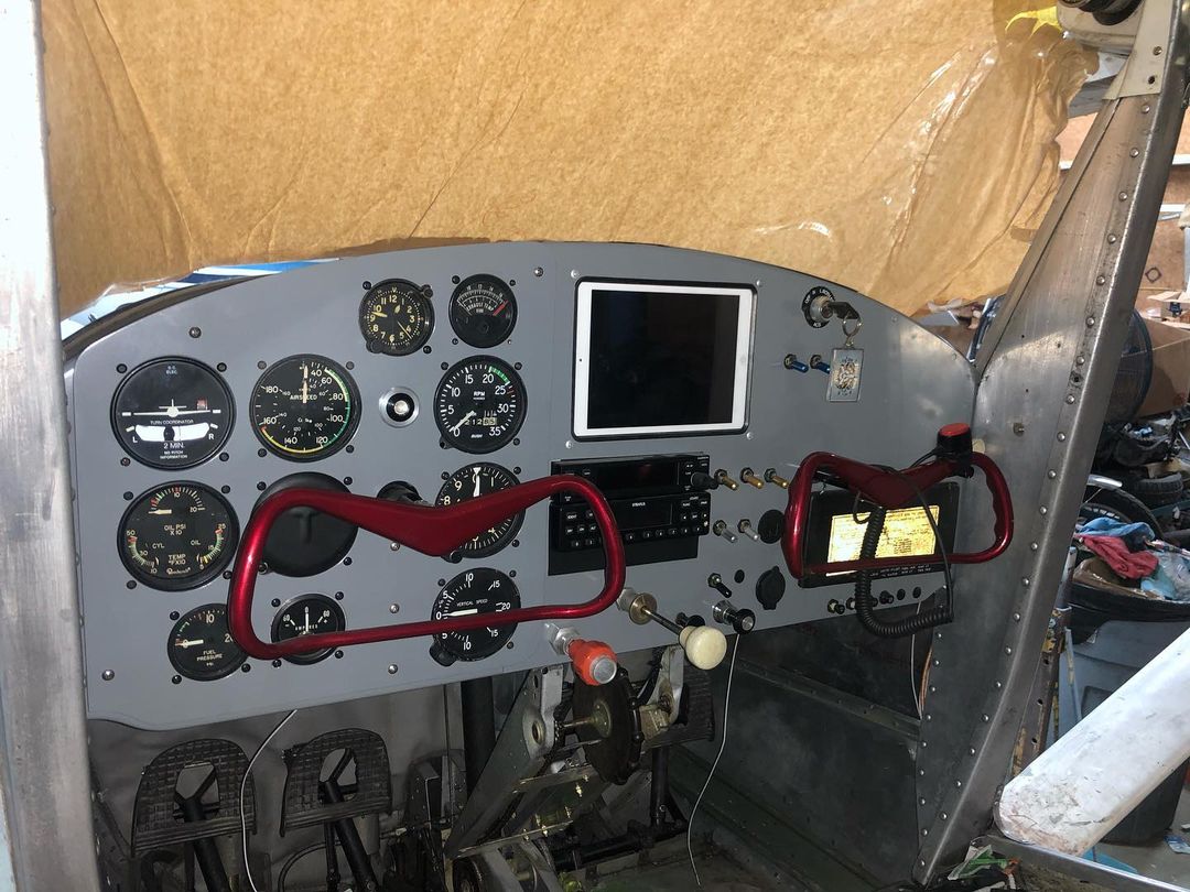

Looks like you are planning to do the panel about the same way I did my 150B, but I went basic vfr for mine. Hopefully the pic of mine will help you lay out yours. All the switches are breaker switches also to clean up on the amount of circuit breakers I had to have, I also moved the headset plugs behind the seats to the door post. Love your plane!

Some great examples of workmanship, very nice. =D>
I'll be thinking twice about posting my instrument panel upgrade efforts when complete they are pale in comparison. :roll:
