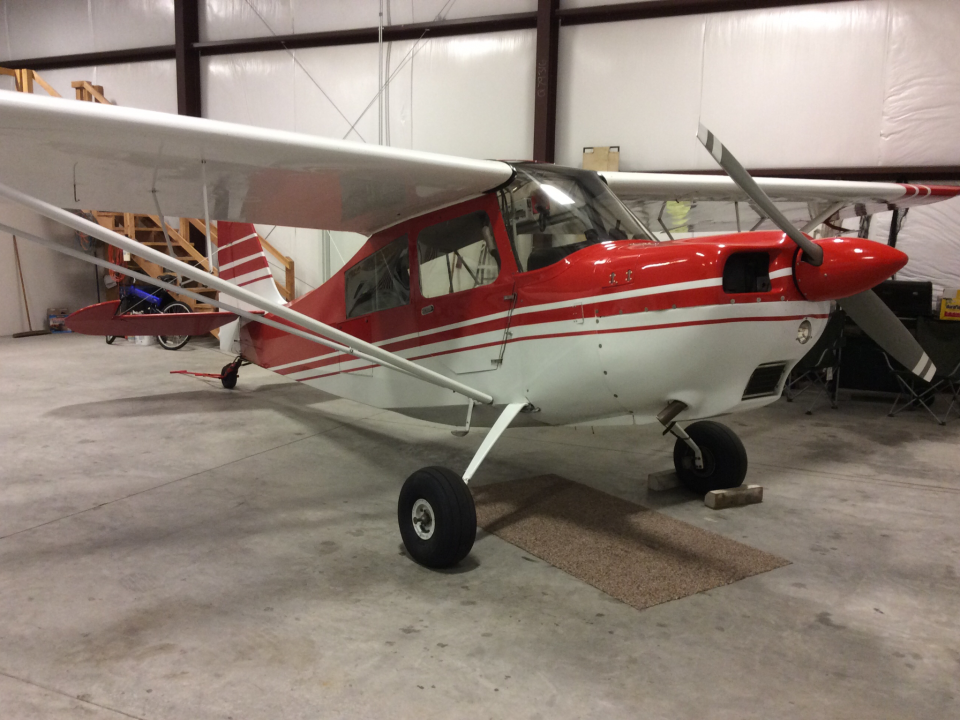

Removed the aft wood floor boards and the last of the fabric on the bottom of the fuselage.
Then we towed it to the wash rack and gave it a good bath.
A couple aviatrix friends stopped by and checked out the project.
Then we towed it out into the sun to dry off. It was a warm winter day here. Maybe 70/72F in the sun.
Once it was nice and dry, back into the hangar it went. We put some padding on the top of the vertical stab and let the tail raise up to the ceiling. This makes it much more comfortable to work on the fuselage.
The engine and firewall forward area cleaned up really well. The ugly and beat up baffling needs to go...
It’s already starting to look a lot better just with all the dirt washed off.
The lower wooden stringers all stained and gross from dirt and water.
A couple wooden formers completely broken at the bottom attach points.
The next step is to remove all the wood. We’ll do it as a one piece cocoon (excluding the bottom stringers).
This is not only a nice reference during reassembly of the new wood, but it also looks pretty cool hanging from the ceiling of the hangar once the project is done.

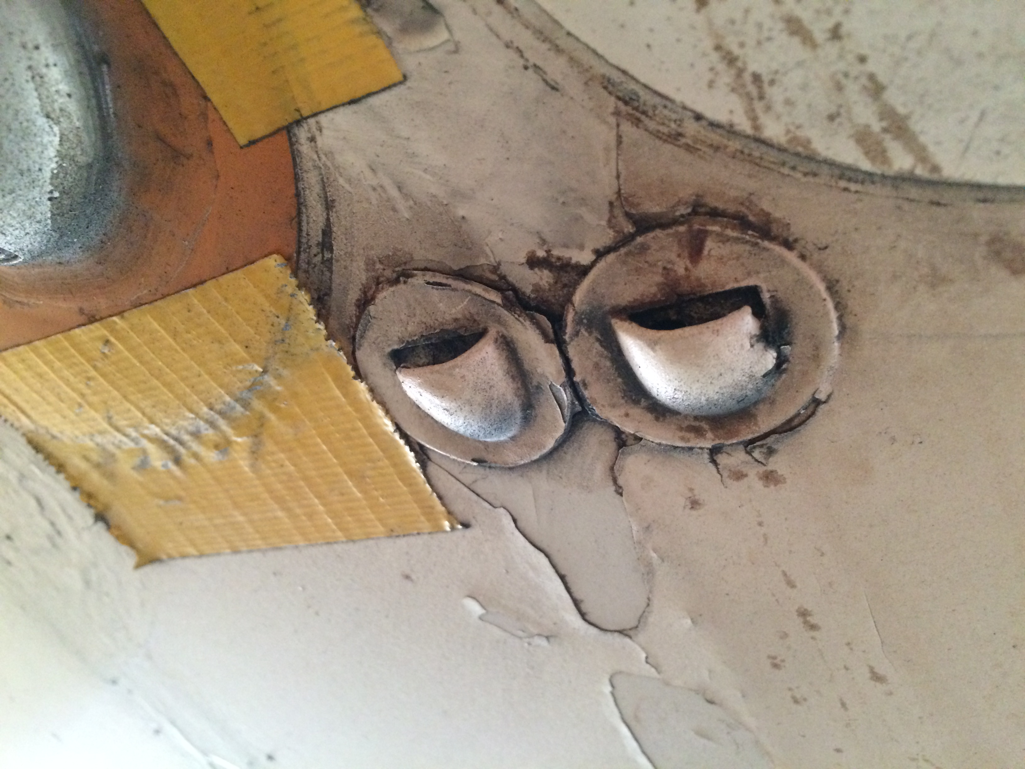

Somebody was mentioning drain grommets on the belly. Mine has these, don’t know if it was part of the seaplane kit (extra corrosion paint on the tubing). Yeah, I’m on this thread because I’ll be doing fabric real soon.
