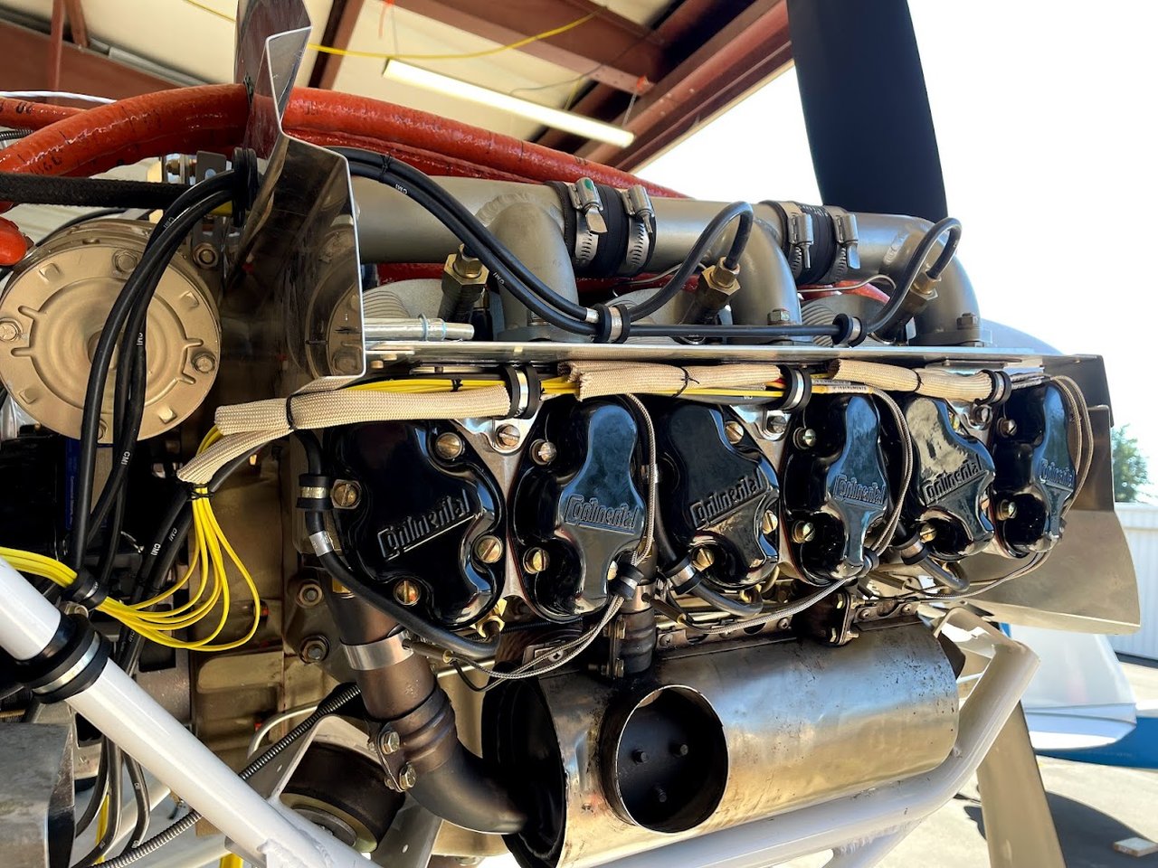

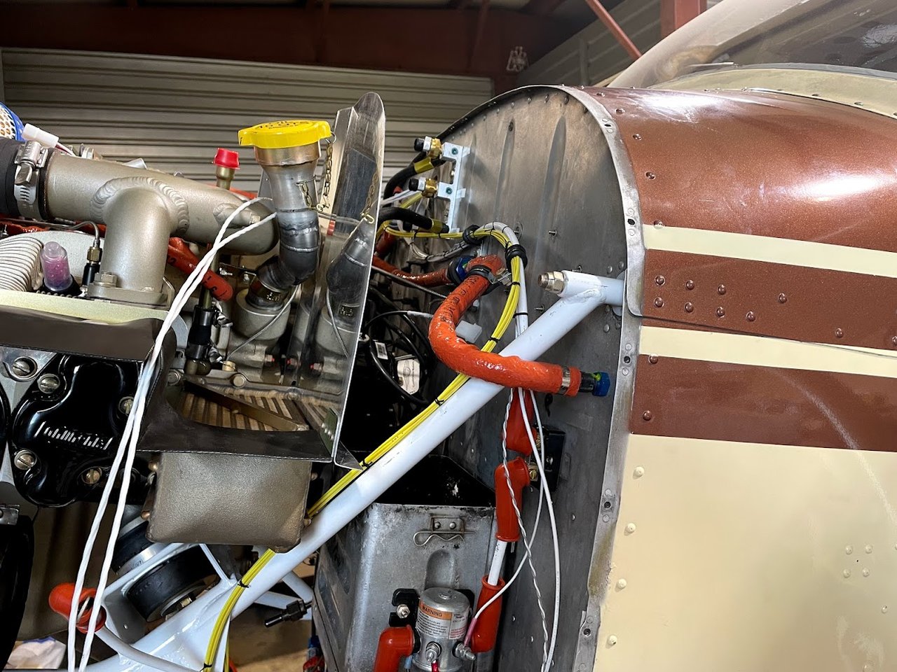

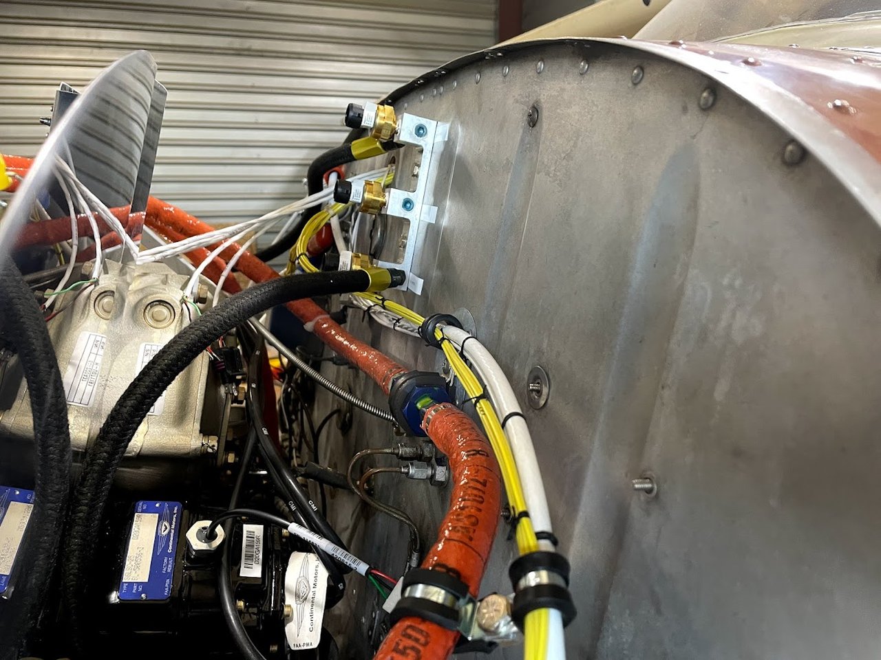

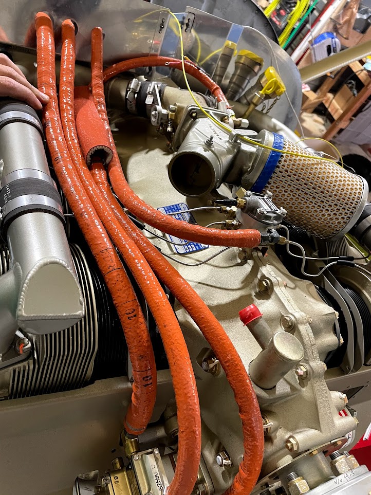

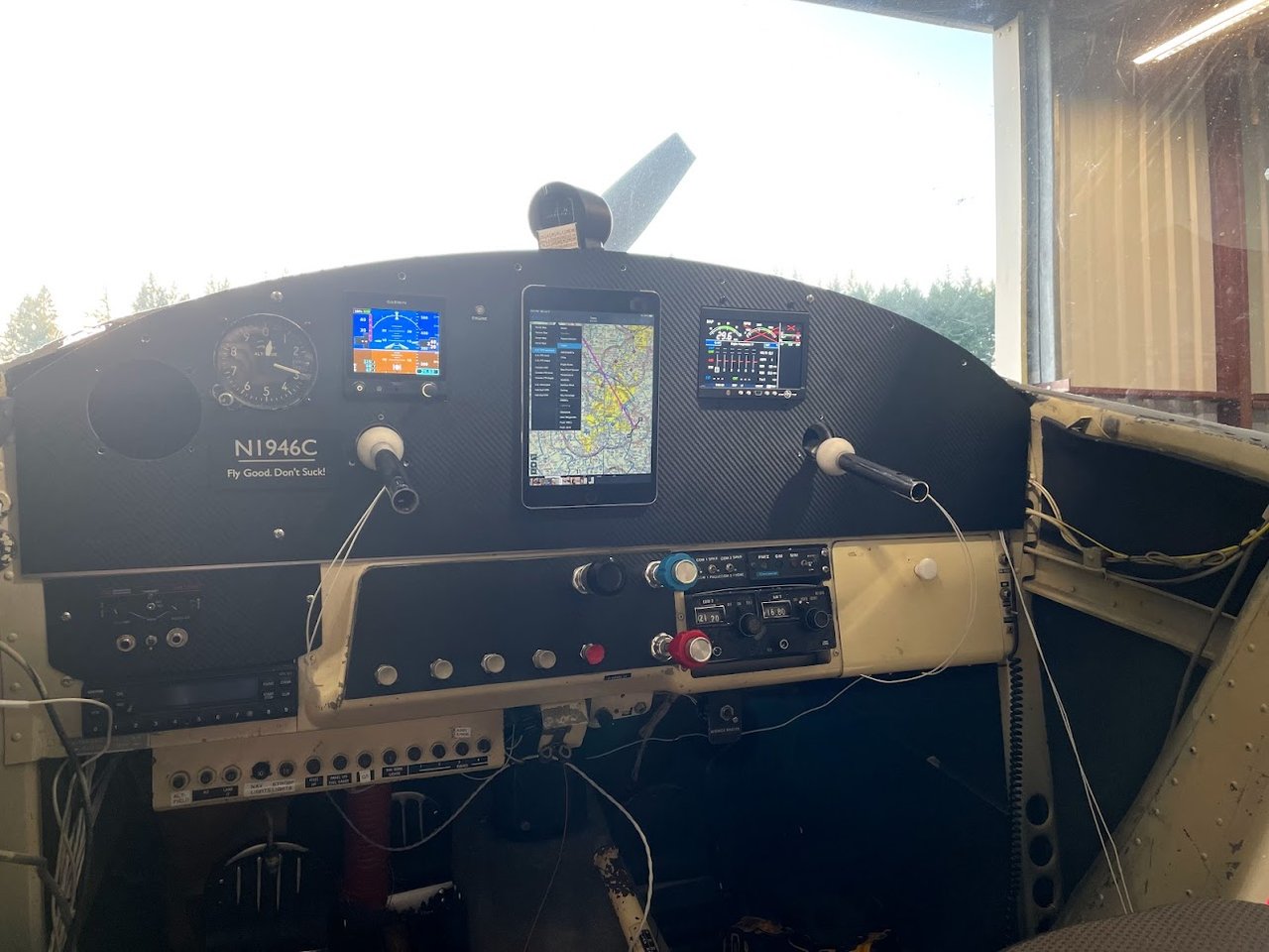

Lots of wiring and lacing. Panel lit up, still wrapping up some odds and end. Right half of the engine wiring is complete. Last of the fuel lines made. It's probably gonna take 5 gallons of gas just to fill all these fuel lines!
