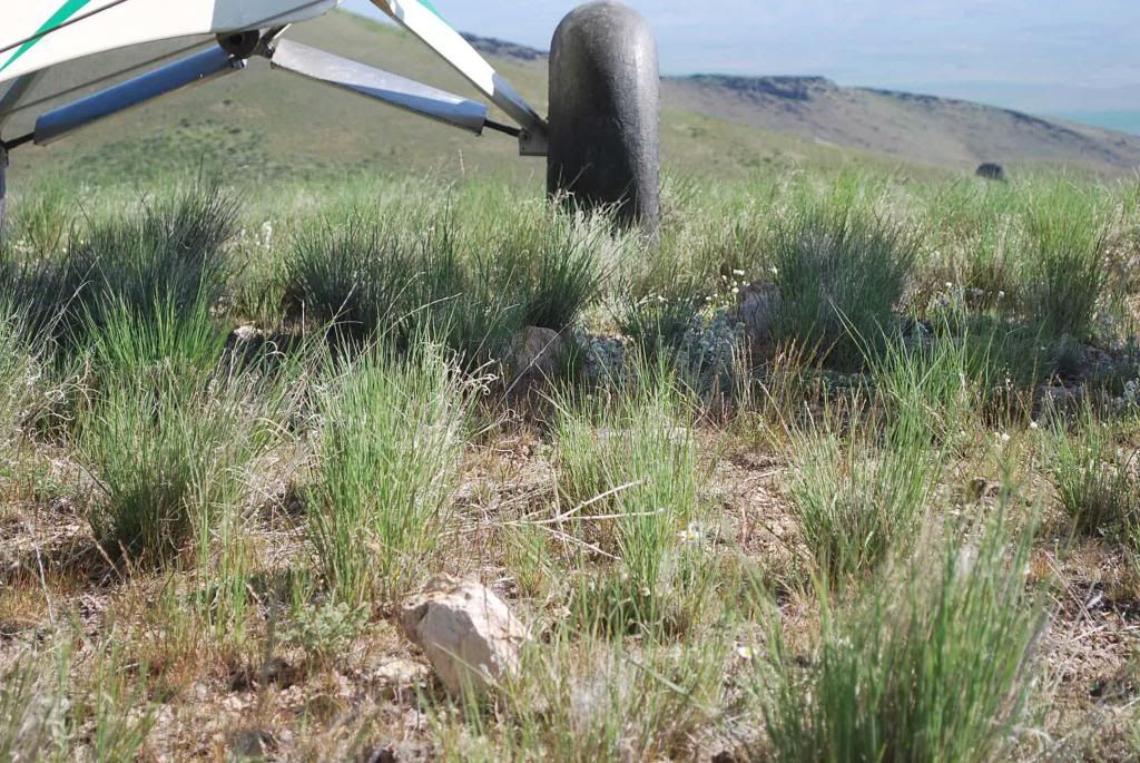

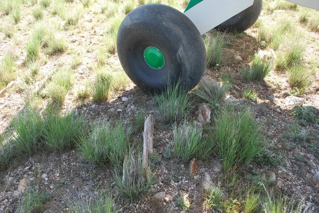

I've managed to land it on some hill tops:
If you got some time in my Savannah, I think you'd be saying Desmond's strip looks like a lot of fun even with average balls :)
