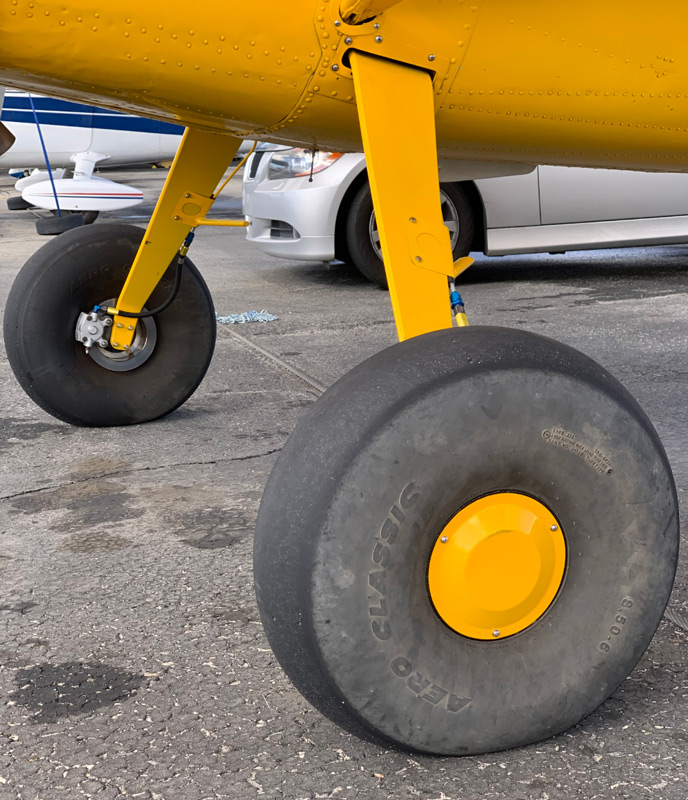

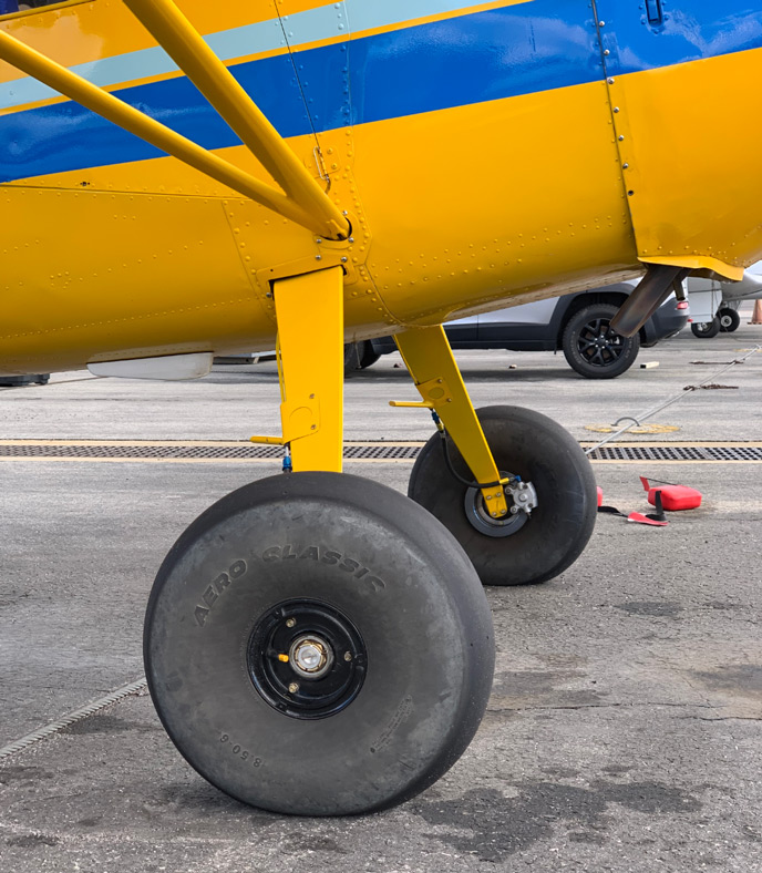

Trying to decide if I want to keep my hubcaps on of off. I prefer off from the ease of maintenance standpoint, but I would like to keep the dirt out of my wheel bearings as much as possible.
I vaguely remember there being a mini hub cap that only pops over the axle nut. Is that right? Or am I making that up?

Never have I seen anywhere a cap just for the axle nut/bearing. As in a bearing buddy for a utility trailer. Now there are several options out there that allow the tire valve stem to protrude for air servicing. Also knots2U has a product that is a bit pricey ($265) but nice quality fiberglass covers with a access hatch for servicing. Also have $30 sheet metal hub caps new, unpainted on ebay.

I believe the Cleveland hub cap number you are looking for is 158-00300. Google it and you should have a few options for purchasing.

Are you going to run those tires at relatively low pressure? If so, I’d forget the hubcaps to avoid the hassles of checking pressures, which you should do frequently when running low pressures.
Unless you can find something that covers the bearings, but leaves the valve stem open.
I’ve run these things without hubcaps for a lot of hours and never had issues with wheel bearings. I wouldn’t worry about it.

Just out of curiosity, has anyone who does routine maintenance ever actually experienced damage to their bearings from not running hub caps?

The Cleveland 40-101 wheel used on Ag Cats has a dust cap that covers the bearing and axle nut, fits in the hub and held in place by a snap ring. I repack my bearings every 250-300 hrs when rotating the tires and don’t notice any damage from our corrosive flying environment.

it takes me less than 60 seconds to pull 3 screws & remove the hubcap.

Do you mind posting a photo showing how it snaps on next time you pull it off? Just curious. I looked up the part number that richpiney posted, it comes up but it's rather pricy at $100/pop. I was thinking I might just 3D print something that pops on and catches on the axle nut cotter pin.
In response to MTV, I've had the caps off for the last 80 hours or so, my bearing grease was black but I wouldn't call it dirty or "damaging." So you're probably right, however, it gives me a little piece of mind knowing they are somewhat protected.
