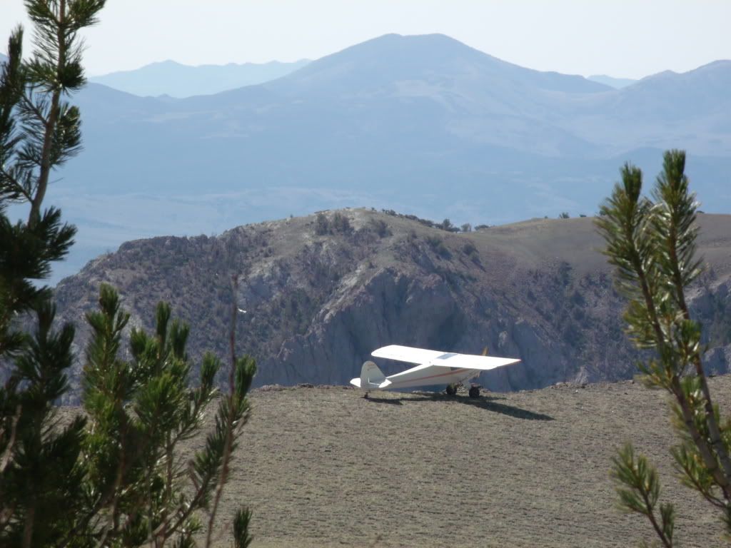

Coyote Ugly wrote:T Cart in Super Cub country.. No Electric drills.. ha ha
Nice place and pictures Joe! I would not be surprised to see some pictures of the T-cart on Bunker hill or Arc Dome Mountain soon!!
That might be asking a little much from the T-Cart, but if you do It, I would like to see the pictures!

The picture above should be submitted to AvWeb for their picture of the week IMHO. The Title sent along with it should be "65 Horsepower Taylorcraft Lands at FL100"
Like all of us, my hat's off to Pops. I'd be honored to learn some of your tricks.
