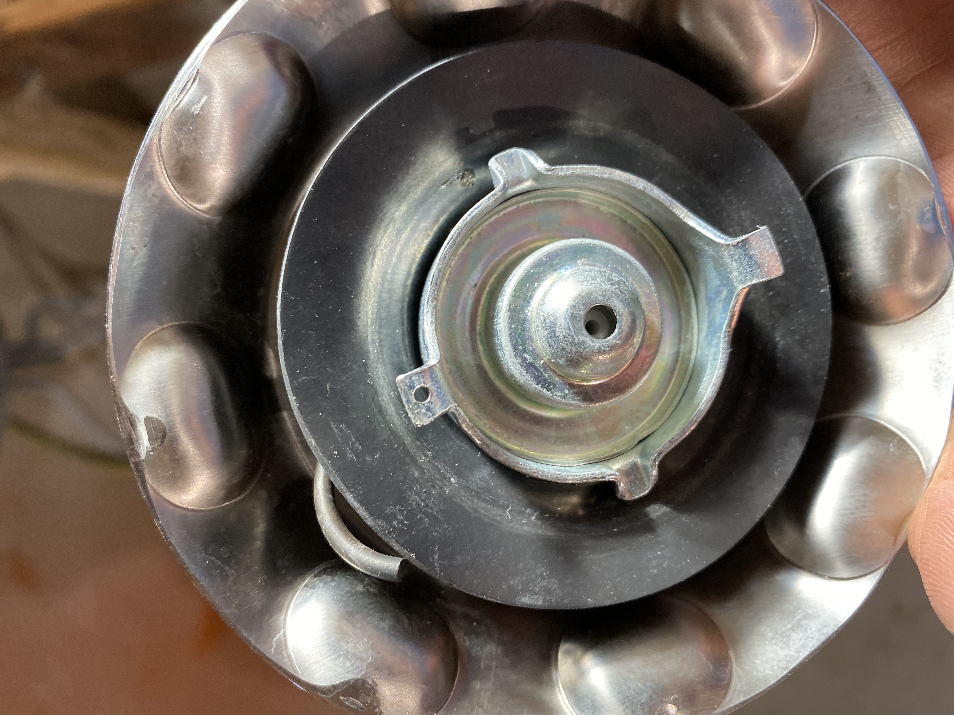

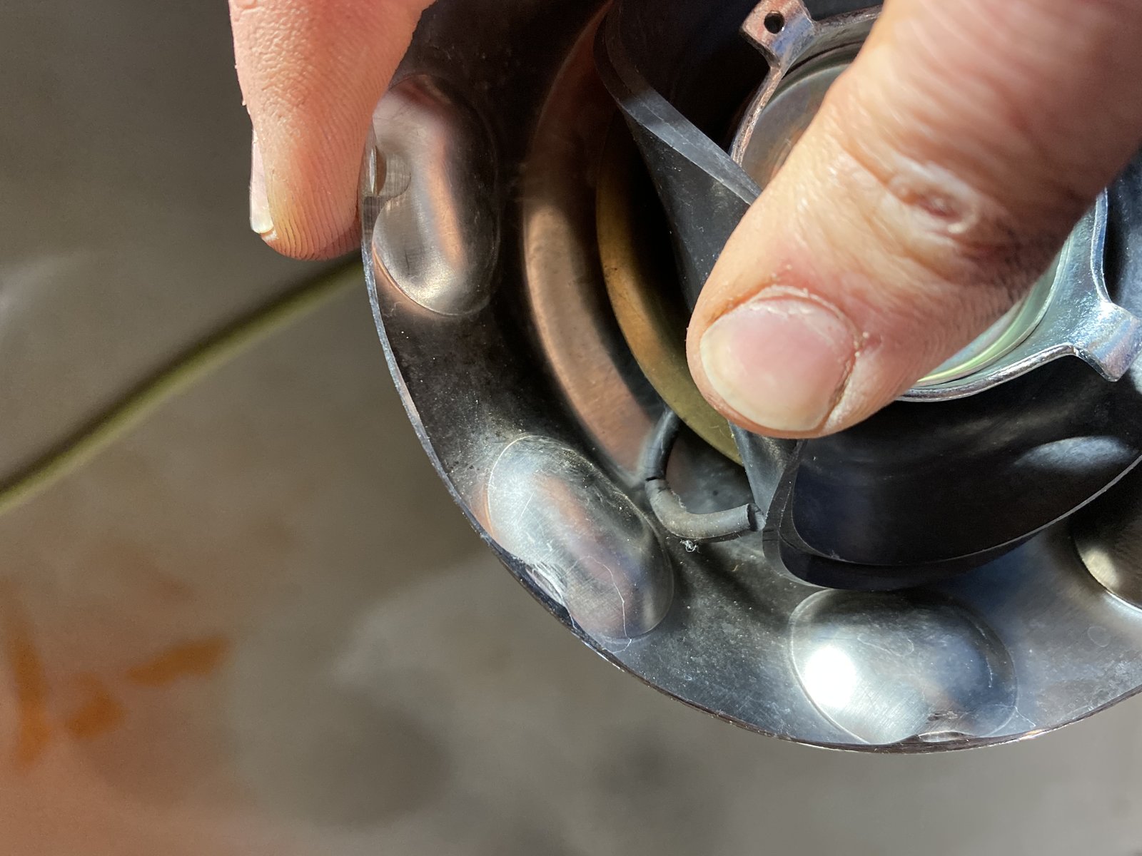

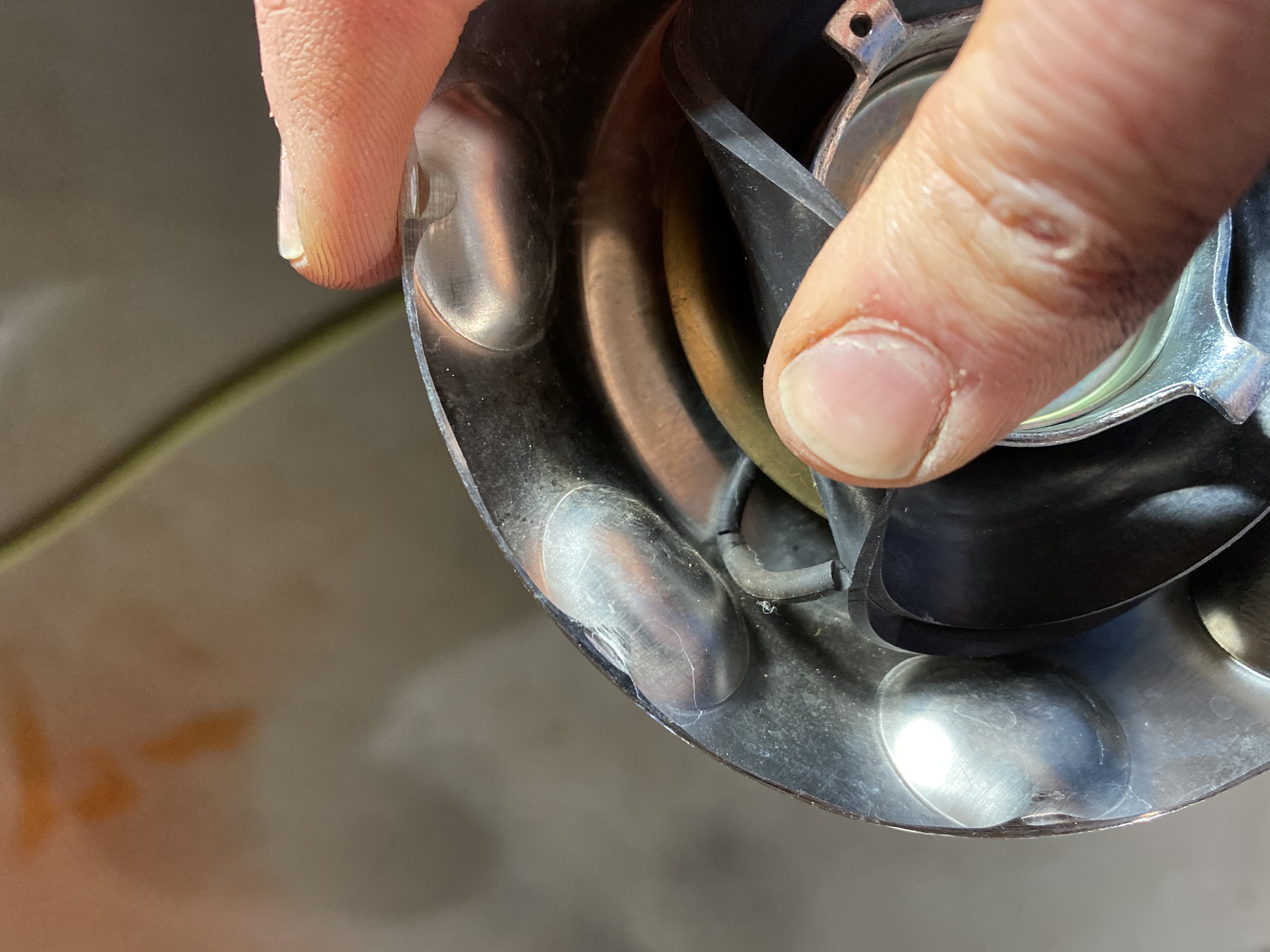

Question for you guys with Monarch AUX tank caps...
I noticed this piece of rubber hanging down out of one cap. I went and checked the other cap and it too has the same rubber hanging down. Almost looks like one end of a broken O ring that sits above the gaskets, but I can’t be certain. It’s also pretty checked and cracked out. Still waiting for a response from Hartwig.
Any idea what these pieces do? I’m a little concerned it could end up in the tank eventually. Below are pictures of each cap left and right aux.

I’ve also had to run double gaskets on these AUX caps to keep them from leaking. Main tank caps work fine with no issues.

I’ve got Monarch mains and aux on my ‘56 C180. Love ‘em.
I also run double gaskets on the aux caps. I change them every couple of years or so along with the O Rings in the main caps.
I use Buna gaskets and O Rings I procure locally (oil field supply) and have had no issues at all with leaking.

Thanks.
Do you replace an o ring in the aux caps above the double gaskets? Or just an o ring in the main tank caps?
Do you see that broken o ring in the aux cap pictures? Do you replace that too?

I just replaced O Ring in the main tank caps.
My aux caps didn’t have that broken O Ring you showed in the picture. It makes me wonder if it is missing on mine, and that is why the flat gasket was doubled up.
I’ll take a look and post what I find.

Re: Adding Monarch Aux Tanks to a '55 180
Yeah I find it odd that both caps would have it broken. Caps are less than 2 years old. Never would have known unless I reached in there more with a pick. Almost looks like it’s always been broken too me. They don’t leak ever since I doubled up gaskets. Still no word from Hartwig.

As an update, Hartwig is providing 2 day shipping both ways and fixing the issue.

I have the 18gal Monarch aux tanks in my 185 and do not see that oring/tube in either of mine.
I do need to get new gaskets however and wondering where you get them.
I use "Fuel Lube" on the gaskets to make removing the caps a bit easier.
