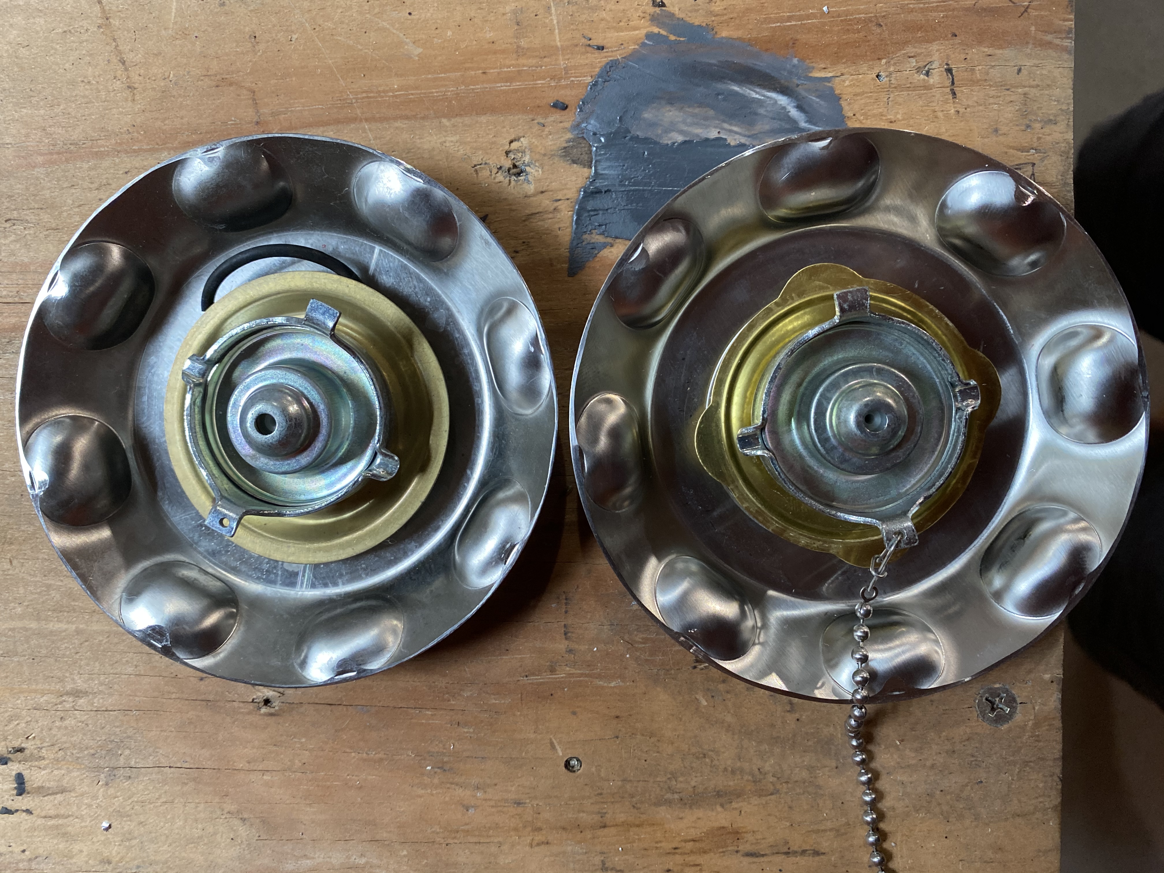

Hartwig sells the Aux Tank cap seals for about $25/pair. They don't last very long - they compress quickly. I also have been using Fuel Lube on both the main and aux seals and it helps. I'll probably make my own next time.

Update on AUX caps.... got warranty replacements after about 4 weeks. Judging by looks of them, they’ve made some design changes. Old is the top cap and new is the bottom.
