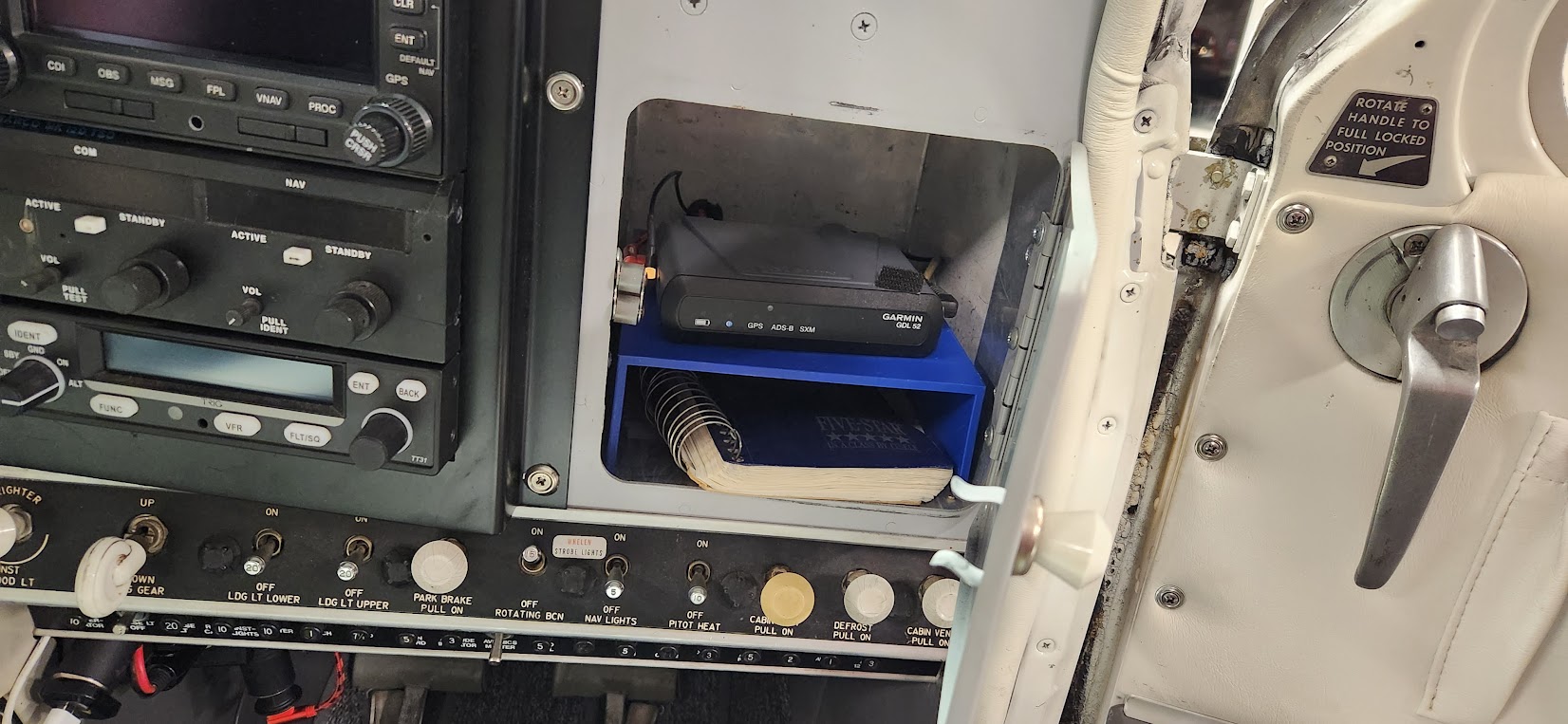

I have a GDL-52 that is bluetoothed to a 796. I put the 52 in my glovebox so it doesn't clutter up the top of the glareshield. I subscribe to XM weather as well as XM music. I get XM weather because I can't get ADSB weather at the back country strips. The 796 is set to auto for the weather choice, it uses which ever it thinks is best.

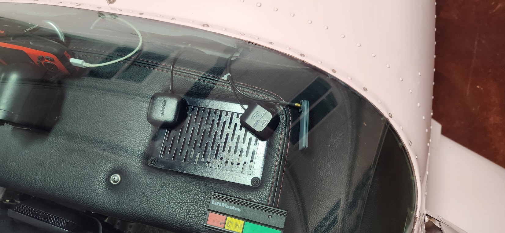

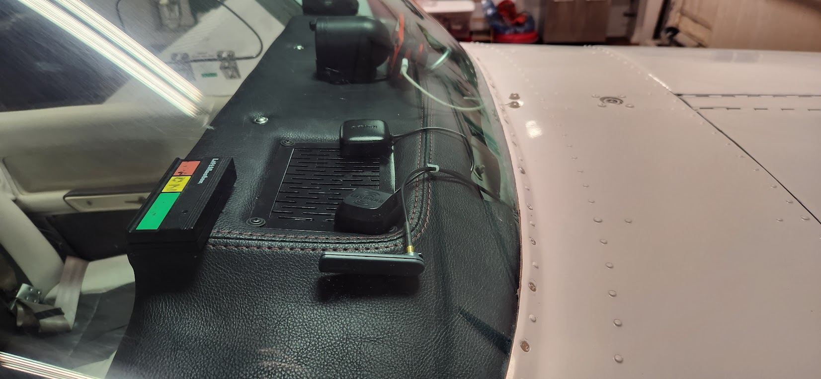

Re: ADSB In/Weather
mtv wrote:So, to clarify, for you folks mounting a GDL 5X in glove box/under sheet metal, are you or are you not utilizing an external antenna for XM weather?
Thanks, I too hate that thing on top of the glareshield.
My set up.

Thanks, Scott, that makes sense. The way I was reading previous posts, it sounded like some had GDL mounted internally, but with no external antenna, and I was trying to comprehend how that is possible.
