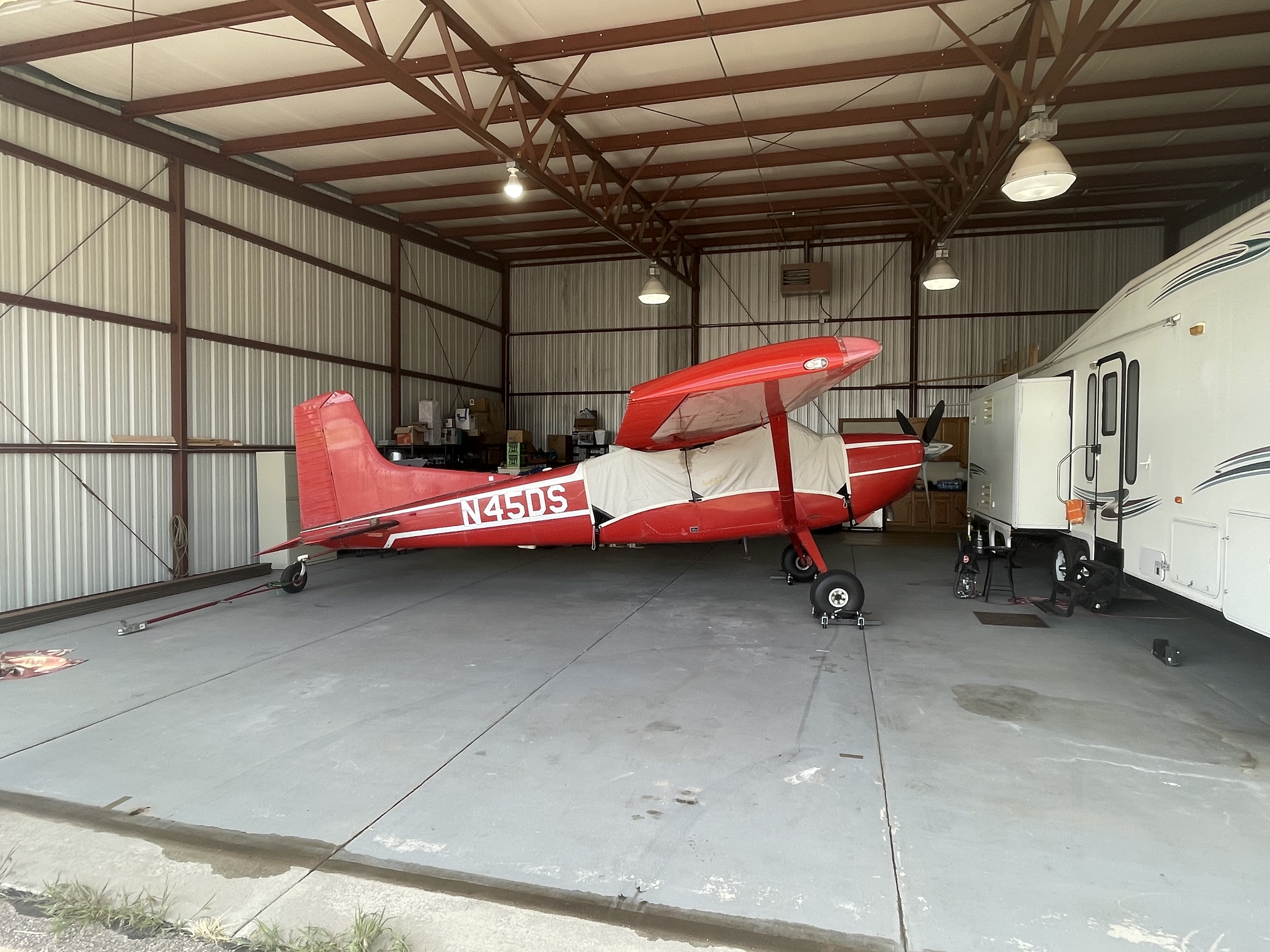

Yep, I've parked a 185 in a hangar that was cheap, but had an RV parked along one side. Pushed it in as far as we could, then put it on a set of these and slid it in sideways. It was a good temp solution for a few months while we brought it back to life and the owner was finishing up building his hangar at his home strip.

Keep in mind you only want to move with these ratcheting dollies as your tire will take a set in short order and make for a bumpy takeoff.
We usually lift the plane, place a wide 2-by across the jack arms and then set the tire on the wood.
Used a set of the better quality self lifters on a Beaver with no wings and zero fuel that was on 8:50x6 rollers ( ask me how and fotos if you have a need) this winter. Long ago they had been reinforced to use in a float Beaver but really were not up to it. Even on my project they were maxed out. I just used them to move the aircraft, then pulled the rollers and wheels and set the axals on some 4-by blocks get in with my show.

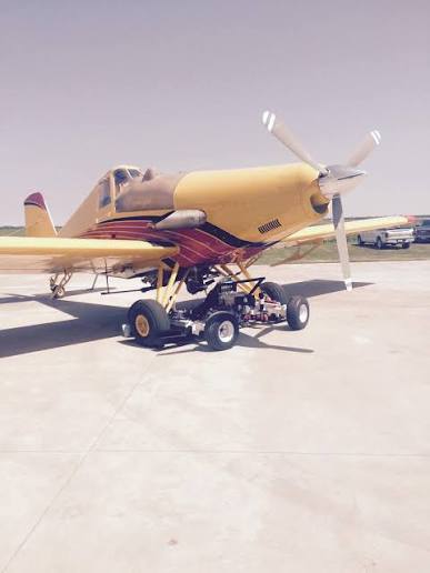

It's a Sidewinder. Made by Lyndley Johnson of Johnson Airspray in Argyle, MN.
More pics here
https://www.linkedin.com/posts/elliot-seguin_aircrafttug-hydraulics-agriculturalaircraft-activity-7296534702956363776-vQL5
