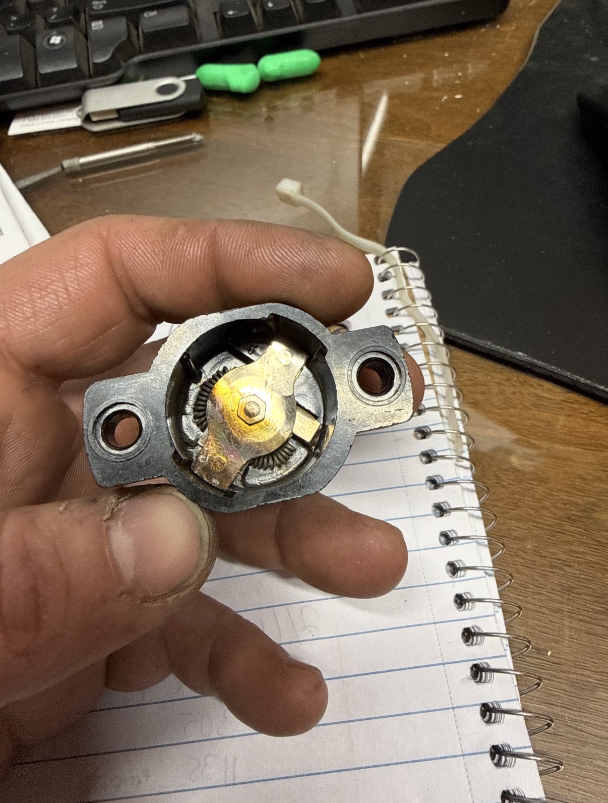

I know it's been just over 10 years since this thread was active, but I can't find anything more recent and I currently have a possibly-related issue with the stall horn on my '54 C180.
The stall horn started coming on at random times, including in level cruise flight at 130 mph and during my pre-flight walk around with all the switches on. It eventually goes off if I flip the flap up and down enough times, but I have yet to try this after leaving the ground. I'm thinking grounding issue or crud in the switch, or both.
As an extra detail, my stall horn is wired through my nav lights, so I could shut it off if I had to, but this also shuts off my Tail Beacon ADS-B Out
flyingzebra wrote:I've had the exact issue pop up a few times on my '54 and have cured it with a very careful disassembly and cleaning. Replacement is some insane amount. little spiders seem to like the pricey real estate. Maybe spider poop is conductive, dunno.
Any chance FlyingZebra is still watching this thread and can provide a few more details about his disassembly and cleaning technique?
I just looked at the price of a new lift switch and I'm hoping I can fix this with some TLC

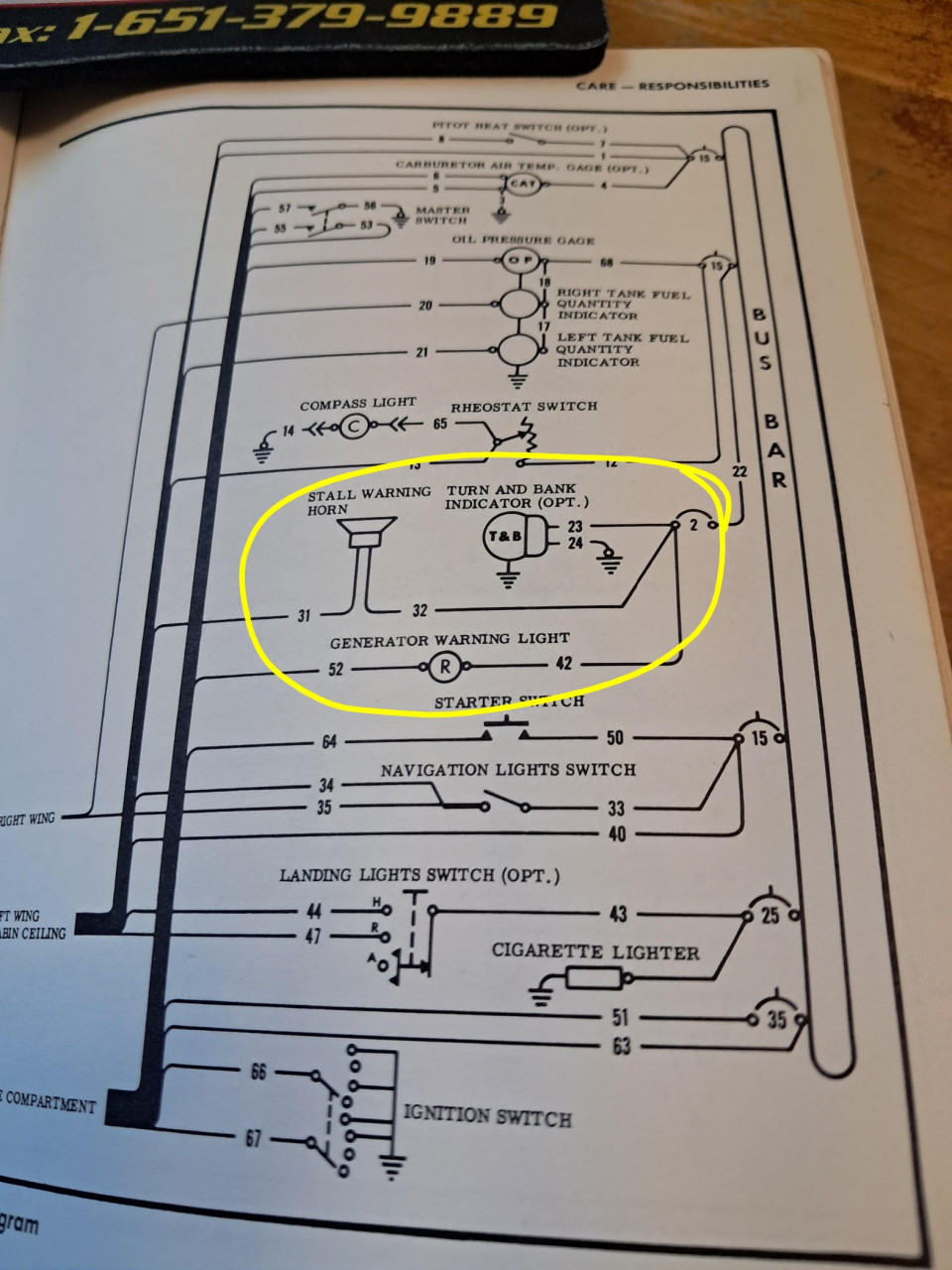

I would remove the stall warning switch (flapper assembly) & clean it up, and see if that helps.
I had an issue with the stall warning system on my 1953 180 a few years ago,
but as I recall the problem was actually something goofy with the horn, not the switch.
Personally I would also re-wire that stall warning system-- either put it on it's own circuit breaker,
or (more properly) reconnect it to the auto-reset breaker behind the panel that the turn & bank should also be connected to.
Here's a pic of the basic wiring diagram in my 1957 owners manual,
looks like a generator warning light (which my plane doesn't have) goes on that same circuit.

Thanks for the advice. I’ve taken the lift switch out and of course I can find nothing wrong with after testing it with a multimeter. I’m guessing there’s some corrosion somewhere and it’s sensitive to moisture, but I don’t see any non-destructive way to open it up and actually see the contacts.

'self-resetting CB'. See 2 A CB in the wiring diagram snippet previously posted.
