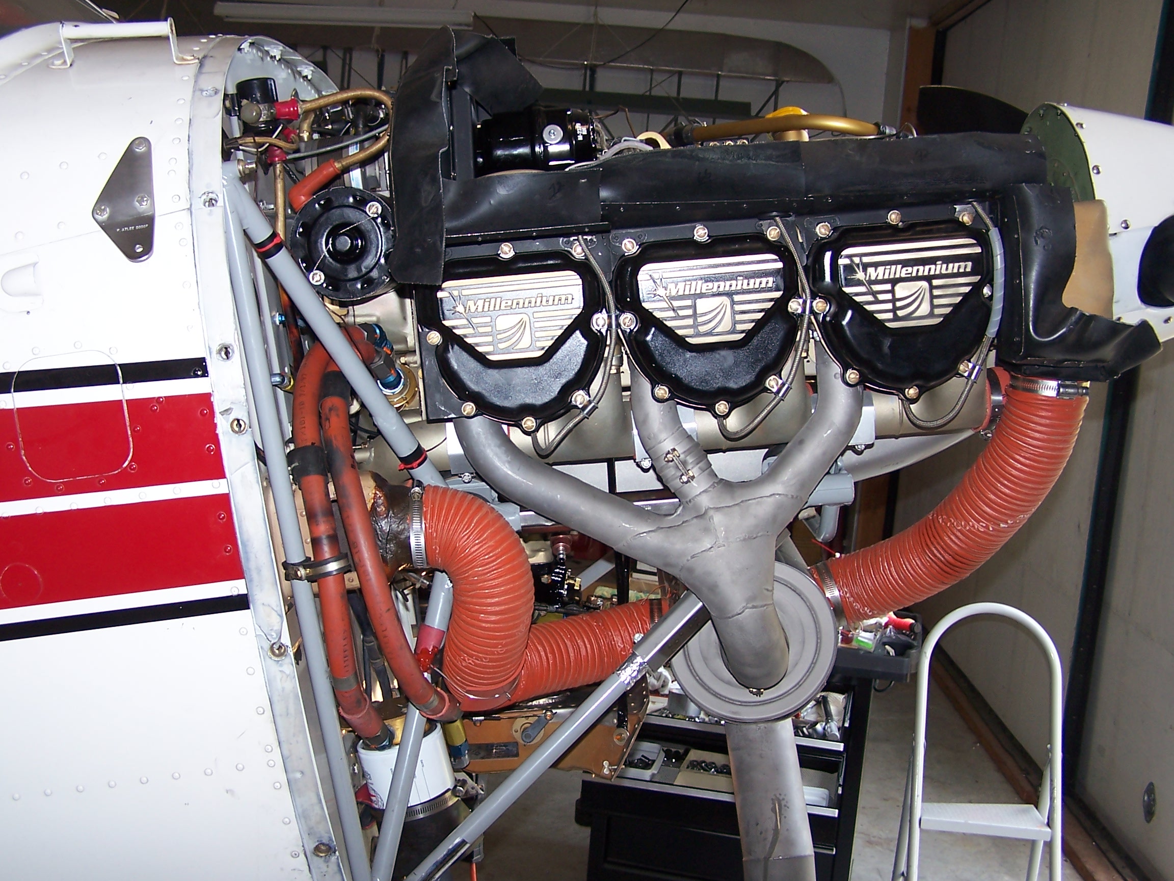

I just bought an A185F that still has the screen in the 520. I would like to covert it to a spin on filter.
Anyone have that setup with pictures of where it was mounted and hose lengths?
I was thinking of mounting it on the firewall pilot side.

Not an IO-520 but thought it may be helpful. Airwolf on our 180H (O-470R). I would suggest mounting above a cowl flap which allows easy filter R&R without removing any cowling. Simply pull the pin to disconnect the cowl flap actuating rod allowing cowl flap to drop further and there sits the filter. I wrap the lower half of filter with a piece of butyl to prevent any possible chafe from the one cowl flap stiffener as its close but have had no issues. Make up your pan drain hose that reaches from pan quick drain to either cowl flap with enough length to enter the drain bucket. It is a stretch with one's arm to reach the quick drain through the cowl flap, however, it works and makes oil changes quick and painless. Full disclosure, I have a 36" reach.

Thanks! Looks good
