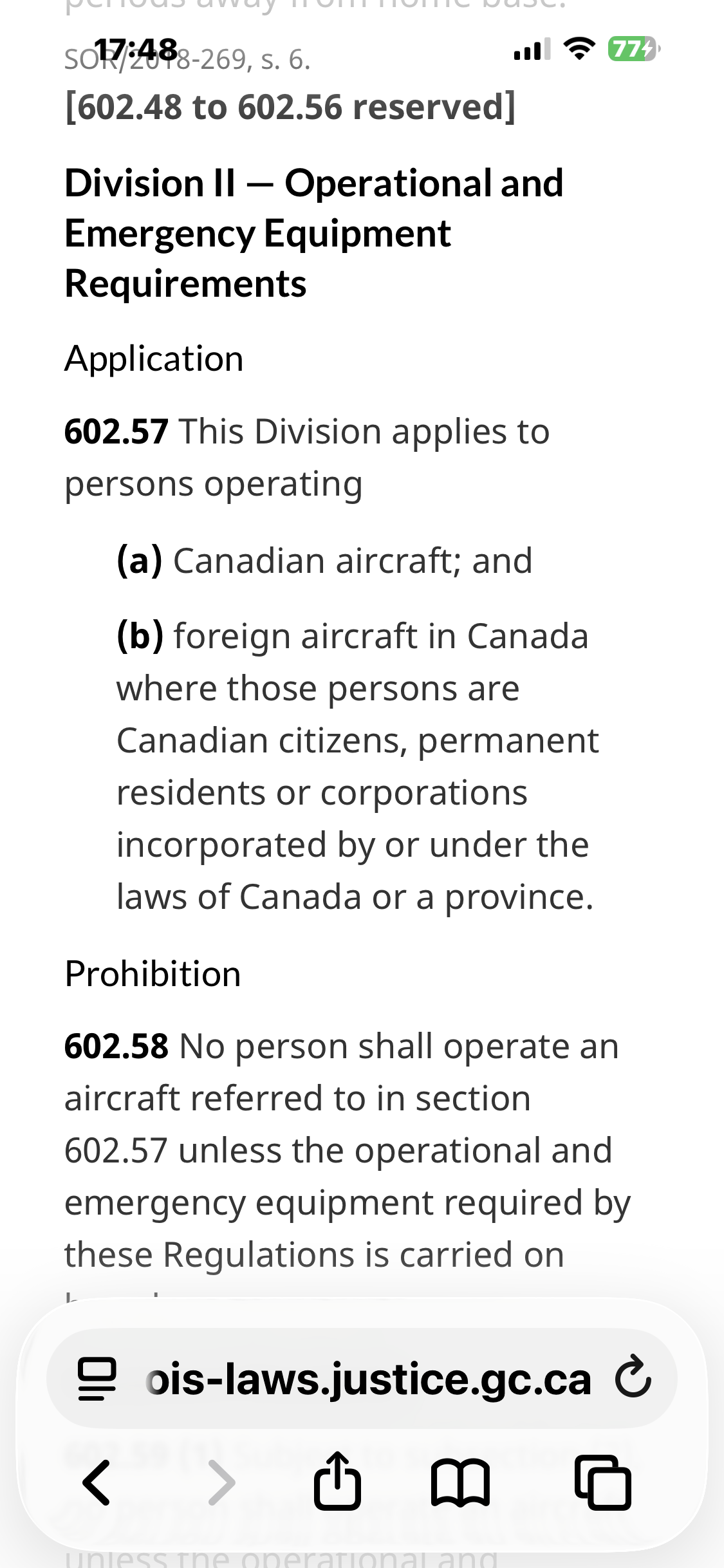

Hmm, we fly through US airspace all the time (departing in Canada, landing in Canada) without a flight plan. The reference on first aid kits and fire extinguishers is under CARS 705 (like FAA part 121). I didn’t see it for the equivalent of Part 91.
I’ll dig into it a little further. Might just be a rogue customs zealot.
SOR/96-433 is referenced. Here is who it applies to (doesn’t seem to be US GA).

Ted, that's interesting about the fire extinguisher requirement (even if it doesn't apply to U.S. aircraft transiting between AK & lower 48) -- the requirement you posted seems to say that not only do you need one for the crew, but 2 for the passengers from 0 - 60 passengers! So if you have 2 crew (Cub for example), you need 1. But if you have a 4-place airplane you would need 3 (1 for crew, 2 for passengers)! https://fly2ak.com/PDF/CanadianAirRegs.pdf

Nothing has changed. Doesn't need to be Halon and only need one accessible in the cabin for most private registered aircraft.
