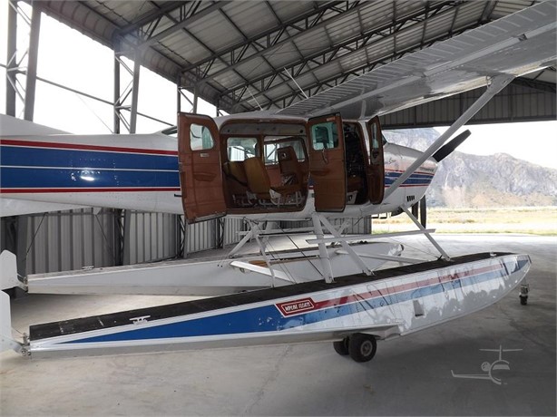

I'm starting to contemplate a family adventure plane. It is me, my wife and two kids. The top two I'm looking at are a Boss 182 and a 185. These would pull some general travel duty, but ideally alternate between amphibious floats and bigger tires. Bigger tires would be for unimproved and maybe some off airport stuff, but nothing really crazy.
The Wipaire package looks pretty impressive. With the 3500 lb gross weight you can still have 950 lb useful load on amphibious floats. That will carry my family, some gear and still about 50-55 gallons of fuel. They advertise improved CG as well compared with other float equipped 182s with the ability to run two front seat pilots and full fuel.

A 206 is definitely in contention. However, from what I have seen a 206 on amphibious floats has a useful load of about 900-1050 lbs and the Boss 182 with the max gross weight STC can have a useful load of 950 lbs with better performance. The 206 wins on loading/unloading with the back doors for sure.

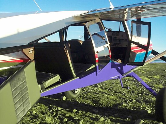

The issue with the 185 is if you’re putting stuff in the back.
185 only has two real doors, plus a SMALL cargo door, and it’s a narrow plane
185 is a sexy 2 seat pickup truck IMHO

Thank you. I do understand about the 185 small baggage door and narrower body. That isn't a bad useful load though.
The 206 is appealing with the back doors. I fly a 182 in a flying club and am very happy with it overall to haul the family and gear. But my A36 is very convenient with the back doors.
