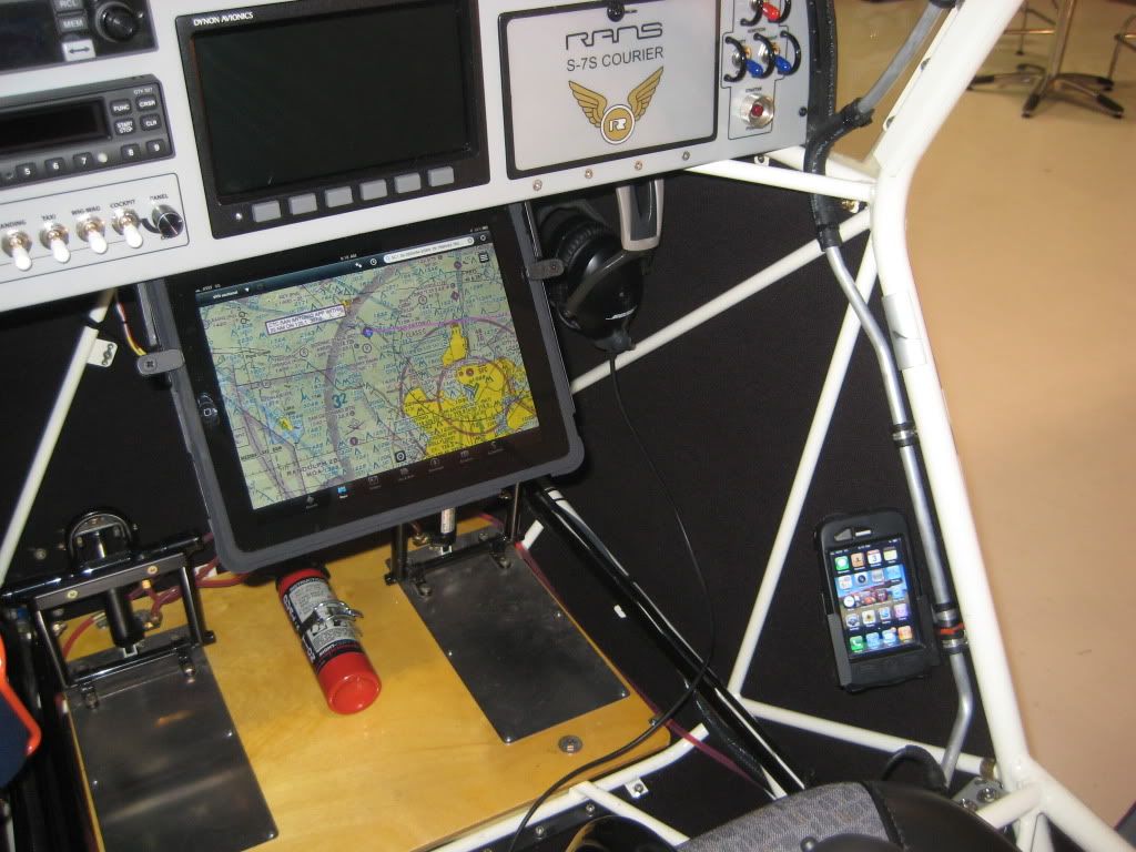

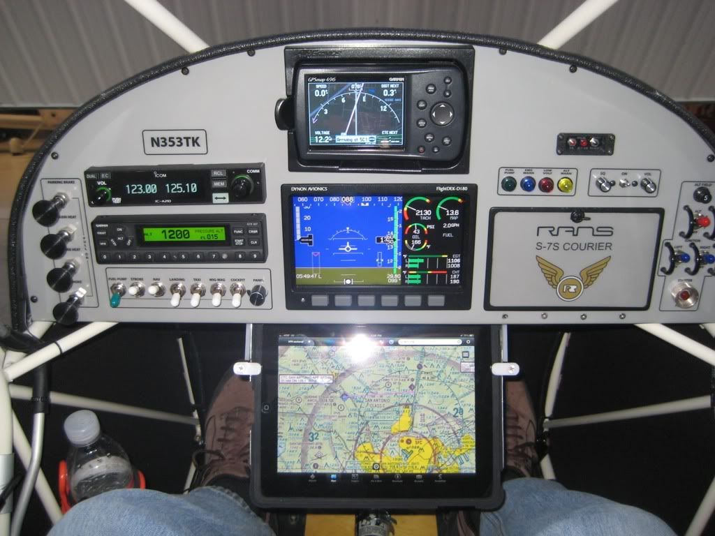

This mount works well for me. I fabricated it with a hinge so I could swing it up and latch it under the panel when I'm not using it...

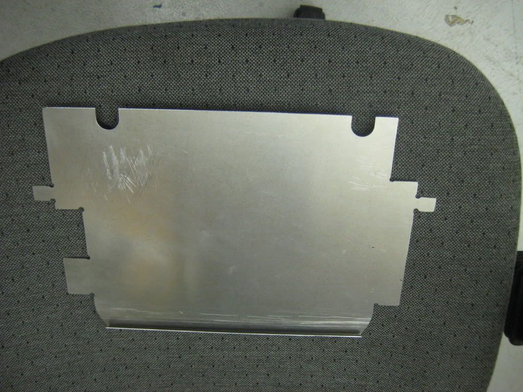

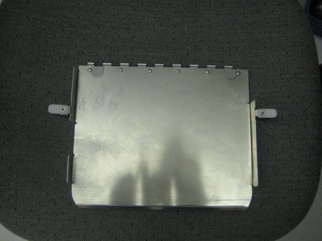

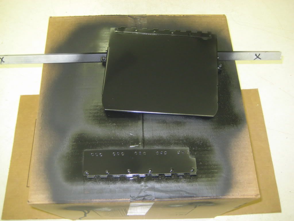

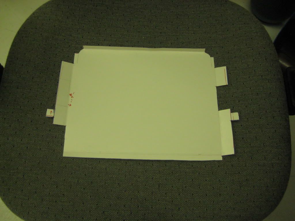

First thing I did was make a cardboard template with the different cutouts necessary to be able to use the different buttons/ plugs on my iPad.
Then I cut out the piece of .050 metal in preparation for bending it. The metal is from the old S-7 instrument panel I didn't use when I built my plane, which is why it has the funny half circle cutouts...
Bent metal...
The separate piece being painted in this pic sets the bracket back behind the panel a bit so I could use short 'arms' from that piece down to the bracket to hold it in the proper position.
Hard to see in the pic, but there are the short arms. They can be unhooked from the bracket to allow it to swing back under the panel and latched in place by two more 'arms' hiding up under the panel.
