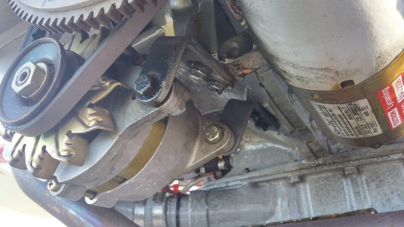

I checked all wires, they're snug now. I tightened the belt a bit, but it wasn't excessively loose. It's grounded through the frame, but I didn't have extra wire to slap a temporary ground on it to check that. I have no noise in my ICS, so I don't know if that's a good indication of a ground.
Had the same initial condition on a ground run: no output until I ran the engine up to about 1500 rpm, then it charged the battery at all rpm.
Here's the alternator in question:
Look familiar to anyone?

It could also be brushes in the alternator. I once had worn brushes that exhibited intermittent symptoms like this. They were worn down, and the springs weren't compressed as much as they should have been. Certain RPM ranges would cause them to lose contact with the commutator.
Complicating the diagnosis was that it was on an O-470 Continental, which turns the alternator backward. On an automotive tester, it checked out good. It turned forward, like it should for automotive, and the change in rotation caused the brushes to dig in a bit, masking the problem!
As others have said, check the ground path. It's often not given enough consideration, particularly from the engine to airframe.

I'll put my money on the brushes. Swap it out for a new or rebuild alternator.
What's TT on the brushes?

~105 hours on the alternator to my knowledge. That's the total time on every other component on the airplane. I'm willing to bet its the brushes as well. George, I'll also be replacing with a plane power, courtesy of Mike. He made me a screaming deal on his and has offered excellent advice for wiring the pigtail and the connectors and crimper that worked best for him. I'm going to order the stuff he recommended this morning!
