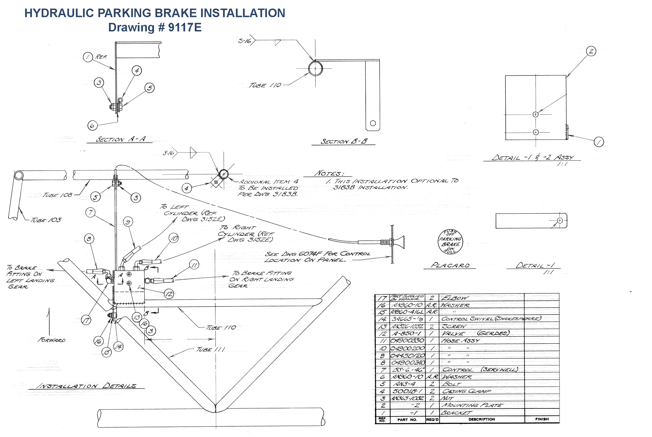

Made the mounting bracket for hydraulic parking brake installation (Maule dwg 9117E). I'll have my friend TIG it onto the fuselage when he does the rear grab handles. I have a MIG setup but welding to my fuselage is still intimidating and above my pay grade so I'll leave it to him. I ordered the valve off ebay a few weeks ago, I think it'll be a solid upgrade from the stock parking brake setup which is a tab that locks onto the shaft of the master cylinder, known for getting stuck in the on position.

Any additional information about the hydraulic parking brake? I have the old metal plate that just binds against the cylinder shaft, so I never use the parking brake. Having a functional unit that doesn't trash the master cylinder in my Maule would be great. Is there a way to install the unit in a flying airplane (i.e. without welding)? Maybe I should direct my question to the factory... :?
Posts: 1002
Re: Amorphous Maule M7/M6 Rebuild Project
Flyhound wrote:Any additional information about the hydraulic parking brake? I have the old metal plate that just binds against the cylinder shaft, so I never use the parking brake. Having a functional unit that doesn't trash the master cylinder in my Maule would be great. Is there a way to install the unit in a flying airplane (i.e. without welding)? Maybe I should direct my question to the factory... :?
The factory isn't a ton of help on this because of how rare this installation is. The drawing is on the parts CD (9117E). The valve itself is used in American champion planes, my scout had one.
I think you could do the installation on a covered plane even with the welding. Or, if your mechanic was loosey goosey, I bet you could make it work with adell clamps but it wouldn't be strictly legal because it doesn't follow the drawing. You could get to the area to weld just by pulling up floorboards, and weld it through there too.
The drawing they give out doesn't have dimensions so I just texted david maule and he texted me a pic of it with dimensions. Gotta love the Maule people.
