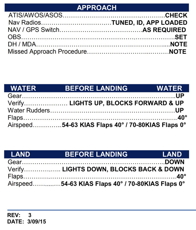

Re: Amphibious Floatplane gear down alight accidentally
Positive rate, gear up
always run flows and follow it up with a check (not do) list
Forget anything or checklist not complete, or THINK you might have forgot something, go around
Every approach is mentally to a go around by default

It’s not that hard to follow a quick checklist, should obviously be done prior to pattern entry. Simple…
Four Blue for the water
Four Green for the runway.

AKJurnee wrote:It’s not that hard to follow a quick checklist, should obviously be done prior to pattern entry. Simple…
In water (salt water?) micro switches we trust?
Posts: 1678
Whips uses proximity sensors, but what evah. Use your mirrors.
