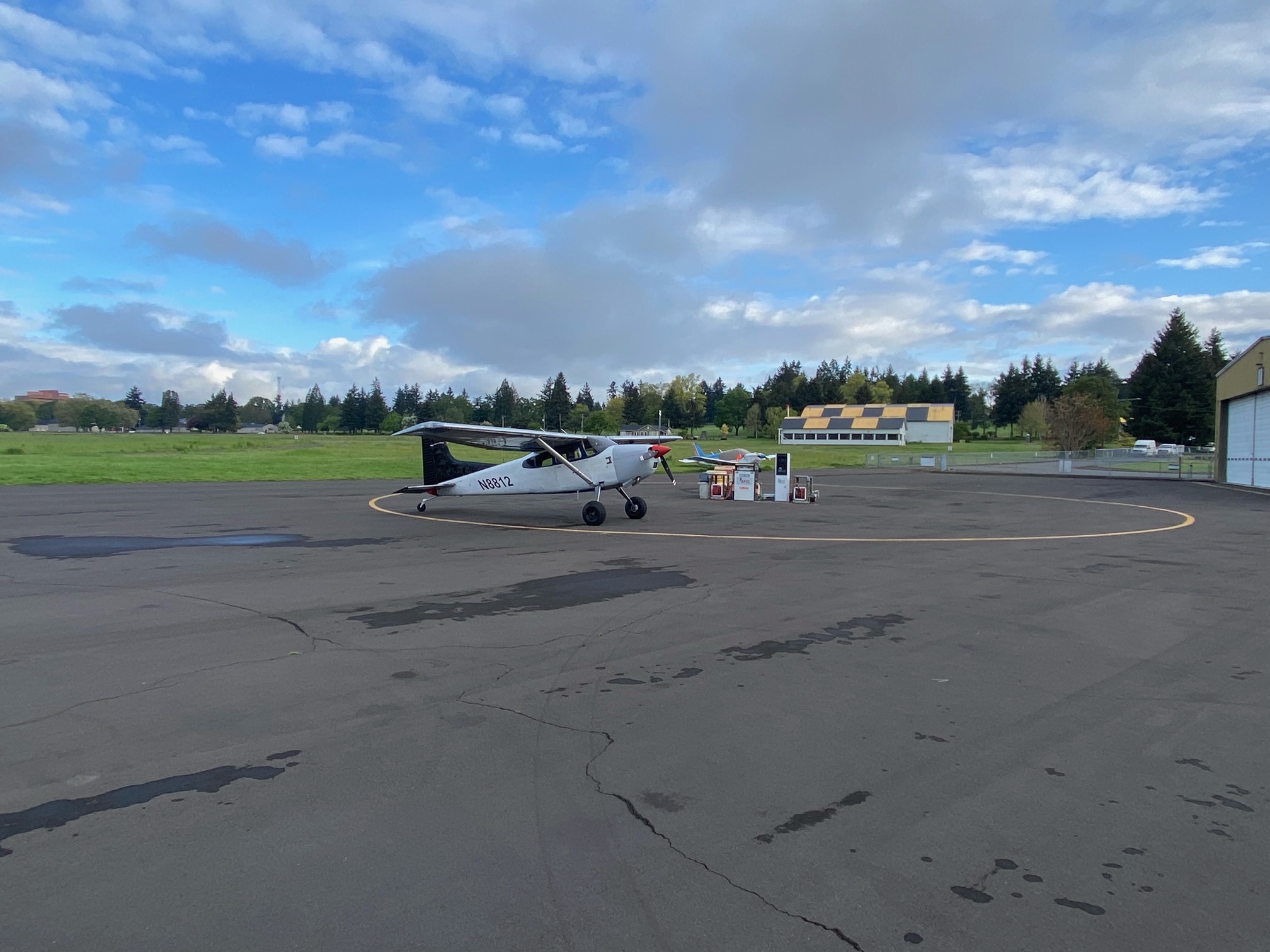

I thought I'd share my Wagon project that just went from project, to flying project last Sunday. The plane hadn't flown in over 20 years. When I got the project, it already had some big improvements and was a good base to start building it up. I didn't know exactly how it was going to look when I finished, but there was plenty to do in the meantime. Besides, they are never really finished. Here's how its shaping up so far.
IO-550D
86" 401 Black Mac
Wing X
Sportsman STOL
Selkirk Carbon Fiber Cowling
10X10 Alaskan Bushwheels
Airglas flat floor extended baggage
F Atlee firewall mount battery box
Quasar Wingtips
AeroLED's
Plane Power 70 Amp Alt
Energizer Starter
Woodward Gov.
Airwolf Remote Oil Filter
206 rear seats
Sport Aircraft Seats
McFarland Flap Trailing Edge Mod
TLGW 10" tailwheel
BAS Pilot and Co-Pilot Harnesses
P-Ponk Beef Up Kit
P-Ponk Rudder and Elevator Bearings
Avion Yokes
Rosen Visors
Sporty's Vents
Garmin Suite
G5
G3X
750xi Nav/Com
200B Com
350C audio panel
GFC 500 (without yaw dampener)
345R transponder

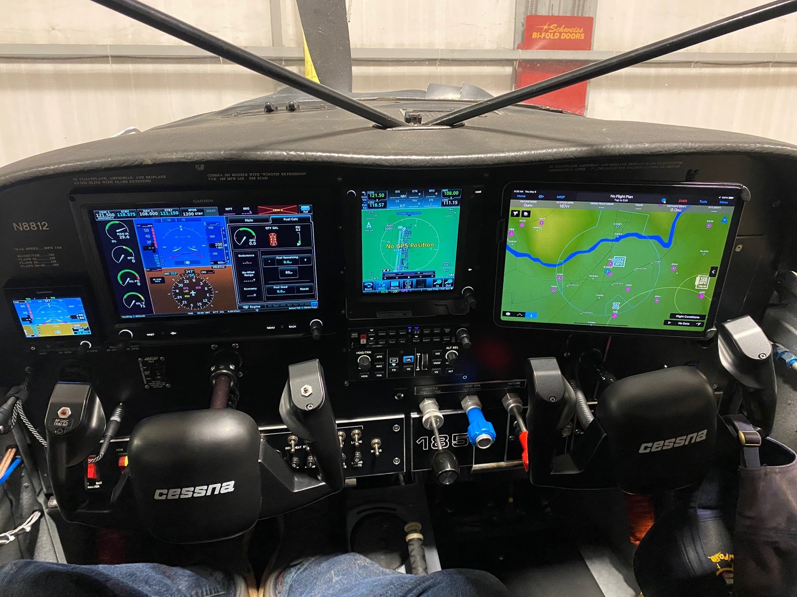

RadioRax Avionics Rails
IPad Pro 11" on a Ram Mount
1 Piece Anodized Panel, Lazer Etched Labels backfilled with white paint
Took about a year of hard work, but the first flight makes it worth it!!!!

Great looking panel and control yokes! Looking forward to seeing more pics. Perhaps some of the seats and interior?

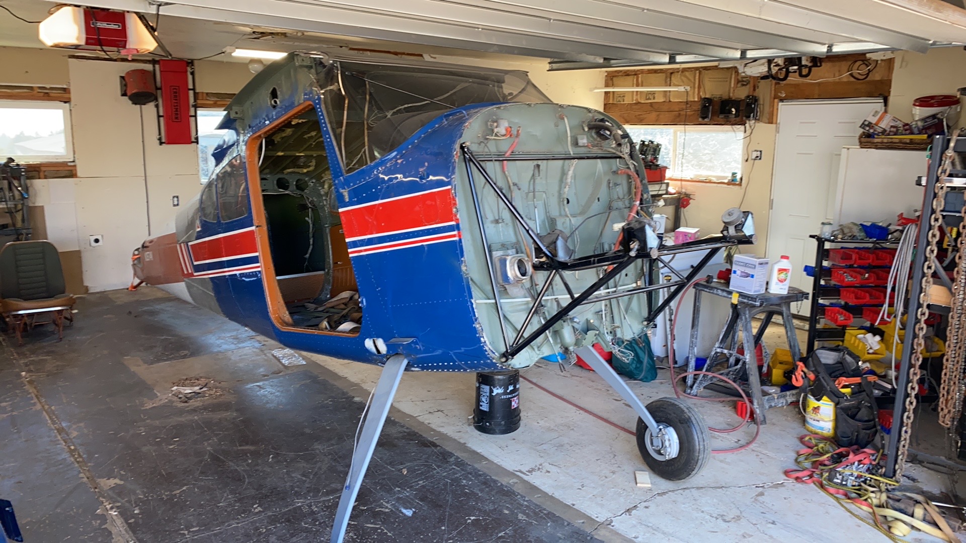

This is how it all started

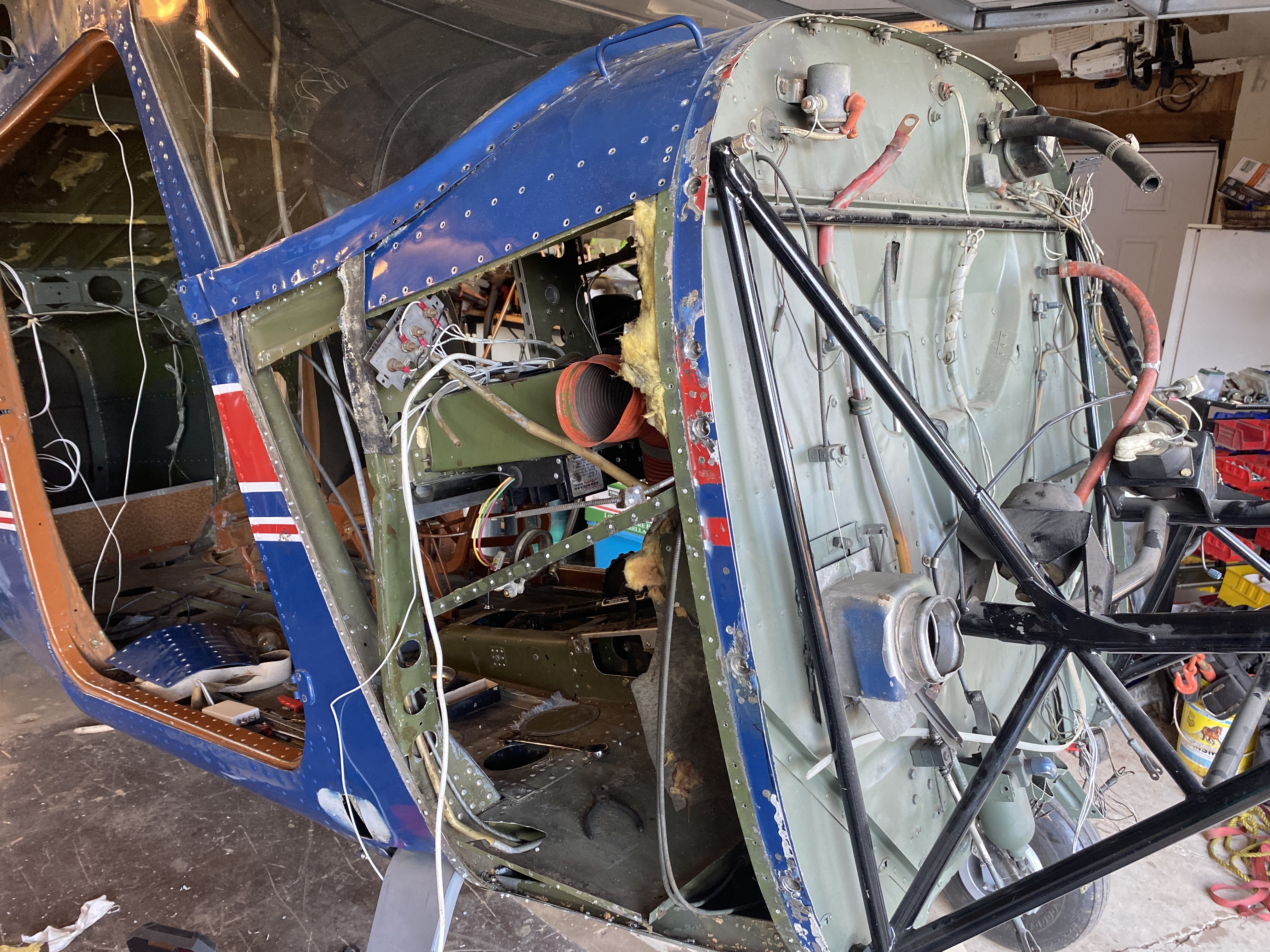

One step at a time!
Had to replace the Port and Starboard boot cowl. Glad I did, found existing damage on the firewall attach perimeter. Mac at Skywagon city was a big help with parts, as well as Global air parts and BAS. eBay did a lot of filling in as well…..the list goes on and on

That panel is a dream.
