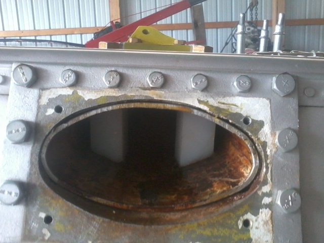

Got my floats "home" to Colorado last summer. Disassembly was interesting - several bolts were severely corroded and will be replaced. The compression wood is rotting. And of course all of my work is overseen, as will the re-assembly and inspection by a certified mechanic with the required log entries. Not today, FAA.
Aqua Floats are now under new ownership. I'm not sure of the implications - but they (Clay?) are working on updated FAA approvals - and I think there is a new compression recommendation that is plastic.

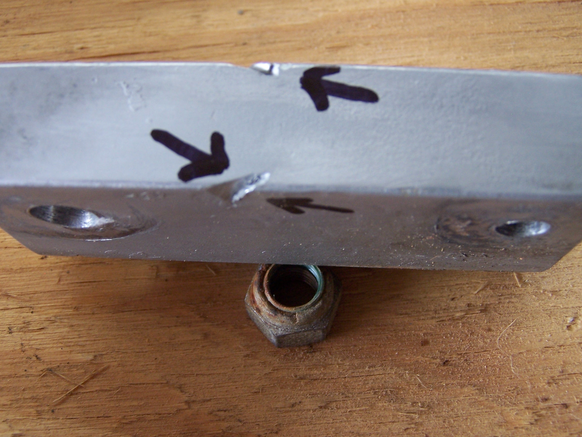

Attached is a photo of my solution to the rotten wood removed from a set of Aqua 180-85 (3190) spreader bars. I coordinated this with Terry and Helen Claggett, owners of Aqua at the time. I used a high-density poly that machines easily and is very similar to the UHMW used on ski bottoms to make a "bushing" for each deck bolt. While you are installing new hardware, inspect those deck fittings and dress any sharp nicks caused by careless hacks with a wrench over the years. Better to remove a small amount of material resulting in a smooth radius rather than leave the sharp dings which may produce stress risers as shown in my photo. I like to NDI all fittings (EDDY Current preferred, FDP acceptable) to ensure I am installing a defect free fitting. Many will call this overkill; however, I call this good maintenance and risk management.
Inspect your tie rods for any bends or nicks as well. It amazes me the condition of tie-rods I see on aircraft floats. Most damage is caused by people using the wrong tool. It is not acceptable to dress nicks in stainless steel tie rods. A damaged tie rod must be replaced.
Have fun with those Aqua's and don't take any grief from others, they are great floats and do exactly as they were designed to do. There are rigging methods to improve your takeoff performance, typically to a detriment to cruise speed. It all depends on your mission. If this piques your curiosity, you can research float to wing chord AOI or shoot me a DM and I can point you in the direction of data.
