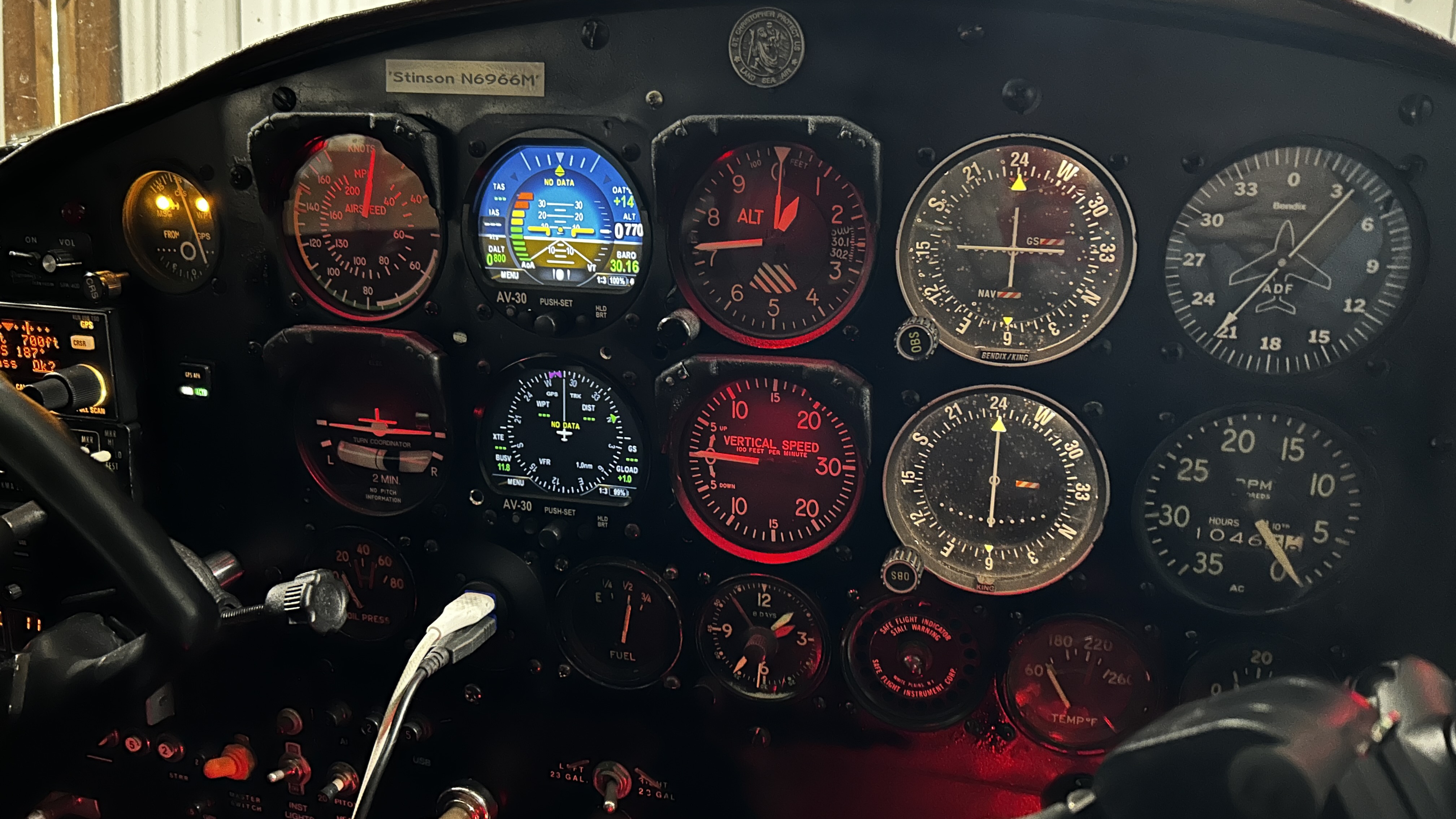

I have two AV-30 C. I was an early adopter. The attitude and other functionality has been superb from day one. Directional gyro function, not so much. But it sounds like you're interested in an attitude gyro and maybe Altitude and Airspeed. Mine works great on that, and no way I'd pay the significant extra $$ for a G-5 that does the same thing.
On the DG function, my airplane has an O-360 Lycoming, which are well known to shake. When I installed the AV-30 in DG mode, I did the vibration test, and it failed. As a result, the DG precesses. uAvionix now has an external magnetometer, which should solve that issue, though it's only approved for EX installations to date. My DG version does have the internal magnetometer, but it's just not enough to deal with the vibration.
I have talked to several folks with the AV-30s installed in planes with six cylinder engines, where the DG function seems to work fine, with the internal magnetometer.
All in all, though, as a primary or secondary attitude gyro, I'd install the AV-30, connect it to pitot and static, set it up so you have attitude/Airspeed/altitude and enjoy.

I'm leaning toward two AV-30's in my '55 wagon, the price is right and install looks relatively simple.
