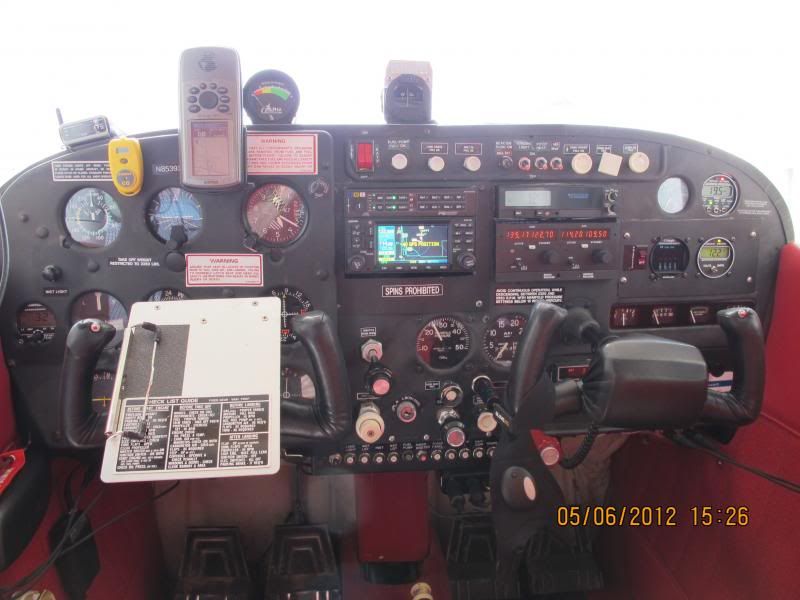

FWIW, in my '63 P172D I have a 430W, a Narco nav/com, a PS Engineering audio panel into which I plug in an XM portable tunes radio, a Garmin 96C handheld, a Narco transponder, and a King ADF. I have a basic Zaon traffic indicator, which as far as I'm concerned, only raises my adrenalin, because it doesn't tell me where traffic is, only that's it's nearby--and it also sends out RF on some of the com frequencies at times causing static when running on "ship's power", but OK on batteries--not a very good purchase.
My airplane is in for its annual now, and the only addition I've asked me IA to install for this year is a new SIRS compass to replace the old Airpath--from what others have said here, it's a much better compass. I'm also replacing the yoke board with one that holds an iPad Mini, which I plan to use not so much for navigation but for weather enroute with a Stratus as well as flight planning.
I also have an Artex ME406 installed, and I carry an ARC PLB as well.
Not that my set-up is the best, but it works for me.

I was sticking to the avionics/radios stuff in my response, but notice on my panel shots that I have an Insight G1 engine analyzer and an EI FP-5L fuel flow meter.
The EI is amazingly accurate--if it says I need to refill with 35 gallons, I'll usually refill with just about 34 1/2, for instance. With it connected to my 430W, it also tells me my mileage (not so sure I want to know that, though :)). Knowing how much fuel I have left is very reassuring, and the only thing that's necessary is to make sure that the tanks are full to start with and the gauge is reset when refueled. Of course, it's entirely possible to only partially refuel, because any amount can be plugged into the gauge, but I think it is a good idea to periodically fully refill the tanks, to eliminate any accumulated error.
The G1 is nice, because it changes colors from green to yellow to red when temps get too high, so that any trend can be seen at a glance, and it also shows the actual temp in F degrees. It also shows my carb temp in F degrees. It shows the peak of each cylinder, which makes leaning a snap.
