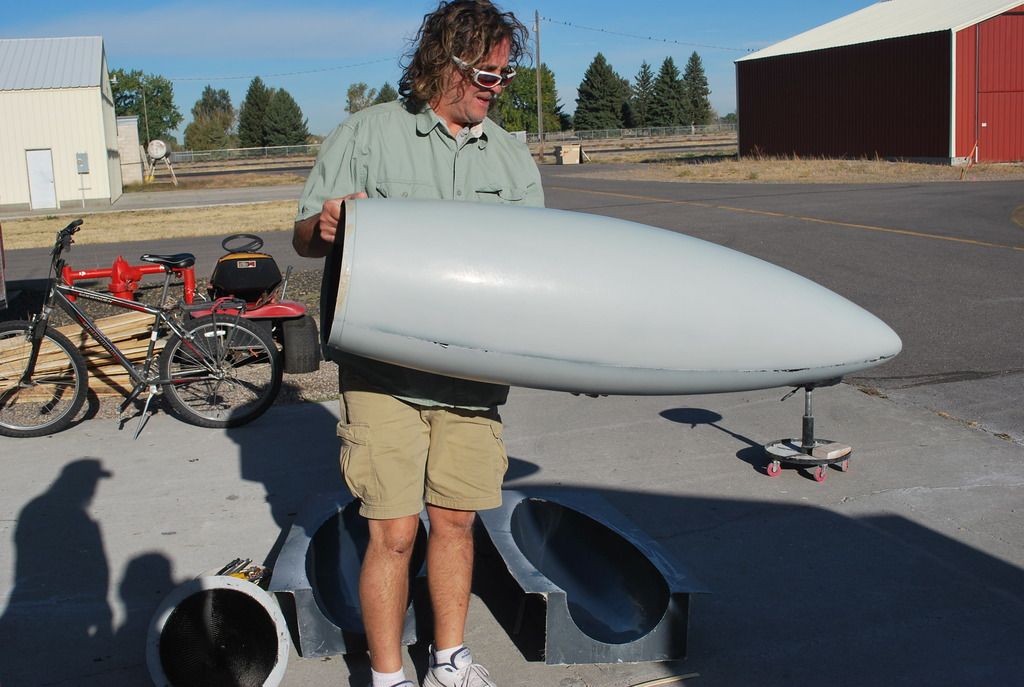

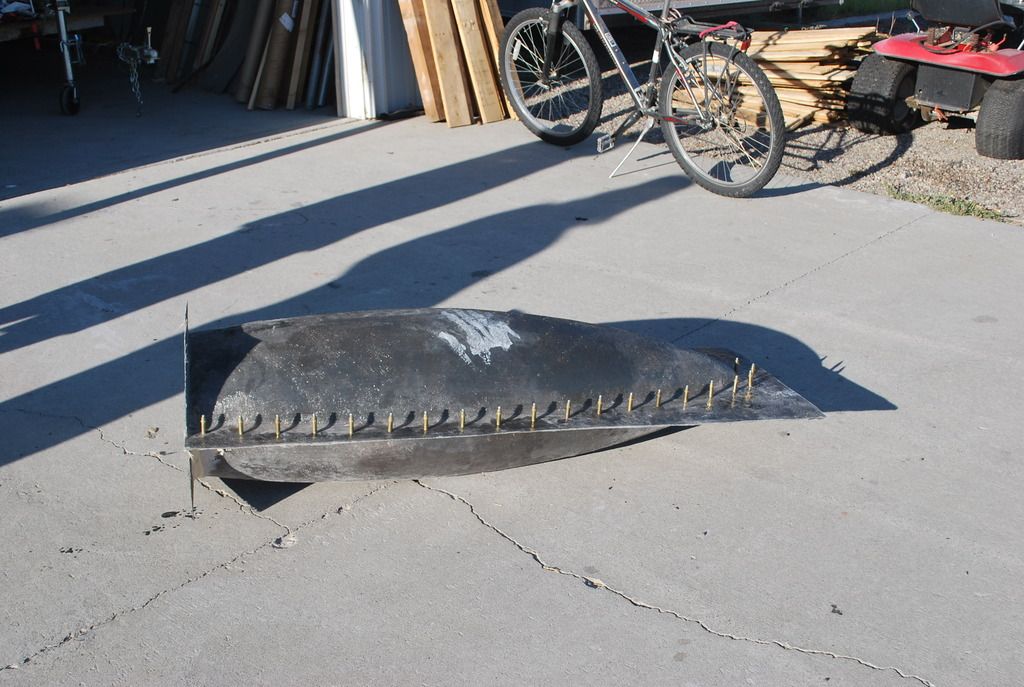

The first carbon ones coming out of the mold.
Image[URL=http://s649.photobucket.com/user/simkot/media/PODS2%20010_zpsbt0dlnoo.jpg.html]ImageImage[/URL]
After researching the formula for finding the volume of a ellipsoid, I said screw that, and simply filled them with water. 32.5 gallons, (counting the nose cone)each. That's 7507 cubic inches, each
