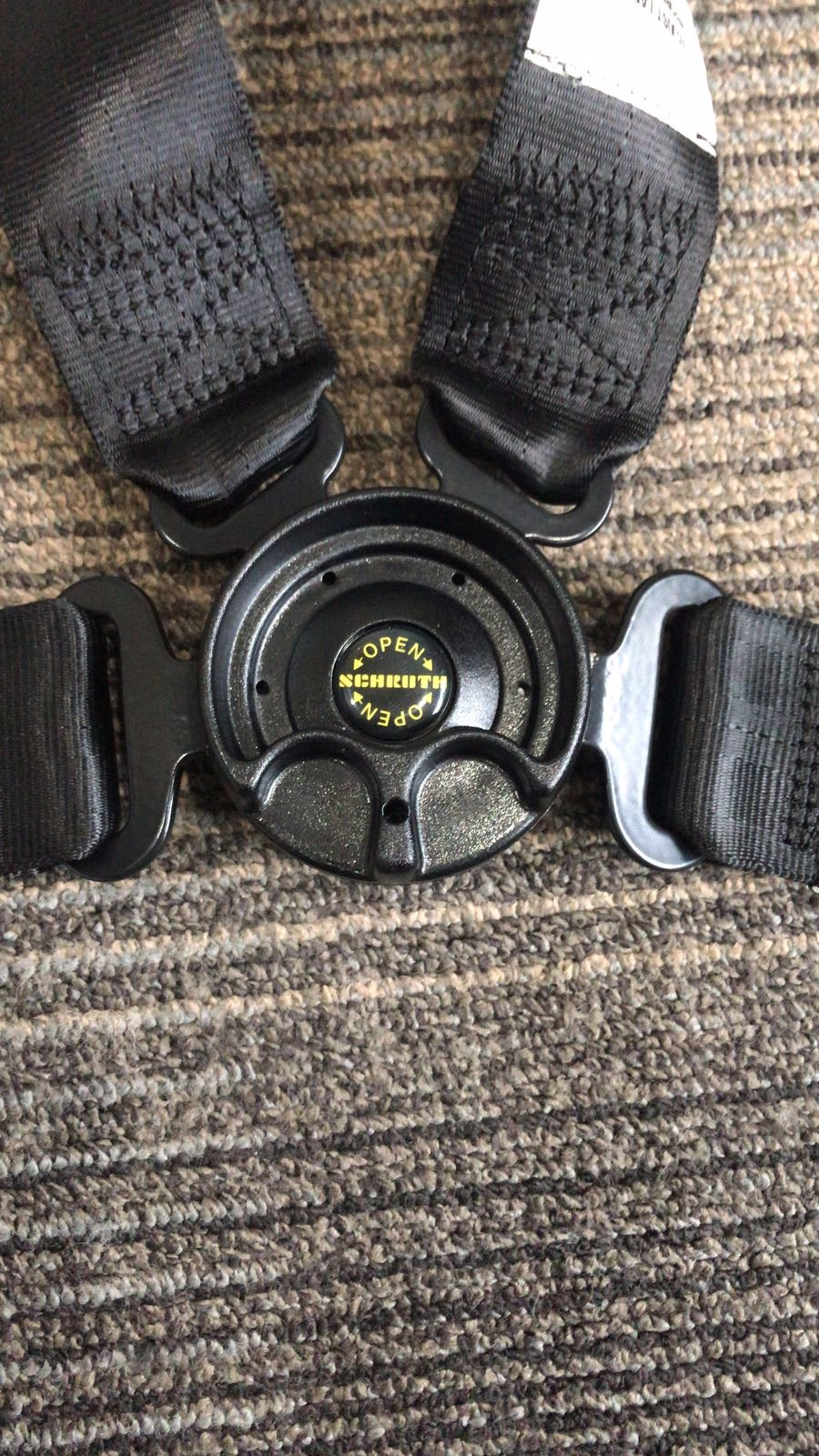

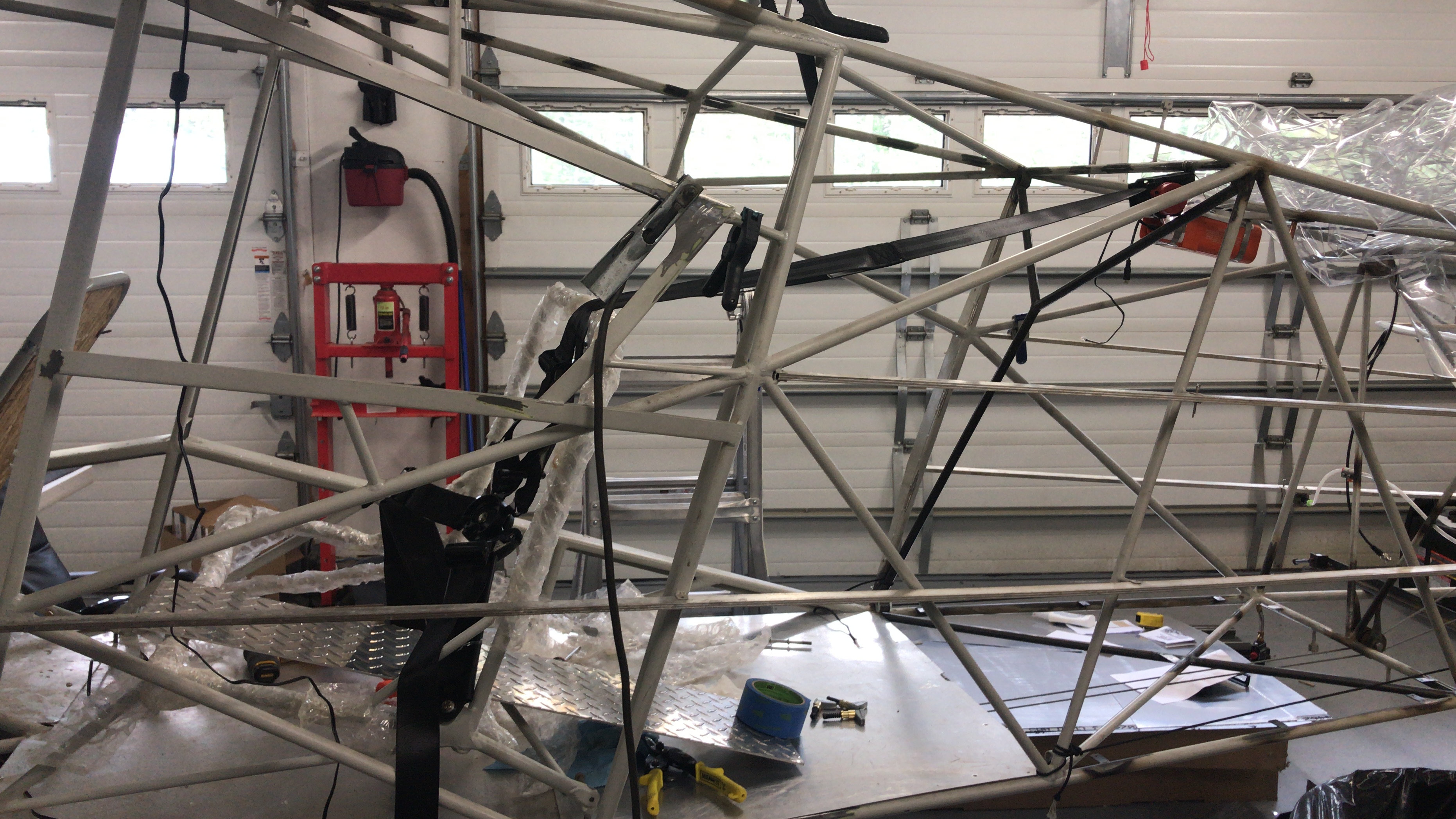

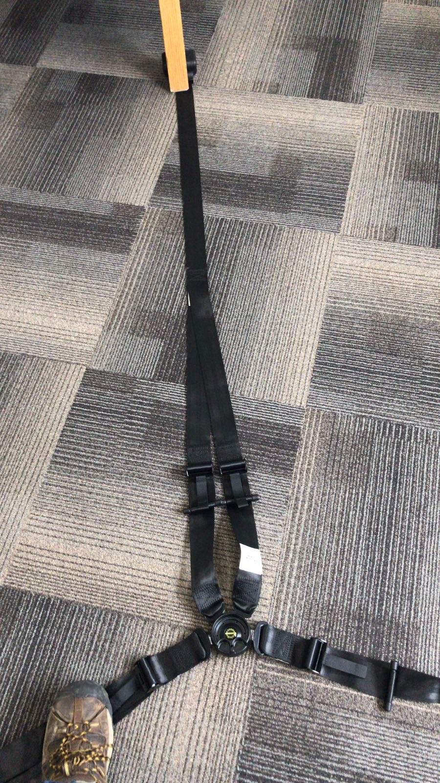

Okay, got the front seats figured out. I bought some NOS military 4-pt harnesses from ebay. They are made by Schroth the same people that make amsafe. The harnesses are very good quality, and they were cheap. I attached a picture of what they look like.
So now a new decision. Rear seat belts. The plans call for lap belts attached to the rear seat, which is pretty common, but I can order two more of those 4-pt setups and put them in. It will require more welding of the shoulder harness mounts to the frame, and obviously more weight, but I suppose I can pull them out with the seat.
So what would you all think? Put lap belts in? Or build harnesses?

I think if I had an opportunity to put harnesses in everywhere, and they didn’t interfere with the use of the back with seats removed, I’d say yes. I must say, though, that I do appreciate the 3-point system in my Maule back seat because they don’t get in the way when retracted and the back seat is removed.
Maybe fashion some sort of clip or similar to hold the belts out of the way like in my Suburban when the back seat is out.

I’m going to hut 4 point belts in my back seats. 90% of my flying will be with my kids and I need as much help as possible to keep the safe. Current plan is the use fixed harnesses that wrap around a upper airframe tube like used on some Pipers.

Decision made.... I'm going to install rear seatbelts. The ones I found on ebay fit fine, so I ordered two more.
https://www.ebay.com/itm/Schroth-Milita ... 2162965992
