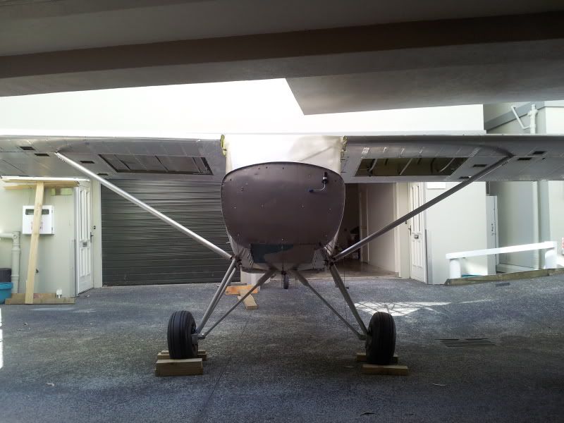

Re: Big Foot Bearhawk
That front-on view probably costs me some $4k hot sause in the near future.......
Damn you! =D>
Battson wrote:That front-on view probably costs me some $4k hot sause in the near future.......
Damn you! =D>
Welcome to the club! #-o
