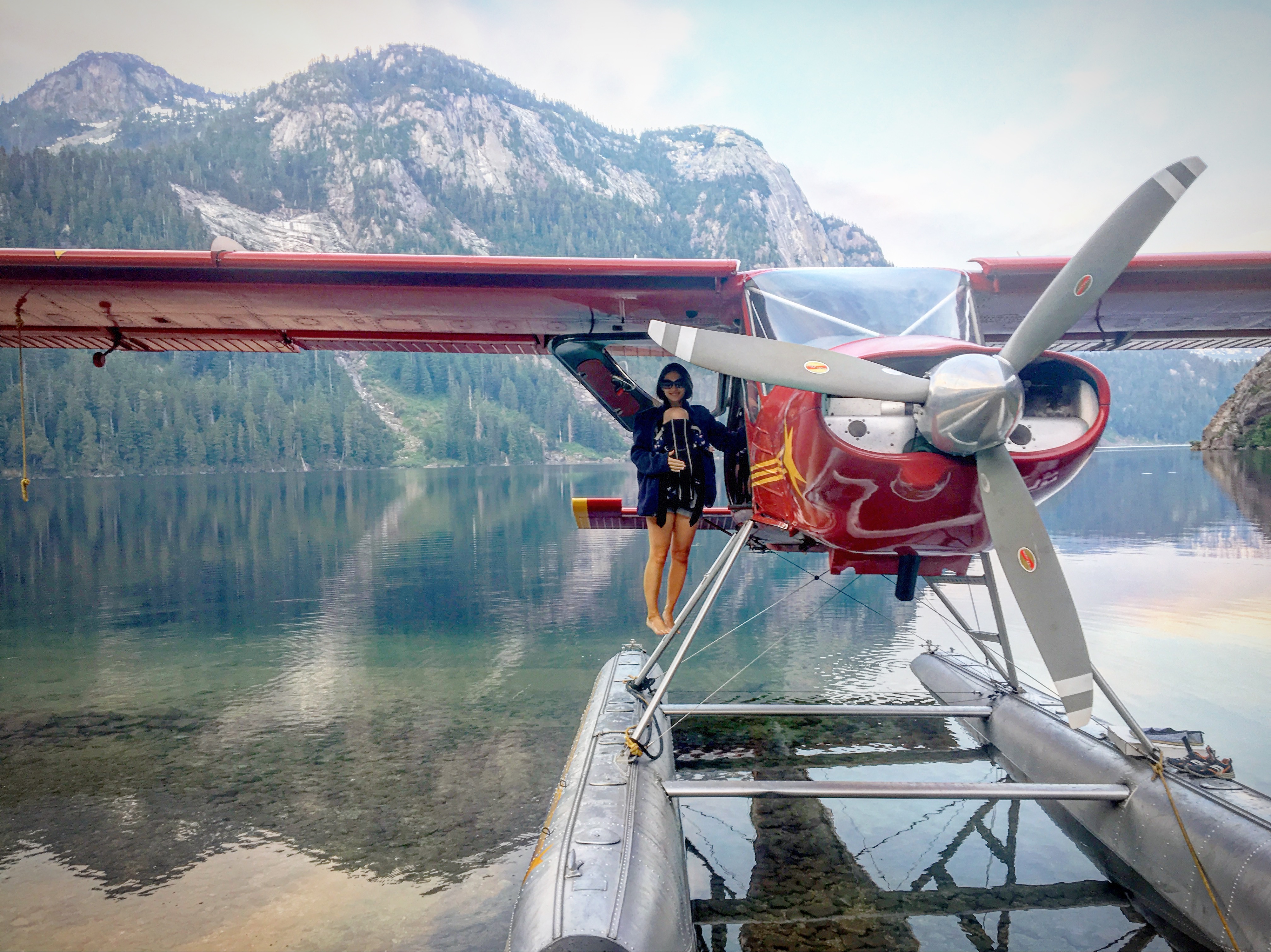

I’m awfully late. Operated a Wilga 2000 (modernized, 300hp Lycoming powered variant) for a good while supporting my mountain hunting outfit.
It is the near perfect bush plane, but room for long pilots isn’t amongst its selling features. The spar runs through the top of the cabin under the headliner, and being a strutless eastern euro design it’s a rather prominently constructed example of a spar. Anyone over 5’10 will bump their head on it lots as it’s right where you want your noggin. In the daily gripes category was my biggest misgiving with the aircraft after the fuel caps.
Overall, it outperformed my 185F in everything but cruise speed. In that, it falls short by a large margin. But to lift a Herculean load out of a small lake, there isn’t a more impressive 300hp class machine. Or one with better handling and visibility. Roomy though, I wouldn’t call it that.

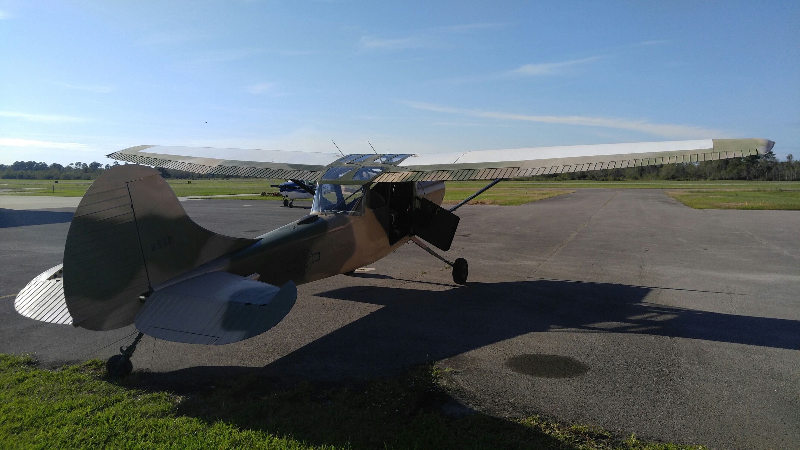

I've owned my Birddog for about 5 years. It's got a very roomy tandem cockpit. I'd go sit, or preferably fly, any plane you're thinking about. And try getting into the back seat of each too.
Regarding the scout, I used to own a citabria. Isn't the fuselage the same for the scout? If it is, I'd have to say the birddog is roomier.
There's even a decent amount of storage behind the rear seat. For easy access, I just pull the back of rear seat out and then slide bigger items back across the seat bottom. I can also open one of the rear windows and slide bags through there and into the baggage area. The windows on either side of the pilot open out. The windows on either side a back seater open in. There's also non-opening windows all over the place so the visibility from both seats is fantastic.
My plane has the stock O-470 and a fixed pitch prop. It's a fantastic engine, super smooth and easy to start hot or cold. It's basically the same engine that was used in the early Bonanza's, Navions and T34's - Continental E-Series. My is rated for 213HP for 5 minutes and 190HP continuous. My prop was bent for cruise so I can tool along at about 115MPH burning 8 gallons an hour. Useful load is 702lbs. So with full fuel, 42 gallons, I've got 450lbs left for me, a passenger and stuff.
The only knock against the birddog is that they aren't the most user friendly aircraft ever made. The vertical fin and rudder are a bit too small. The last version used the much larger vertical fine and rudder from the Cessna 185 to help with the ground handling.
As far as I know, there aren't any AD's for the Birddogs.
One last thing, don't underestimate the value of an all metal airplane. I've owned four fabric airplanes. I still have one, a Stearman. Yes, fabric is easy to repair but its also easier to damage.
