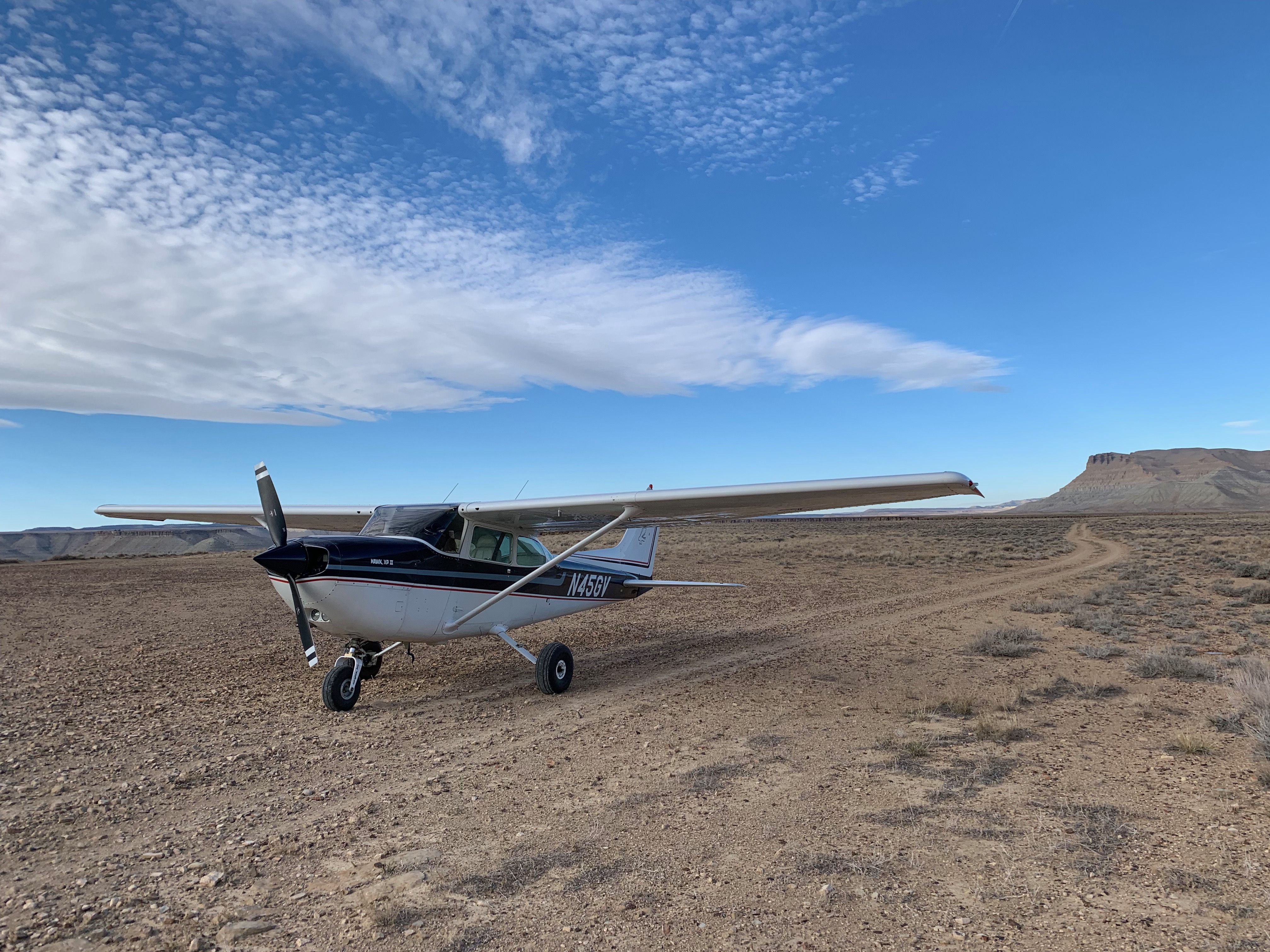

I realize this is an older post but for those searching for similar information on the STC for R172K Hawk XP's here's what I just posted on the HD Fork Article: https://backcountrypilot.org/knowledge- ... wheel-fork
I wanted to add to the information if you have an R172K Hawk XP as I do. I was able to obtain a field approval for the install of this STC on my aircraft w/o any issue since my model was not on the AML. The folks at Airglas were super helpful and provided all the documentation needed for my 337 Field approval. The install went without an issue except for my original tire combination of 8.50's on the main and 8.00 on the nose. With this tire configuration, the tail cone was only about 12" from the ground with the strut fully extended..which was a little too close for my comfort. I opted to install a 6.00 on the nose (actually one of my newer main tires) and the set-up has been working great in the backcountry (mostly Utah desert strips).
When I reviewed the issue a little closer I realized that my main gear sits lower to the ground than older "spring" gear thus causing the difference. One of the options that Airglas recommends is to install the AB 10" main wheels STC and 29"s on the mains (think Peterson KING KATMAI except on a 172) then the 8.00 would be fine on the front fork. I kept the 8.00 just in case I decide to go that route someday.
