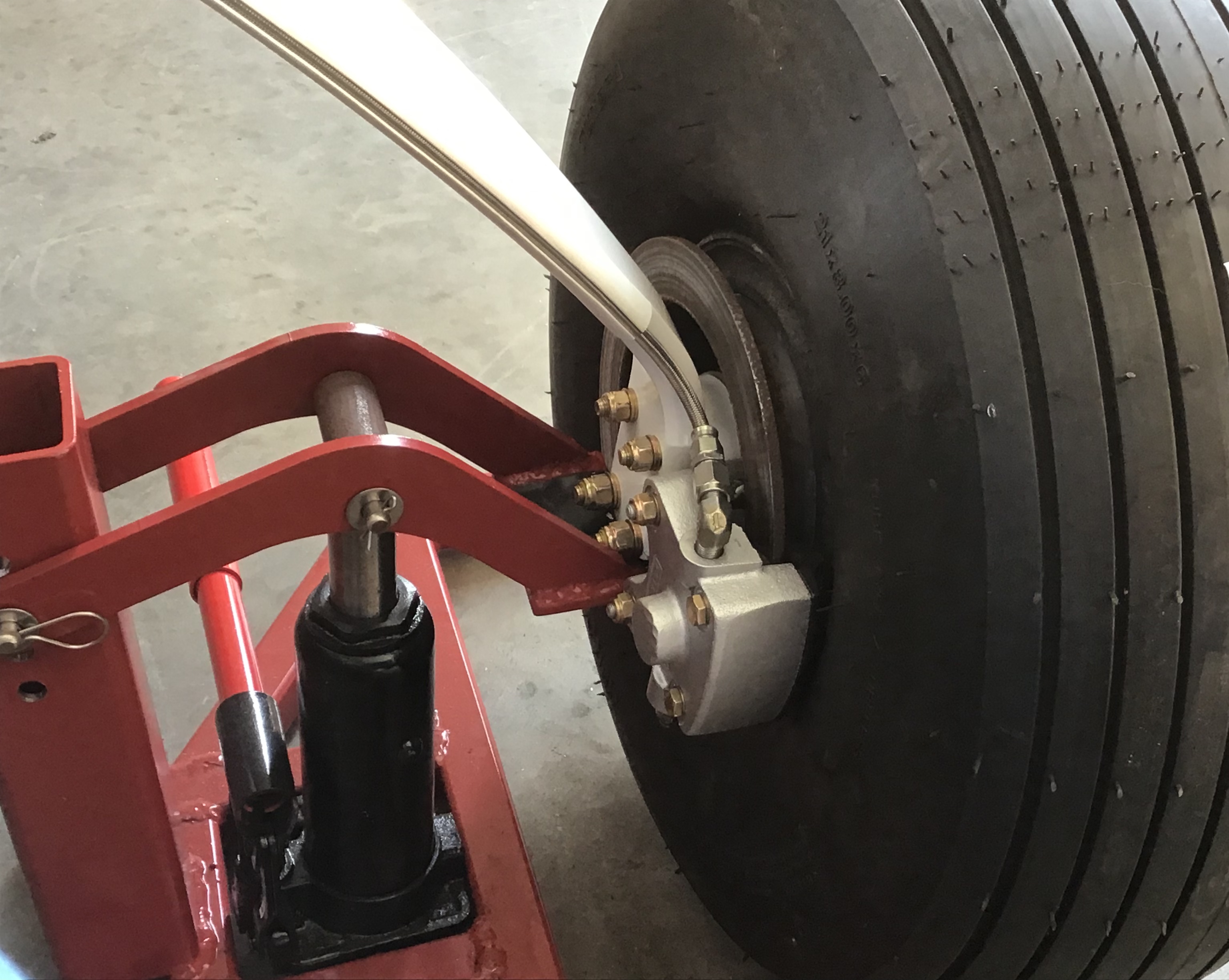

Seems like the ways I've used to jack up the airplane -- jack point or choker on gear leg -- wouldnt work with the brake lines faired in as per Ryans photos.
You'd have to jack it up up at the wing or hoist it by lifting eyes or the engine mount.

Just 2 metal plates with rubber glued on them and 2 bolts. Suck the 2 plates together with the bolts and it won't go anywhere. Works great for many different sizes of hear legs and thicknesses.

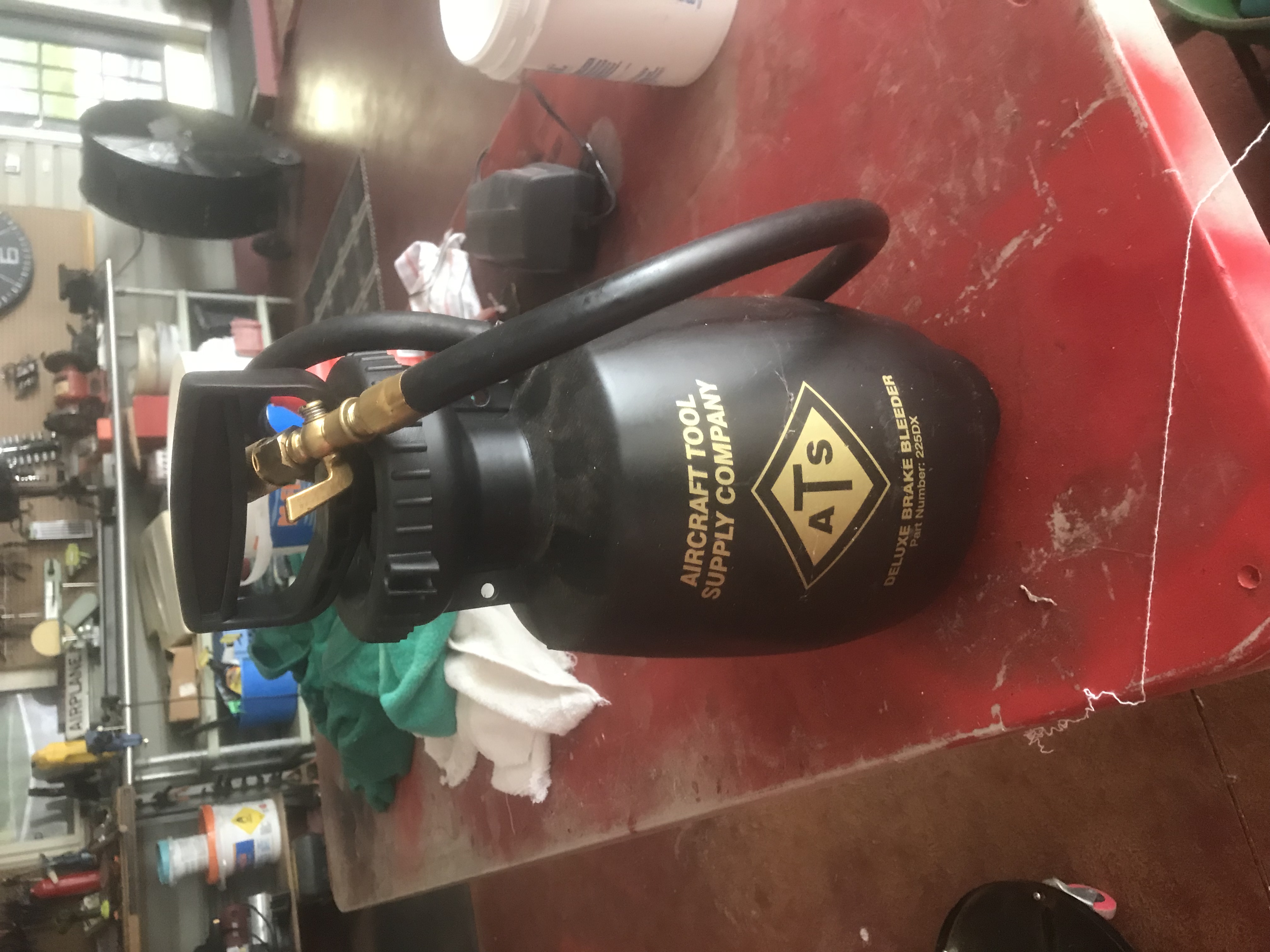

I use one of these, from the bargain bin at Napa.
Works better & less hassle than a friend of mine's spendy shop-air-powered bleeder.
Same here, plus a turkey baster to suck out any excess in the reservoir.
Re: Brake line mods
Here’s how I did it.

Re: Brake line mods
Is that one of those Vern Goodsell / Landing Gear Works jacks?
Those look pretty nice, unfortunately for my budget they're a bit spendy for a one-trick pony.

Re: Brake line mods
Maxie wrote:Here’s how I did it.
That’s exactly what I think I will do. I have heard some say that a full length flex line can give a spongy feel, but I am confident modern lines are fine. I think it’s the neatest solution.
