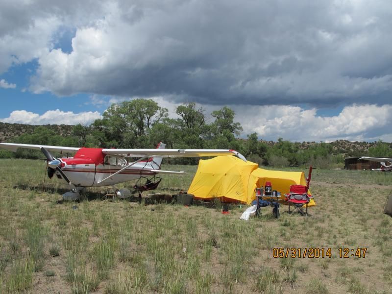

I'm assuming that you won't think mine looks back-country-ish enough, even with the droopy tips:
Oh well, as the pic shows, it still gets in and out of the less strenuous back country places. This was at La Garita last May.
Re: Build a BC Cessna 172
