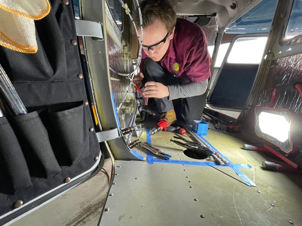

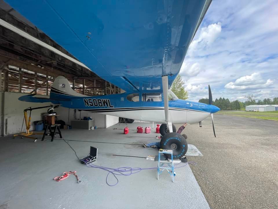

Got a field approval and the battery was moved one station backwards, (great idea MTV or whoever gave it to me here) installed Selkrik extended baggage compartment, Atlee Dodge seats, and an AV30, (want a second one) a T3, new baby bushwheel tyre.
Did the weight and balance, my plane is heavy for a 170B, 1,5111 lbs has 182 articulating seats, (very heavy, but comfortable) extended fuel tanks (DelAir) 180Lyc, and constant speed, 31inch Alaskan heavy duty tires, it was nose heavy, so I was flying with 70 pounds of ballast in the cargo area. CG was at 38.5 even with the ballast, now is at 41.9, in the sweet spot and removed 70 pounds of ballast.
Definitely can tell the difference, I am floating a bit on landings, and when I add that bit of power to arrest sink before touch down, it does not touch down, but flies again, so I am re learning the plane a bit. :D need to add less power and slow it down a bit.
Slow flight level flight, ASI way below 40, GS 39mph, did a 180 flew the opposite track groundspeed 42mph.
It is heavy but performs great.
