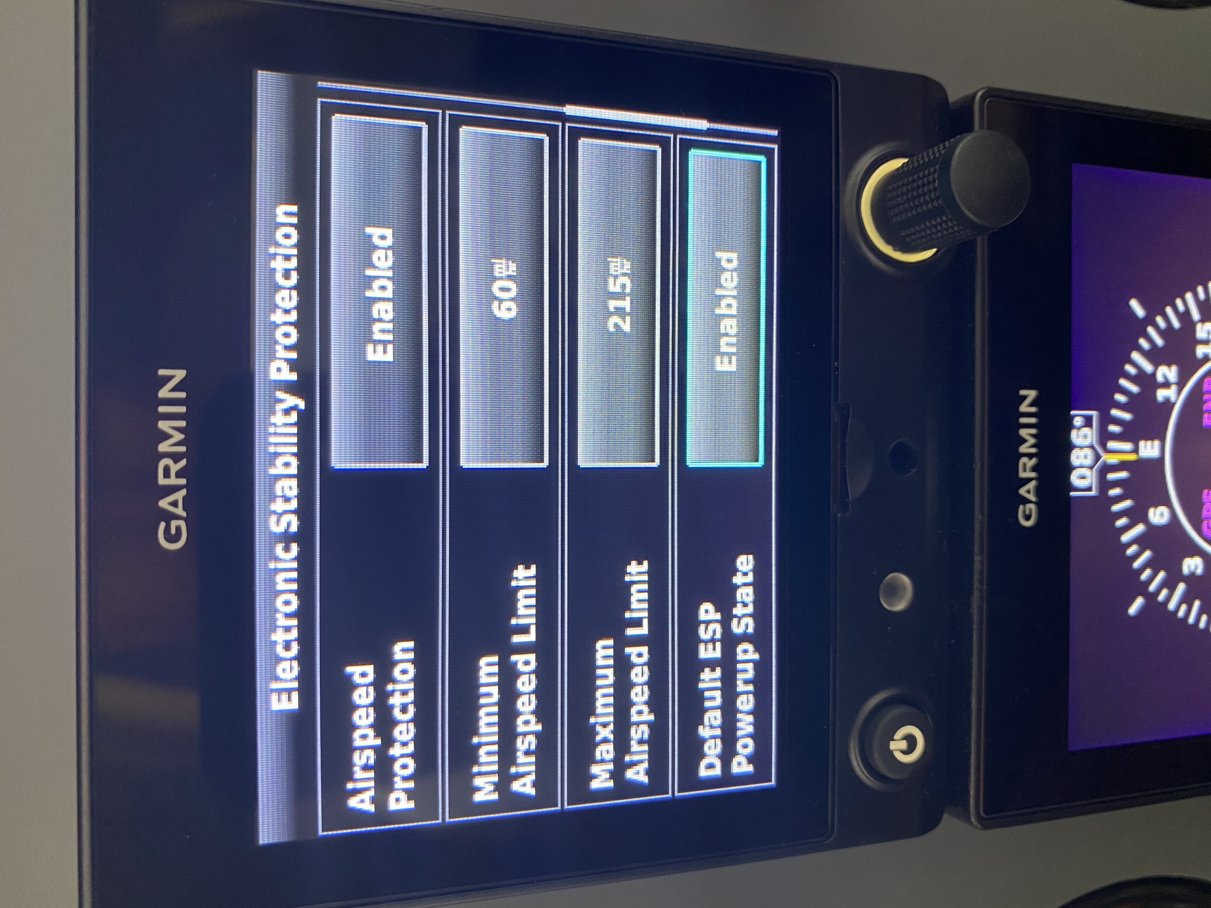

I recently updated my panel on my C180. I had an old S-TEC 50 that needed some servo work. I elected to spend the money on the GFC-500 upgrade. I would have to look at the paperwork but I believe it added 50 hours of labor in cost. The GFC-500 as others have mentioned is just an outstanding unit and is very user friendly. IAS climbs, pre-select altitudes, Vnav/VS descents and easy to use approach modes. It integrates perfectly with my GTN650xi. It saved a fair amount of weight - the servos on the Garmin unit only weigh 1.4 lbs. There is some beeping for reminders regarding altitude and if the unit is on/off but for trim reminders there are bright yellow alerts seen on the G5 that tell you which way to move the trim wheel. I think the cheaper cost for the other units mentioned is due to not needing an authorized Garmin dealer to do the installation. My mechanical skills are not one of my strengths and avionics work just seems too technical and complicated for me to even consider. I think if you are someone who can do the avionics work consider the cheaper options but if you are going to be paying a shop to do the work the extra cost of the GFC-500 will be worth it. I have no regrets.
The only other thing worth mentioning about the GFC 500 is the ESP feature (Electronic Stability Protection). This is a "safety" feature added that prevents the plane from entering any unusual pitch or attitude change. It activates at 500 feet AGL even if the autopilot is off and will not disarm until below 200 feet AGL. I have to manually deactivate it prior to every engine start. Not a big deal but definitely added to the checklist. It will not let me fly an approach lower than 75 mph.

75mph??? Is that adjustable?

The ESP activates due extremes of pitch and bank changes. I do not know the exact settings but they are preset by Garmin. Not sure how much nose up pitch is required but for me with my power setting low it usually activates at 75 mph. I believe the bank angle is around 45 degrees. When I first picked up the airplane from the shop nobody warned me about the ESP. I flew it back home and on the final approach found myself fighting with the AP until 200 feet AGL. It can be overpowered when the AP is turned off but I believe it reactivates after 10 seconds. I read up on the ESP after that first flight and deactivate it before takeoff now. It is also on my landing checklist. It has no place for backcountry or STOL operations. It is probably great for pavement pounding faster airplanes flying IFR flight plans.

I deactivate the ESP on all VFR flights. It can be permanently disarmed if one likes. Too good of a feature to totally disregard in my opinion. One just simply understand they systems on their aircraft and utilize them to max extent possible.

Can you tell me how to permanently disarm it? I have read through the manuals and have not found a source.

Immediatley powering up the G-5 hold the knob in. This will bring you to the configuration menu. Scroll down to ESP, enter that menu and scroll to the selection you would like.

Thanks MW - I see I can adjust the speeds too. I thought it was a factory setting for pitch. I am guessing they set it at 75 mph. I will have to play with it now - but I probably will just turn it off.
