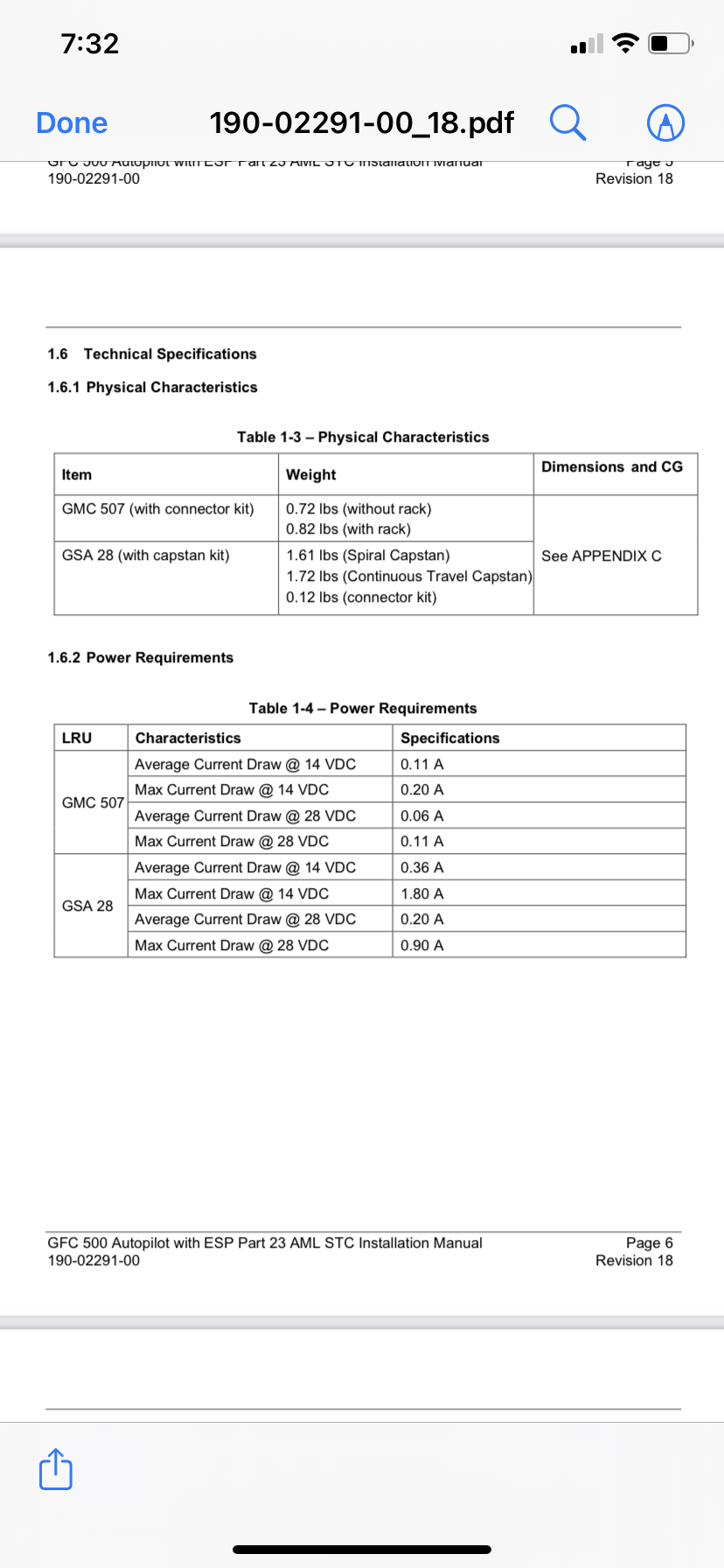

What’s the YD kit weigh?
Posts: 1679
Re: C185 Autopilot
Not much.
