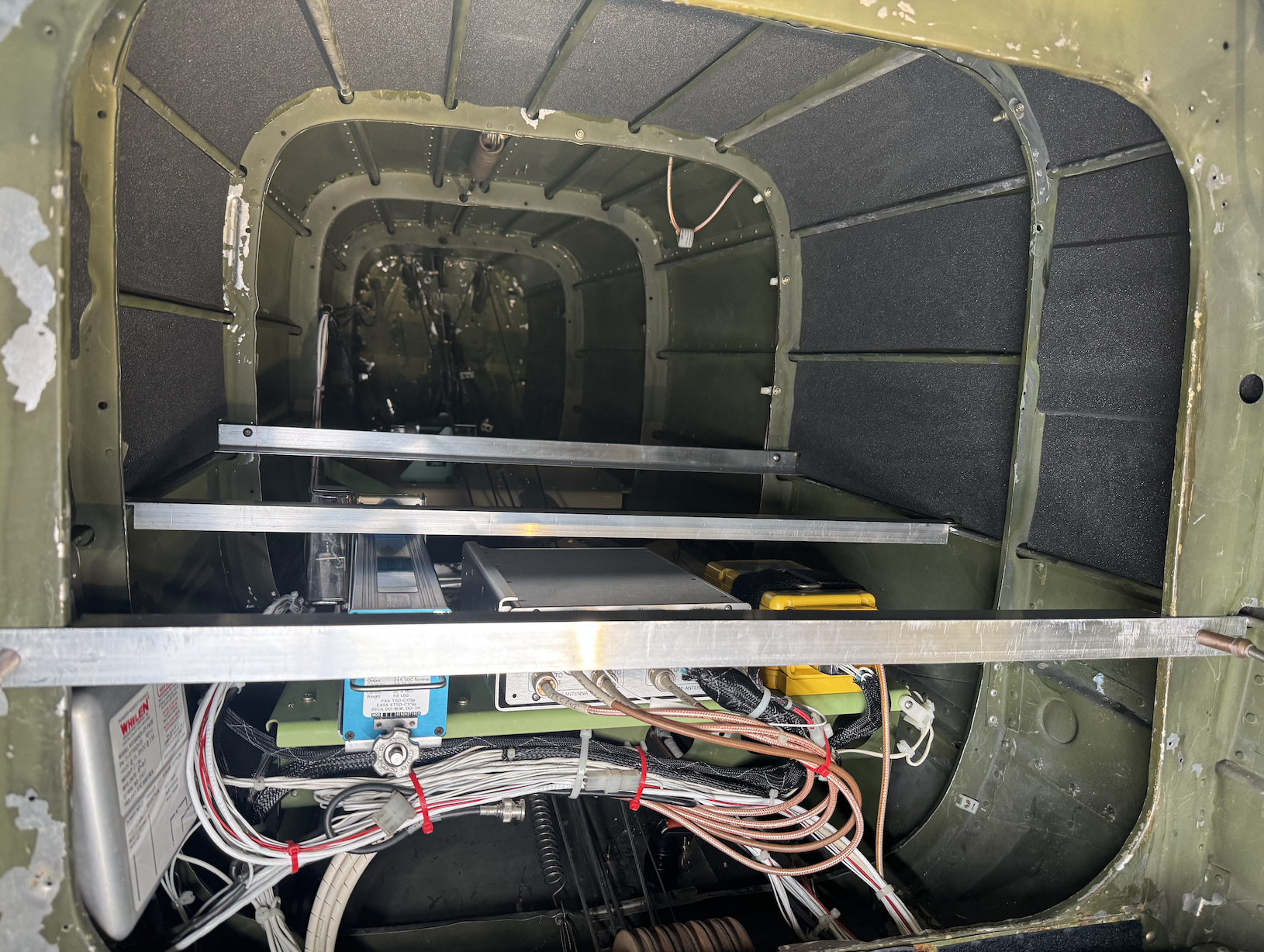

Looking in the back of my 206. Im wondering why no company ever made an extended baggage option? the book lists a 36 lb O2 bottle back there. i'm sure the air conditioner weight is similar. Why not fabricate a tray above the avionics stack. and gain a bit of extra storage for a cover, first aid and some tools.
Anyone have any thoughts? Id really like to fabricate something like this, however it would have to be removable to maintenance.

I recently removed everything from that radio shelf, I have the oxygen bottle in the way though. I had the same question, I have to imagine it has to do with the radio shelf and the fact that a 206 can be easily loaded to the aft CG without much trouble as is. But that's purely a guess on my part.

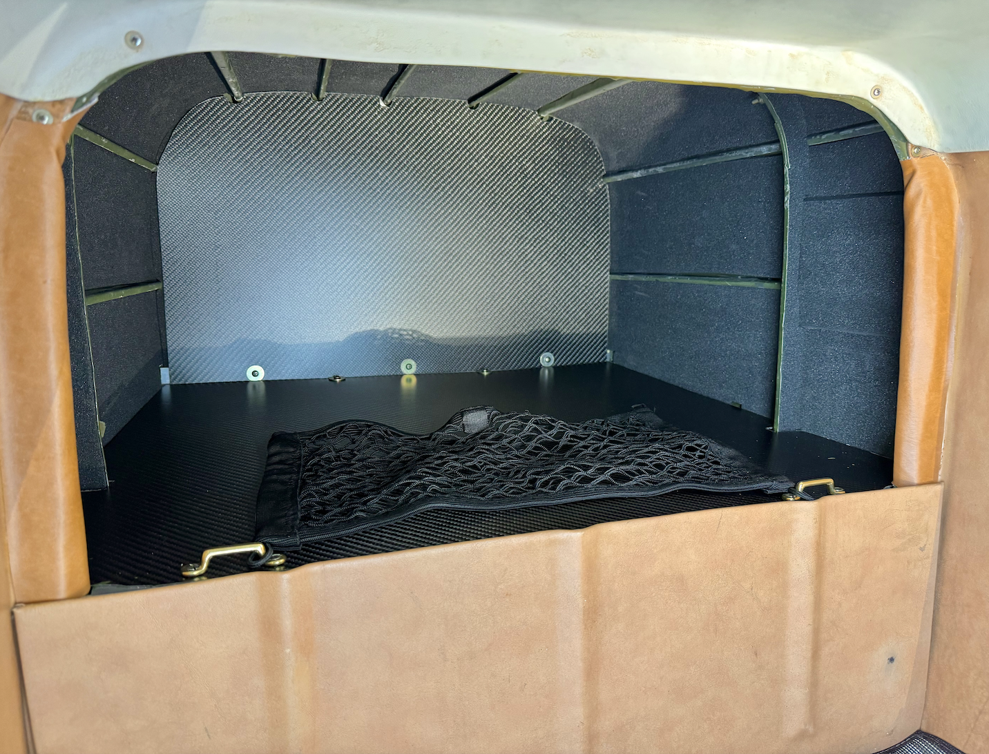

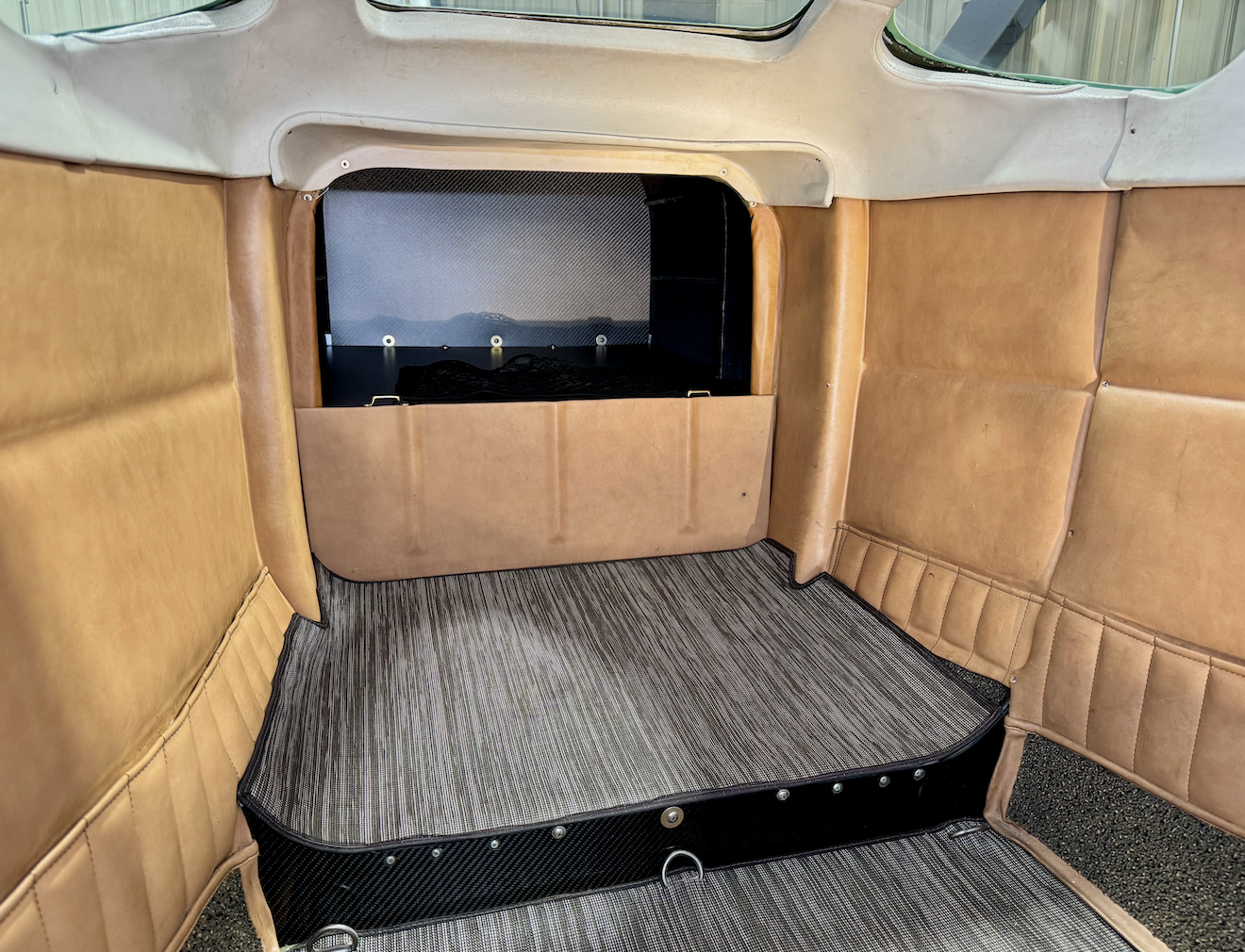

Finally got round to this project, added about 1lb after all deleted. Involved 3 6061 angles, ensolite insulation, carbon composite board. and lots of time!

another view

This looks awesome. You did a great job!
I have looked into a similar mod for my 205. According to this thread:
https://backcountrypilot.org/forum/cess ... date-16571
there appears to be a guy out of ID that does a similar type mod. I don't have an avionics shelf back there that is being used so I would likely gain more vertical room. The thread above refers to a Selkirk STC for a serial number range of 206.

I've carried a LOT of stuff in 206s. I've honestly never found a need for more aft space. Loaded anywhere near the aft limit, the 206 will sit on its tail without a passenger or pilot in the front seats.

when all 6 seats are in there, I got no room.. I bring a First Aid, survival kit, warm clothes, a number of life jackets, and a tool kit.
the dream is 6 people, and 6 overnight bags without having to put on your lap. W&B allows me, just not space.
a belly pod wont work with the turbine exhaust and going back and forth from floats every year..

I got a fieid aproval back in day for an aft baggage on a 206.
It was an extended box with a door hinged across the bottom. The faceplate picked up the edge of the aft compartment frame with a series of nutplates and a latetal bar aft with a plate on each end that picked up about 8” each side of the the secind bulkhead aft. Its a little hazzy but I think it was placarded at 50#
A key feature was being easy to remove for each 100h/annual inspection via 10/32 screws/ nutplates around the peramater of the faceplate and a few picking up the aft lateral support.
I climbed about halfway down the tailcone at each inspection with my light and LPS2 at each insoection, no accesse to that handy panel there on the bottom with the long float ventral, and to be honest even on wheels I prefered to climb back there for good look cause.

Yes making it easily removable was the goal as well for the annual, Anchor nuts.

I put the selkirk on in my 206 and it works great. Kinda wish it went back a bit further. I also dotn have any of the stuff in tha back of mine that you do, so that made it easier to accommodate.
