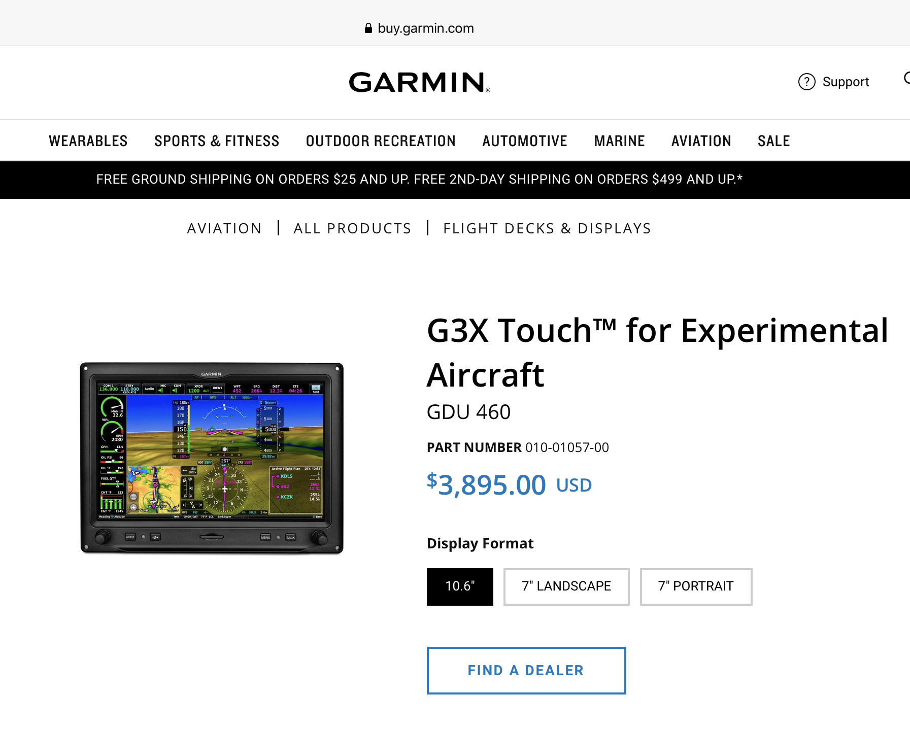

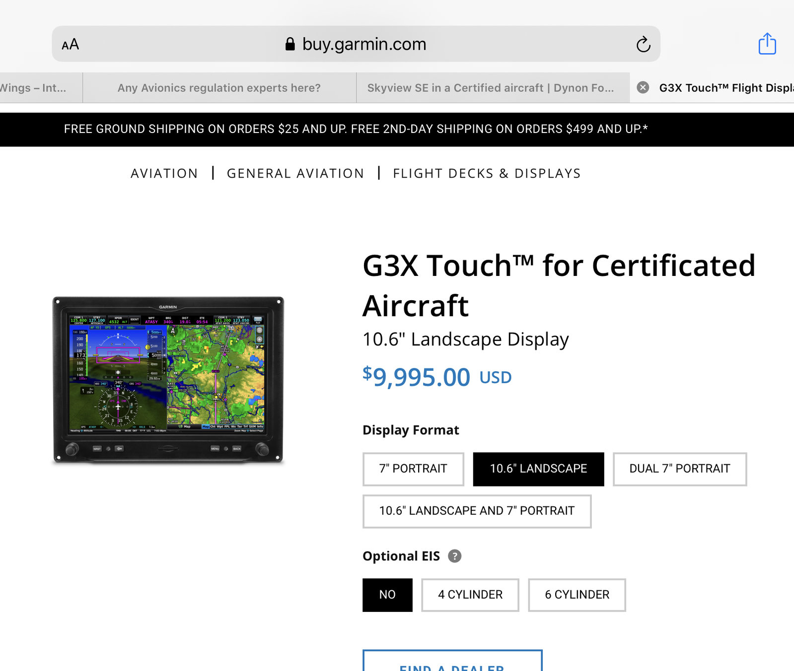

I have a Stinson 108-1 that I'm restoring from the ground up. I have to completely rebuild the dash anyway so I want modern glass instruments.
I think its CRAZY that I have to pay $6100 MORE for the "Certified" version of the Garmin 3X touch over the Experimental which we all know are the exact same equipment.
You KNOW the Experimental version is still FAR exceeding the CAR3 3.663 requirements.
