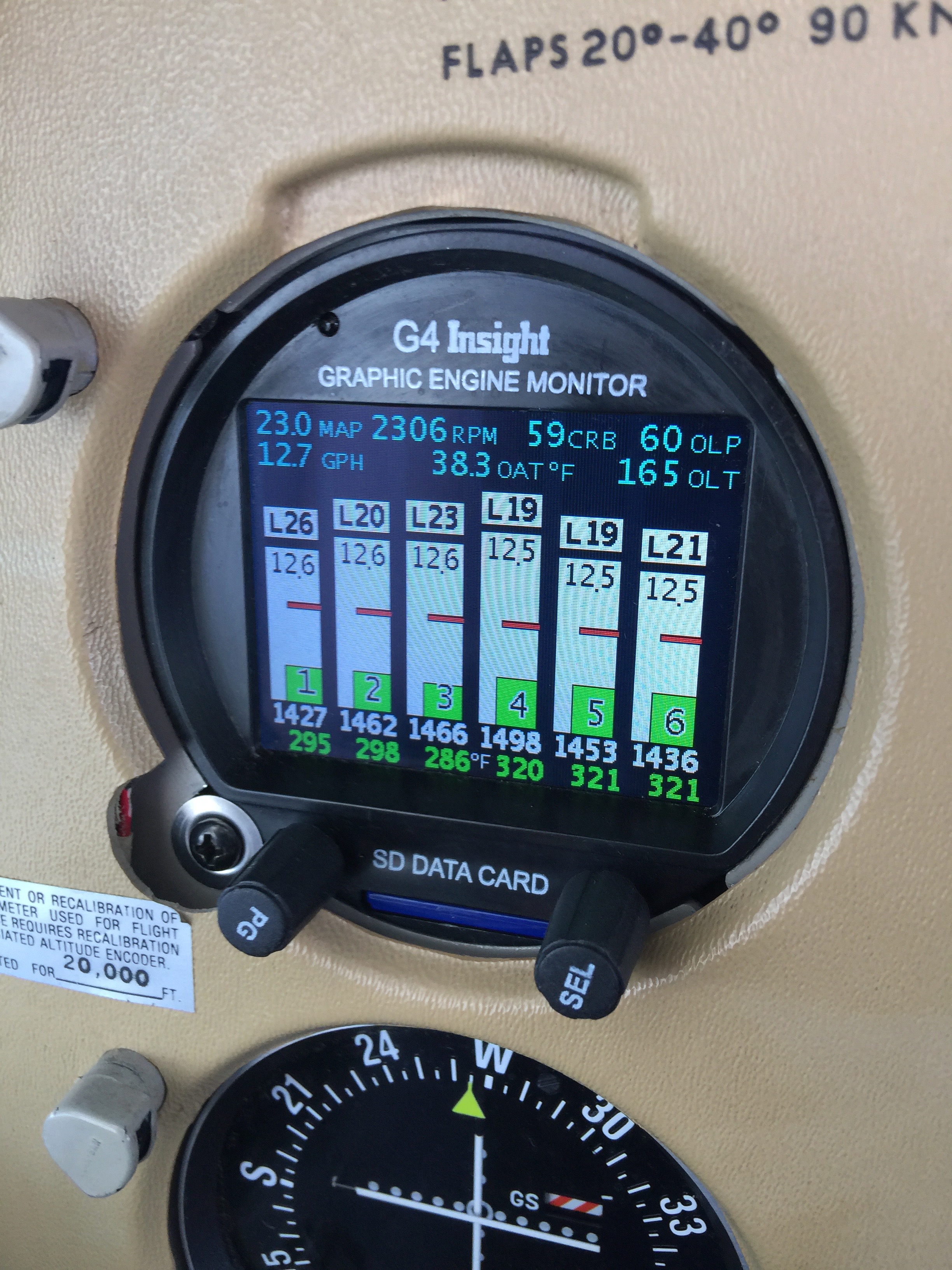

I don't get it. What are you suggesting? As the pic of my Insight G4 shows running LOP and burning 12.5 GPH my CHT are certainly under control. I could get further LOP, (because of the Electroair ignition) and get even lower CHT or I could burn 13.0 GPH and get higher CHT. Higher by maybe 10/15 degrees.
I really don't know how much higher the CHT might get as I always run LOP.

btoms, I'm glad you joined into this topic. It sounds like you could go even leaner but do you figure you just slow down quite a bit so 12.5 is a nice sweet spot for speed and fuel consumption?

Bob, my underlying point is that these ignitions are a great step forward, but aren’t miracle cures. With the certified systems you are stuck with a generic conservative program that the designer thinks is best all around for most people. In the experimental world I can program my SDS for every situation and have full controllability from the dash. Once I’m in cruise I can flip a switch which advances the ignition a set amount to allow best operation when LOP.
Yes your ignition works for how you fly, but it doesn’t fit everyone.

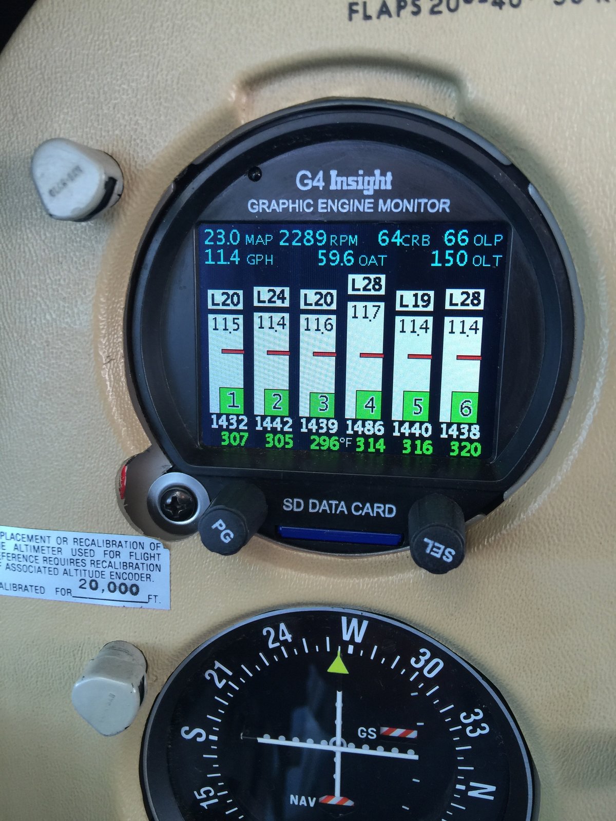

I can get my fuel flow down into the low 11GPH range since the Electroair Electroni Ignition install.
I don't really push it though. Most of my flying is at 3K' over the shores of Lake Michigan and I'm not comfortable when the engine 'hiccups' while over the water.
I would estimate the Electroair system at the 23 square 3K' setting would save me about .5 to .6 gph if I chose to go that far LOP. At higher altitudes the fuel savings get much better approaching 2gph.
Attached is another G4 pic showing 23 squared at 11.4 fuel flow.

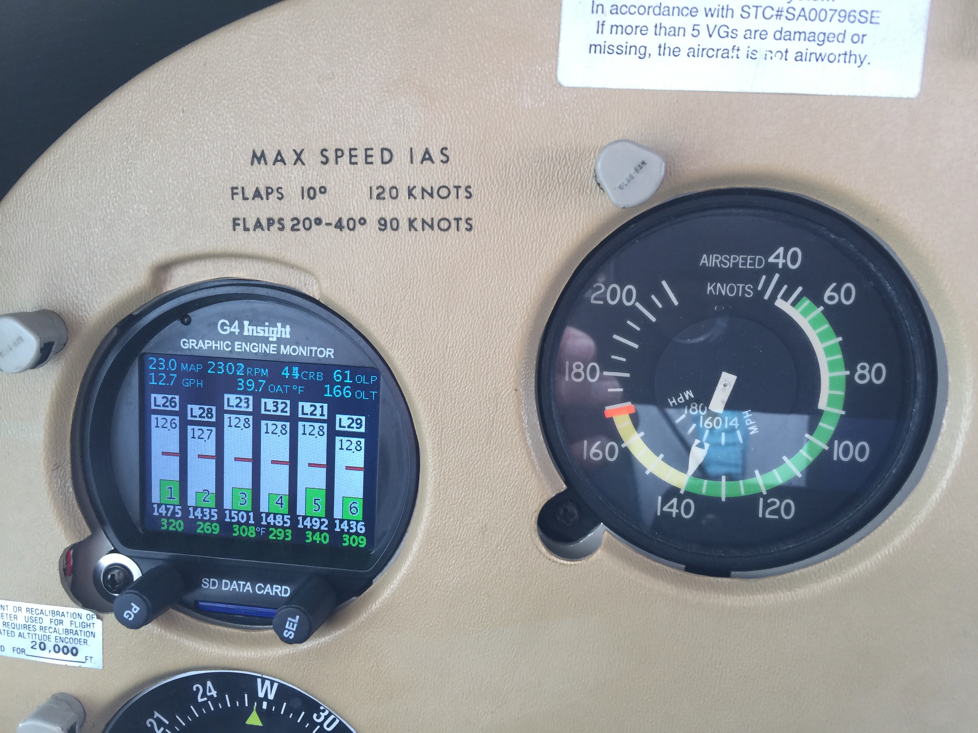

I have not played with different altitudes and engine settings. I pretty much always fly at 23 squared and between 2500' and 3000'. I usually shoot for fuel flow between 12 to 12.5 GPH.
I just had the Sportsman Stol installed and surprisingly picked up 4-5 kts, 140kts IAS. The original Cessna camber cuff did have some dents.
Attached is pic of my last flight, after the Sportsman install.
