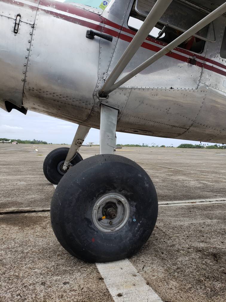

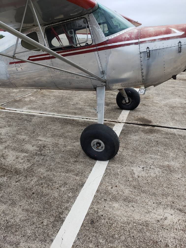

Got the desser 8.50's installed today. Currently have them at 20psi each, but they still look kinda low and squishy. I know they're supposed to be much squishier than normal tires, but does this look right?
jlacharite offline
Posts: 271
Location: Grand Rapids
Aircraft: Cessna 140 N89476
Cessna 170B N2693D
Re: Cessna 140 Rejuvenation
The red dot is perfect! And the tires are proportionally sized with no longitudinal grooves! Nice.

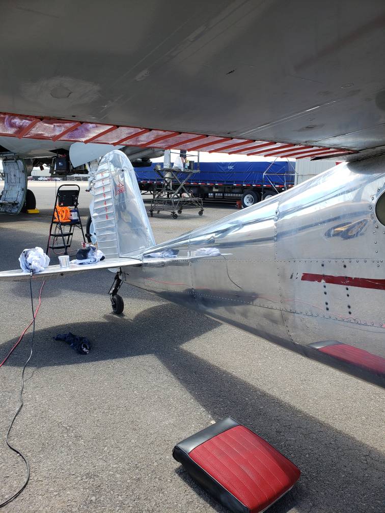

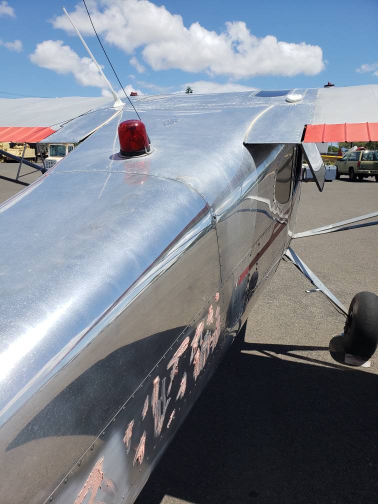

Finally got off my lazy ass and began the arduous never ending task of polishing. I really like the results, and this is with the lowest grade of polish. Hopefully will have the entire fuselage done with the low grade before it ships in 2 weeks. Once back in Massachusetts, I'll finish it up.
Also: bigrenna, you're a bad influence... your 180 thread got me all excited about polishing [emoji13]
jlacharite offline
Posts: 271
Cessna 170B N2693D

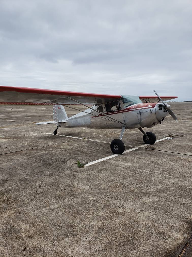

HOLY BEACON!

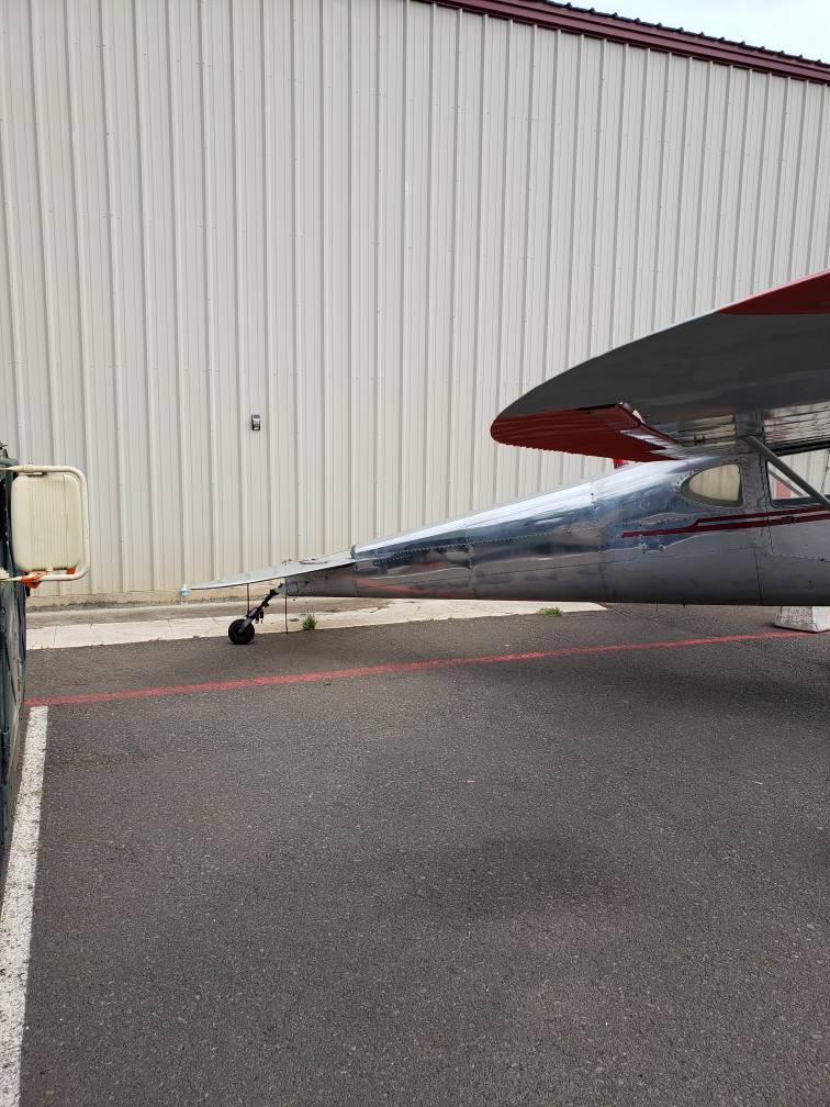

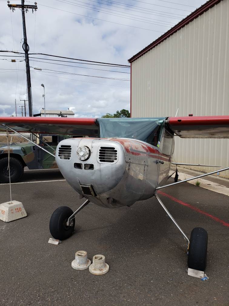

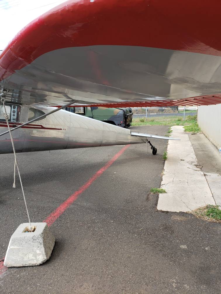

Am I the only one taking weight reduction seriously? Getting rid of all the unnecessary parts [emoji6]
ACTUALLY, removed all the fairings, propeller, vertical fin, elevators and rudder to begin preparations for container shipping the plane from Hawaii to California. The 140's final Hawaiian flight took place last Thursday. Wings and horizontal stab come off tomorrow! Need a second set of hands to get the stab off since I have the misfortune of needing to crawl down the tailcone to get to the bolts, and my brother in law is the unfortunate winner. Luckily for him, I'll be the one in the tail... No idea why cessna didnt put an access cover back there.....

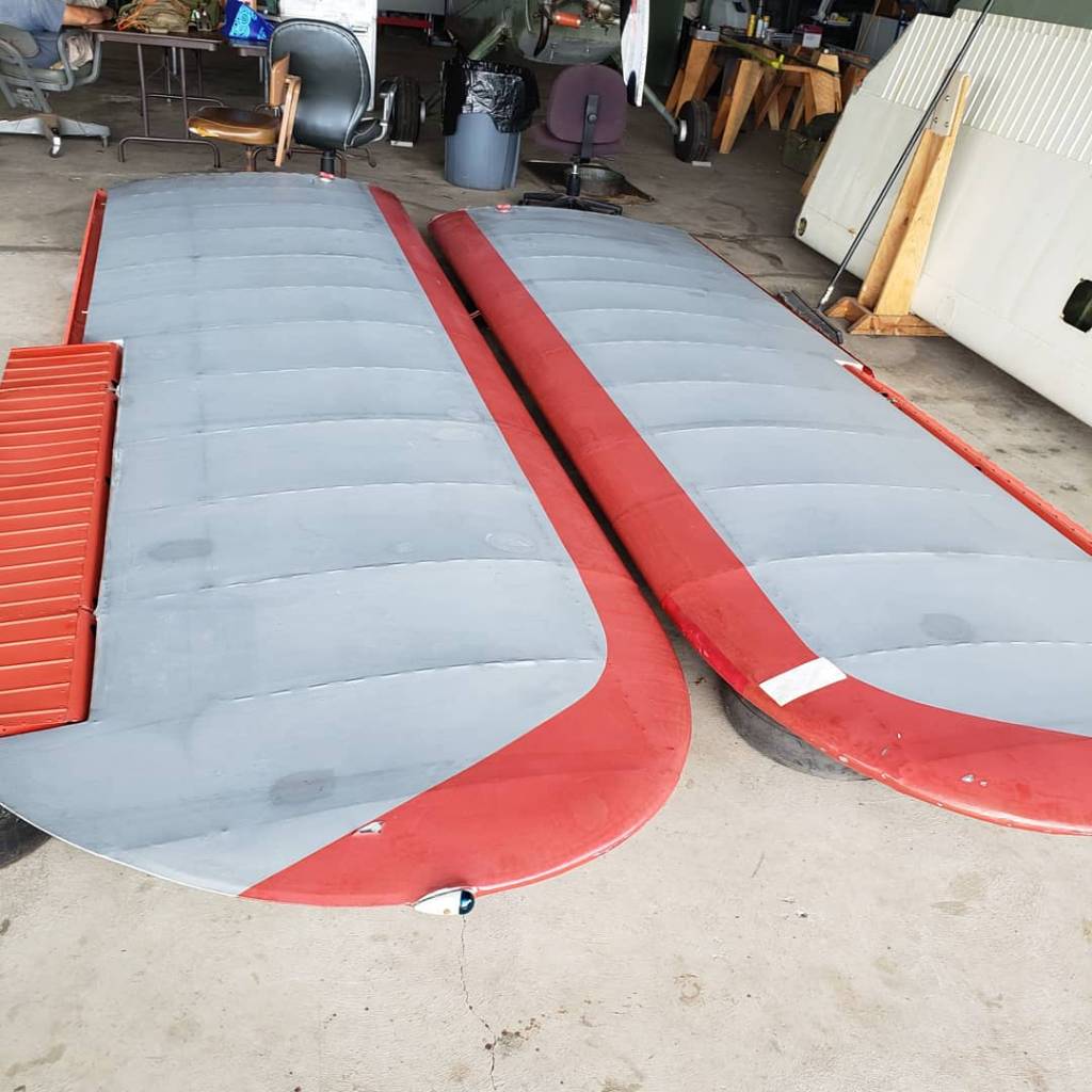

And she's apart... California or bust!

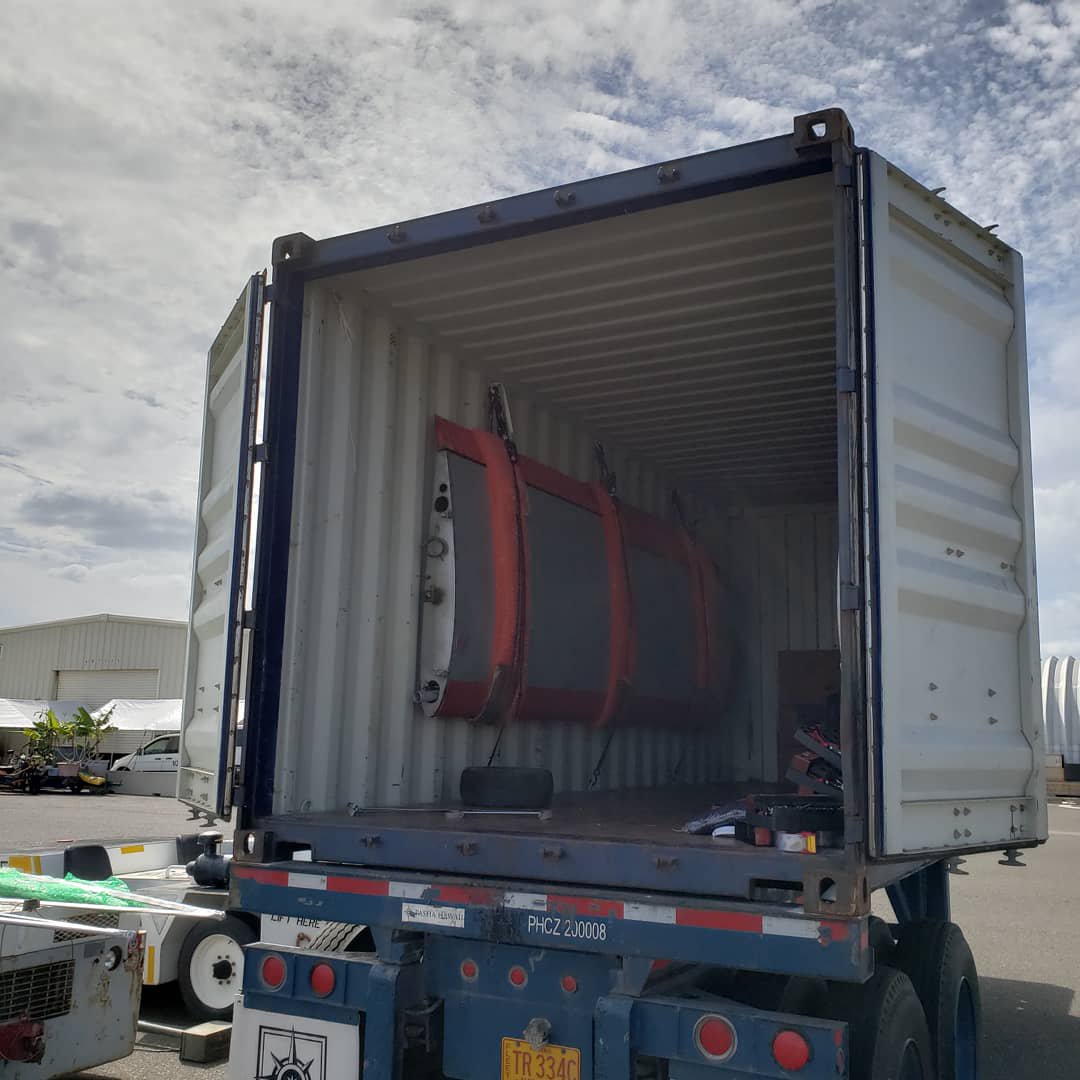

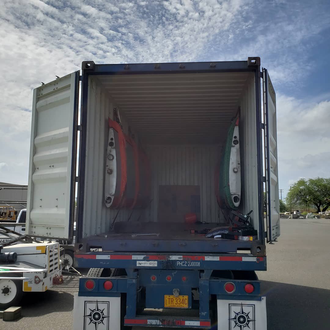

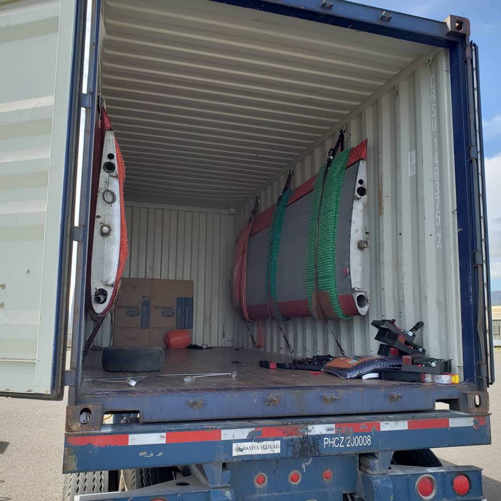

Well, the shipping madness has begun. We have 140 wings in a box.... fuselage and tail feathers tomorrow
