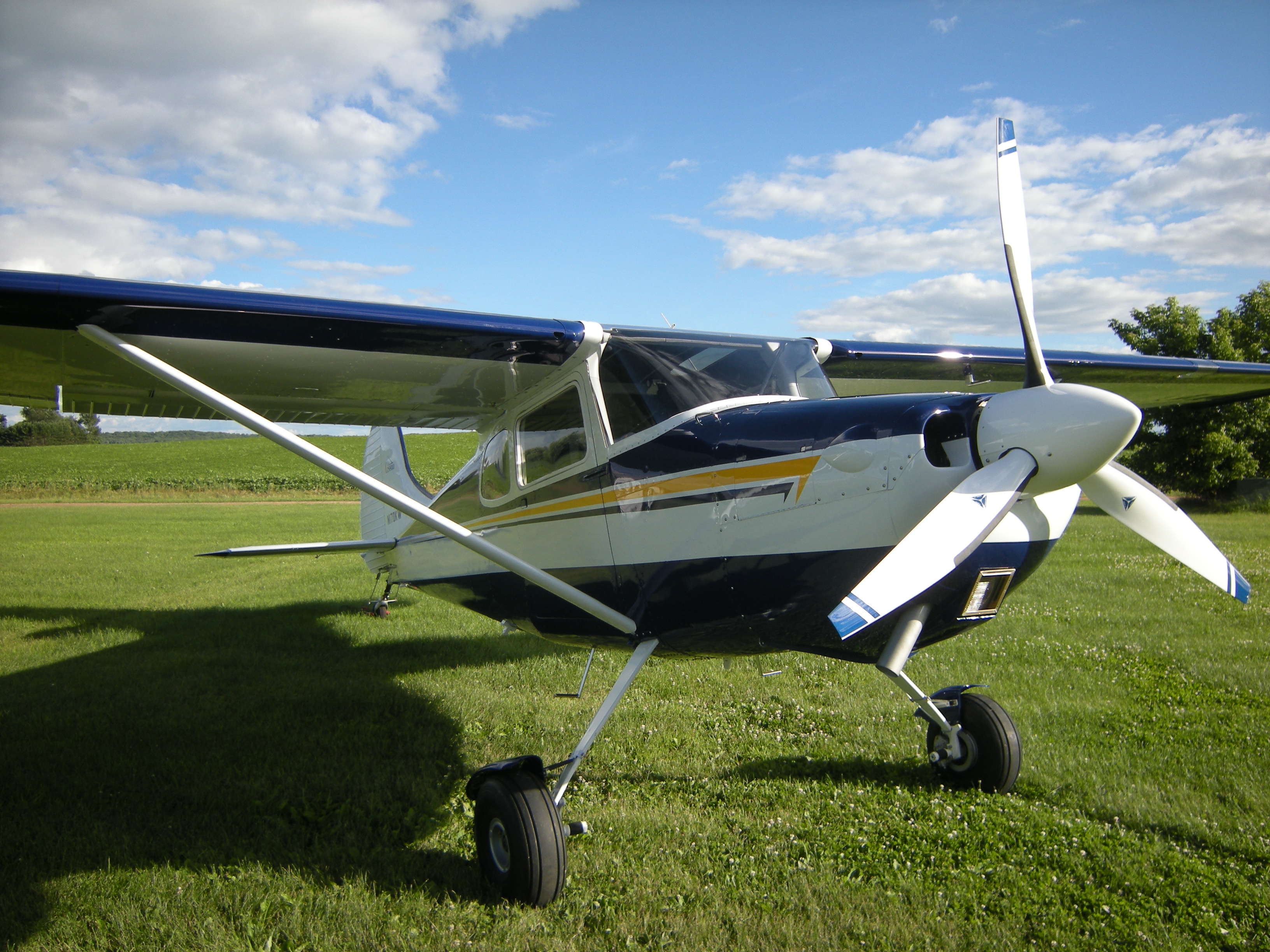

John's 1955 Super 170B
I will jump in and personally vouch for the quality and support Chris provided on my Super 170B project. Easy, allows for installer determined configurations, and clean fit. Hard to beat the parts supply for Lycoming -360 series engines and you can find lots of mods to make them burn more fuel.

Re: Cessna 170 Engine STC options
John,
Stunning airplane!
