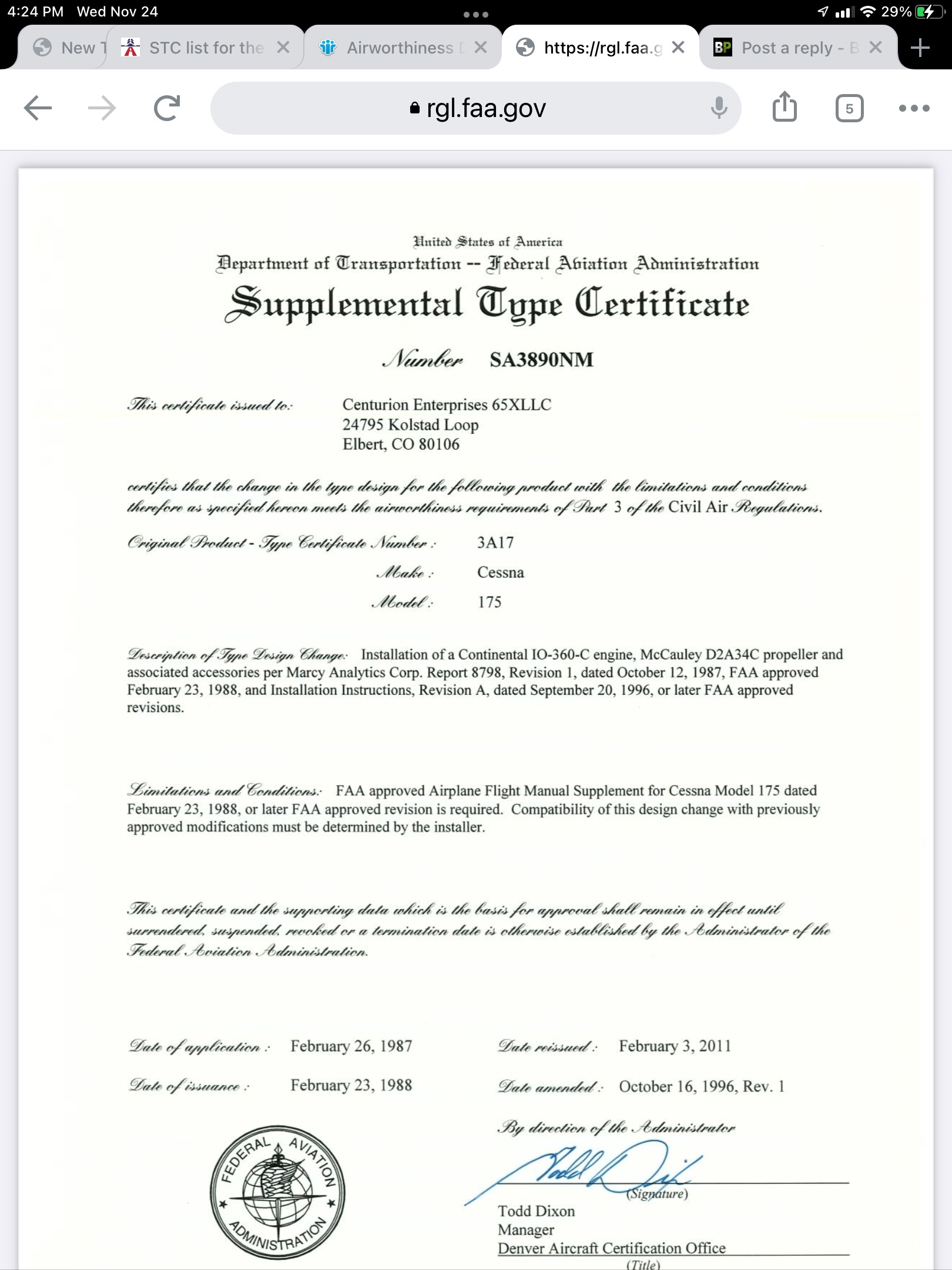

Does anyone have info on this STC holder? Can’t reach them. Has anyone purchased the rights?
