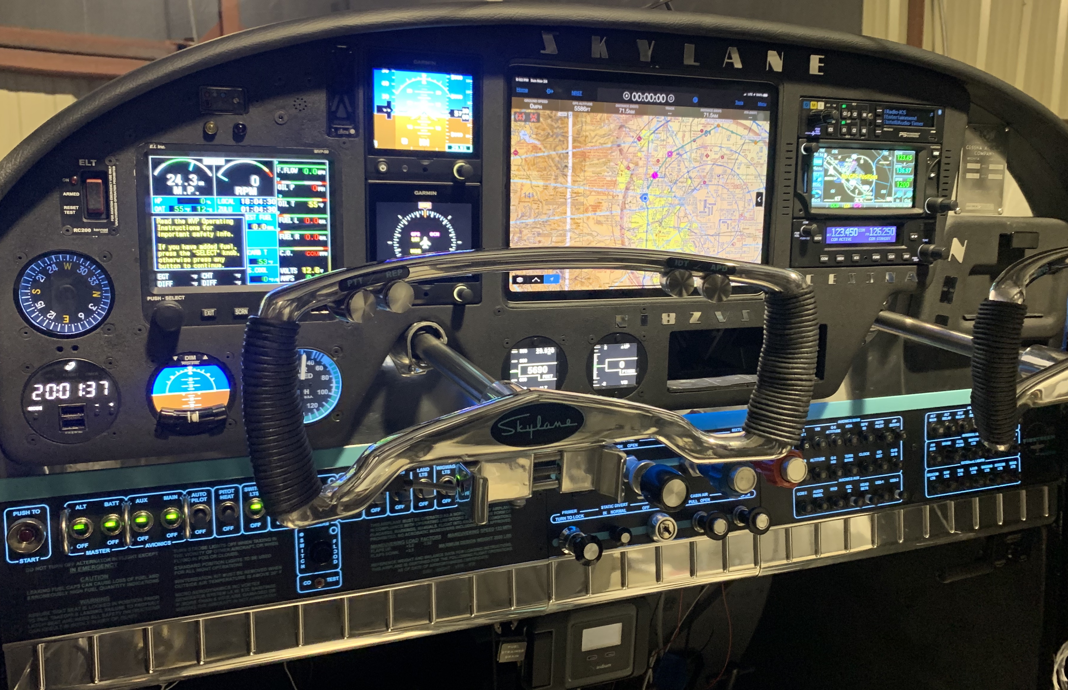

I love the older style yokes, over the newer style yokes I see a lot of folks replace them with. I think many replace them because the older style don’t have PPT switches like the newer ones do. I custom fabricated my own switches. I also flipped the entire yoke up side down, this aids in about a yoke being about 3” n the bottom higher and gives you that much desired knee spacing you find on newer airplanes. I stripped all the plastic coating off and took several hours prepping them so I could get a mirror polish look, they look way better and match the them of the polished exterior of the airplane. Lastly I took a lot of time routing the wire behind the yoke, leather rapping the grip area further hiding of the wires, and lastly routed them through the yoke tube so they are both totally out of the way and offer a very clean look then the coil wire you see so many do.

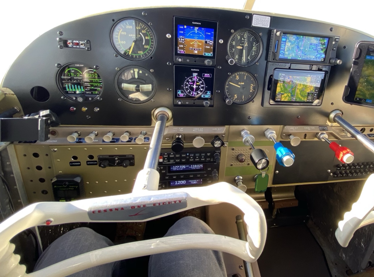

As a side note for PTT switches, mine is mounted on the panel.
It's above and to the left of the throttle(orange button), and is in a perfect place to mash with a finger or thumb while your hand is on the throttle.
I didn't think I'd like it at first, but it's really grown on me and like Vinstream's beautiful example, it eliminates the coiled wires hanging from the yoke that most PTT implementations have.
I only have one PTT, but for someone that needed two PTTs could mount another above and to the right of the throttle for the right-seater.

Vinstream wrote: I love the older style yokes.... I also flipped the entire yoke up side down, this aids in about a yoke being about 3” n the bottom higher and gives you that much desired knee spacing you find on newer airplanes.....
I'm the OP, I did install a set of early model 180 yokes to replace my after-market rams horns.
Loved the old-school look, but they were just a bit too low and interfered with my right hand grabbing flaps 40.
Tried turning them over but then they were too high, plus I didn't care for how that looked.
I ended up reinstalling the rams horns, after shortening the stem just a bit.
They don't look as cool IMHO but are very comfortable.

slow18 wrote: Doesn’t anyone have a lead on who might do a PTT like you see on the left yoke on this early 180? ....
Someone had installed a similar micro-button PTT in my rams horn yoke, apparently glued in place.
It went gunnysack & I destroyed it trying to get it out to fix or replace.
Ended up going with a velcro'd on PTT, mounted where I hit it with my pinky.
Not as clean looking, but it's in a better location for me, plus it's easy to replace if it fails.
