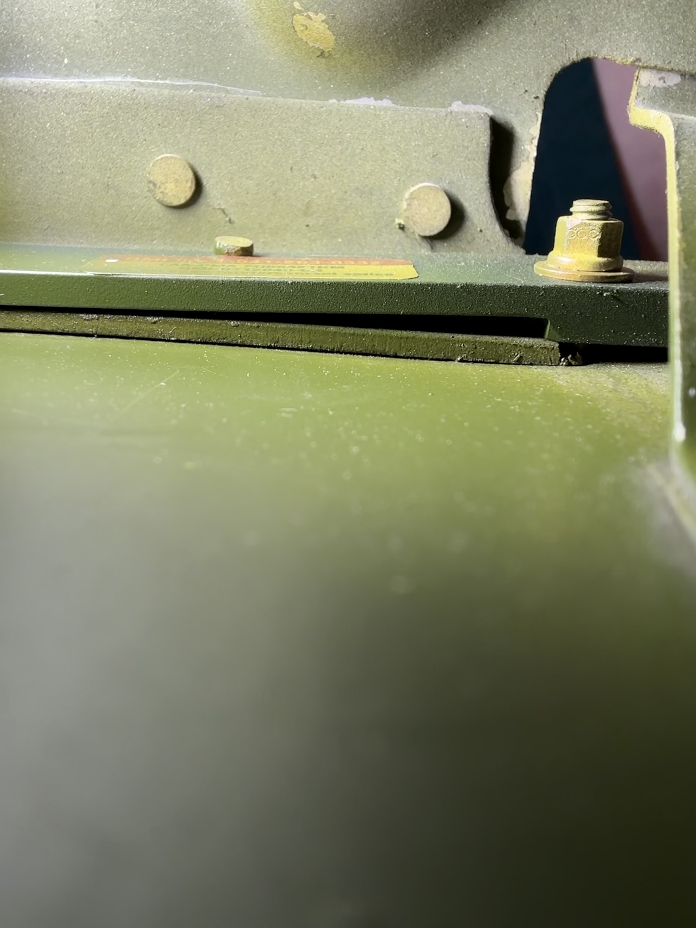

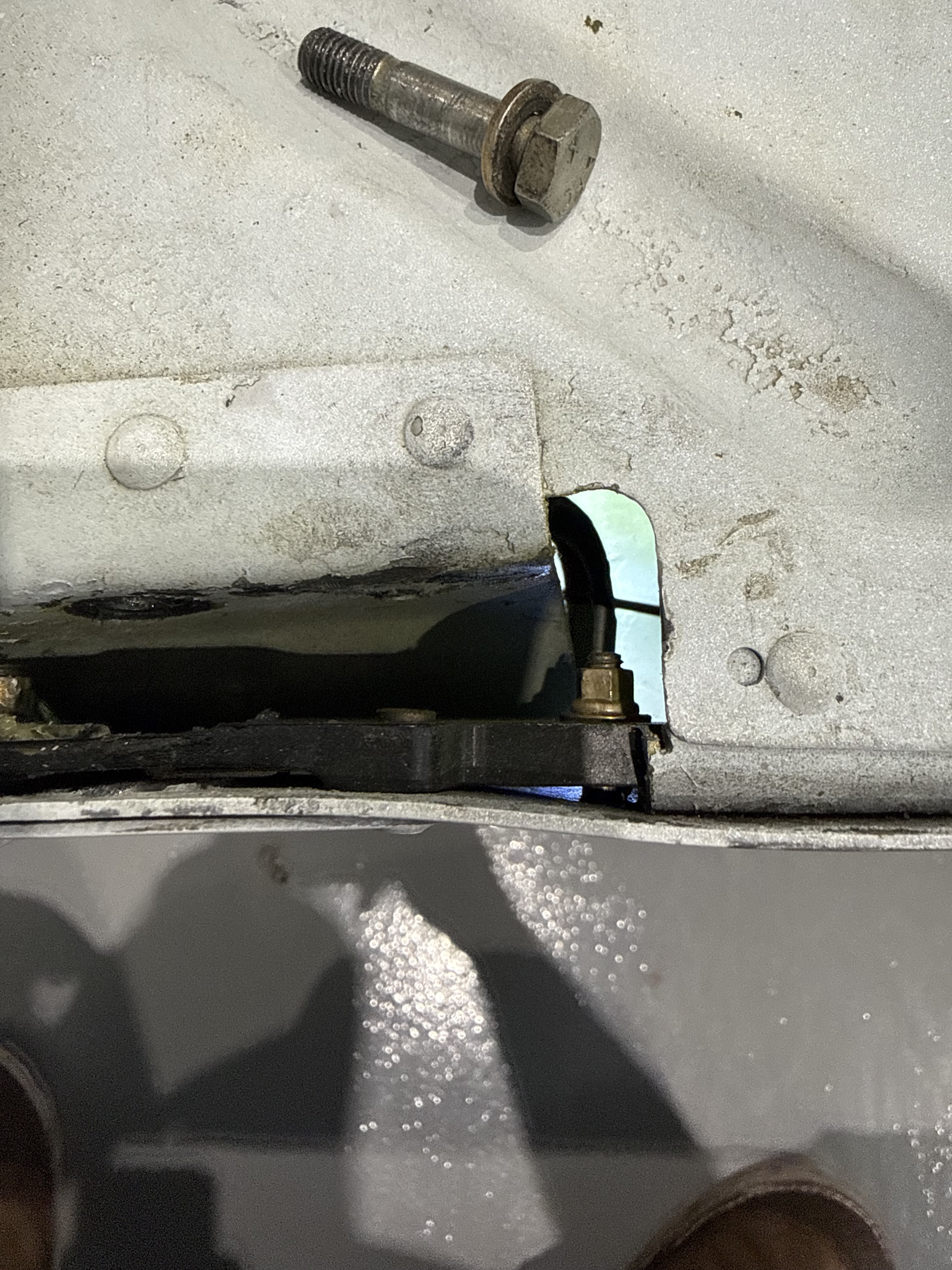

I wouldn't do the mcfarlane kit unless you absolutely needed to. I've never taken a tail off and not found at least worn bushings, even on a factory NDH airplane.
I've learmed more about the QMI kit with the last annual i did. First time at my shop and someone a few states north of me installed the original QMI poorly. Called mcfarlane to order the replacement pieces and it was a giant pissing contest, they wanted me to order the entire kit again. Even though the airplane had the STC. Fun fact, the original kit didn't follow the same angles as cessna and the stab didnt fit correctly. They have sense re engineered the kit. But if you want to fix there mistake, you can buy the entire kit again
This is why we trust but verify. The owner is an A&P and was arguing with me about taking the tail off. We can see everything we need to with it on. Sure, but if i'm signing it off, the tails coming off. Inner bracket was cracked too. It was hard to see, even with the tail off
The black is the original QMI
The white is the latest rendition of the Mcfarlane. You can see the angles that line up with the stab better, and parallel to the inner brackets.

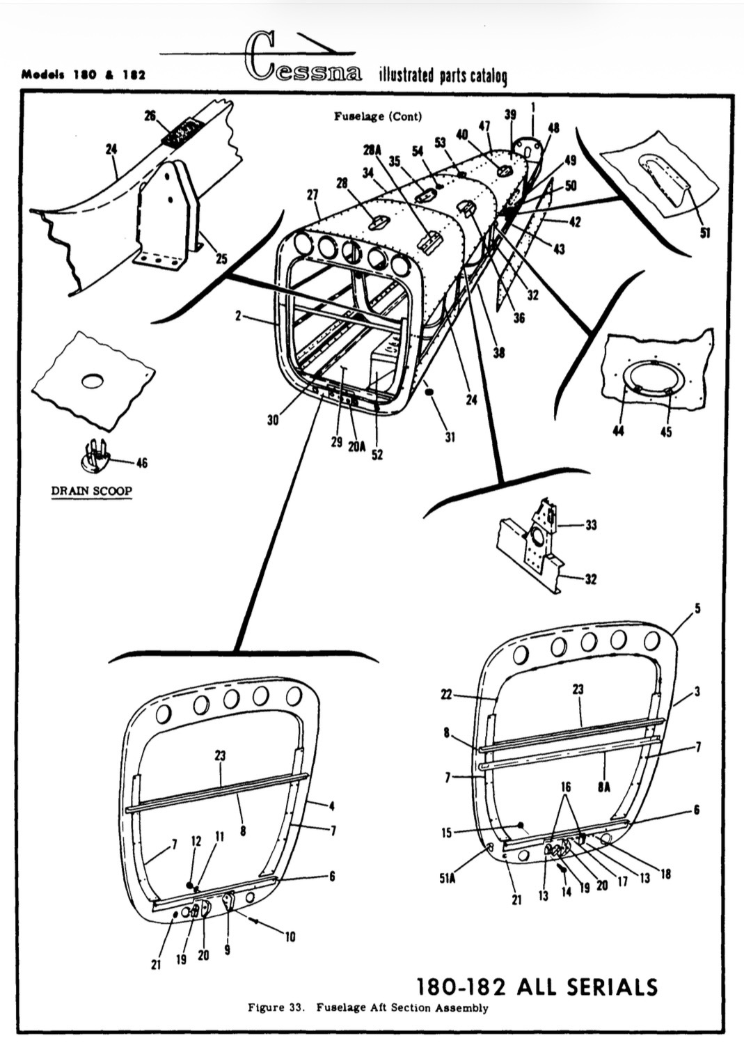

Is that Item 54 (P/N 0712304-1) in the Pre-63 Parts Manual below:

If so, did Beagles replace it with new, NOS, or fabricate it?
Thx, Ron
jrc111 offline
Posts: 355
Location: Walters
Re: Cessna 180 Jackscrew & SEL-55-01
Part number 0712001-3. They replaced it with one they had on hand.
I'm not exactly sure which part that corresponds to on that parts diagram but item 54 looks about right.

Your C180 is a later model, so unsurprisingly, it has a different P/N. The P/N I referenced above is about $110 new from Yingling plus shipping; I haven’t heard back from Textron. Given Textron’s bureaucracy, I wouldn’t be surprised if it is more. BAS sells them for about $40 used, plus shipping. Mine was fine, last time I looked at it. I don’t consider removing the dorsal fine a necessary part of the 5 yr AD, which on my A/C is coming up in Sep.
