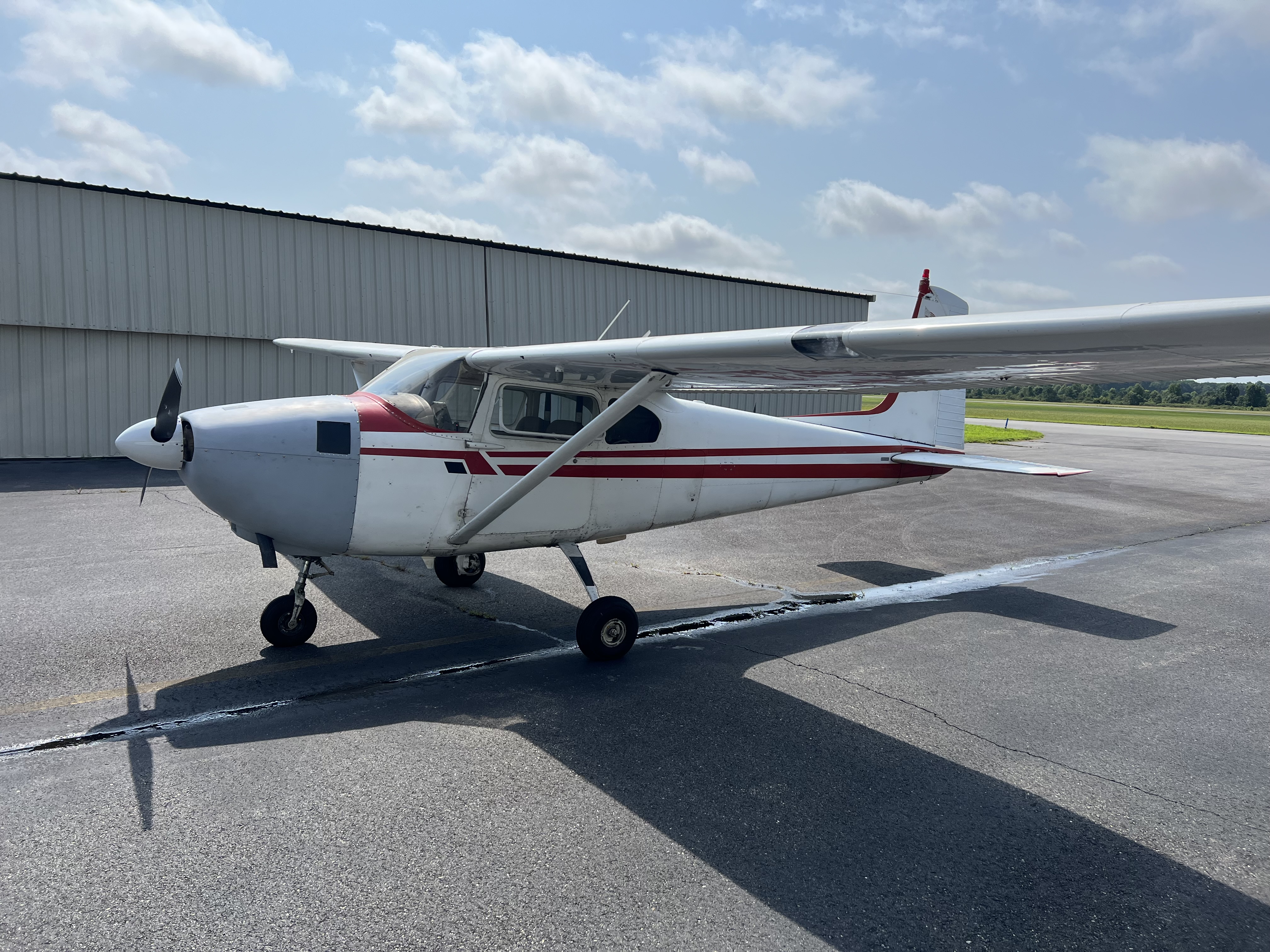

So I'm new to the site. Fly a Cessna 182A that has been converted to a taildragger back in 1996 before we owned it. We bought the plane about 10 years ago now, and I got my license about 6 years ago, did my training and testing in this plane and it is basically the only plane I've flown. It has been a great plane, it is a blast to fly (not that I know any other planes really, but all the Instructors really enjoyed flying it during my training, although they are used to sitting in 172's all day) BUT it is a little rough around the edges and its age is starting to show. We have figured it is finally time that we clean it up a bit, giving it a fresh paint job, and redoing the interior.
It gets used as a pickup truck for us alot, often flying for parts for our farm or spray operation, or just bombing around the country side. Don't do alot of big cross countries in it, so it usually lives fairly close to home. Unless we have something to pick up out of province.
So as I said, it is a 1957 Cessna 182A that was converted using the Baer Tailwheel Conversion back in 1996. It also has a Sportsman STOL kit on it, along with an extended baggage, EI EGT/CHT Monitor, Bubble windows. If I remember correctly it is sitting on 185 gear, and I always thought it had a PPonk beef up kit, but when I was going through paperwork today I saw something about a Kenmore landing gear upgrade, but I don't see an STC for that on their website. Unless the STC had changed hands at some point.
I've been scouring this site reading about all the great projects going on here, and gathering ideas on what else we should be doing while it is getting painted. This won't be a full on rebuild like some of these projects here, but will likely be done in a few phases over the winter when it doesn't fly much anyways.
One of the big ones is the cowling, which like most 1957 180/182's I'm sure, is in bad shape. Been looking at the Selkirk cowling, read great things about it, and have talked to them several times on the phone and they are quite helpful and seem great to deal with.
I'm debating between the Category 1 cowling, which would be a replacement for my existing 182A cowling, or their Category 4 cowling, which would be more like a later model 180 cowling, but they have it STCed for 182A's with an adapter for the airbox. It would be nice to go with a 180 style cowling to make it look the part a bit better, but it is quite a bit more money, and would have to add in cowl flaps (not a big deal, but also have to remember to use them). Also, we still have the nose gear casting attached to the underside of the plane, which from what I can tell is normal in the Baer conversion, but I'm going to have to look into if we can remove that somehow. It would be nice to not have that thing dragging in the wind underneath.
Anyways here is a picture of the plane currently. Probably won't start on the paint job until end of Novemberish, but still lots of planning to do before then. Feedback and ideas always welcome! I plan on posting a bit more about my plans as I start narrowing down some of the things I am looking at doing to it while painting.

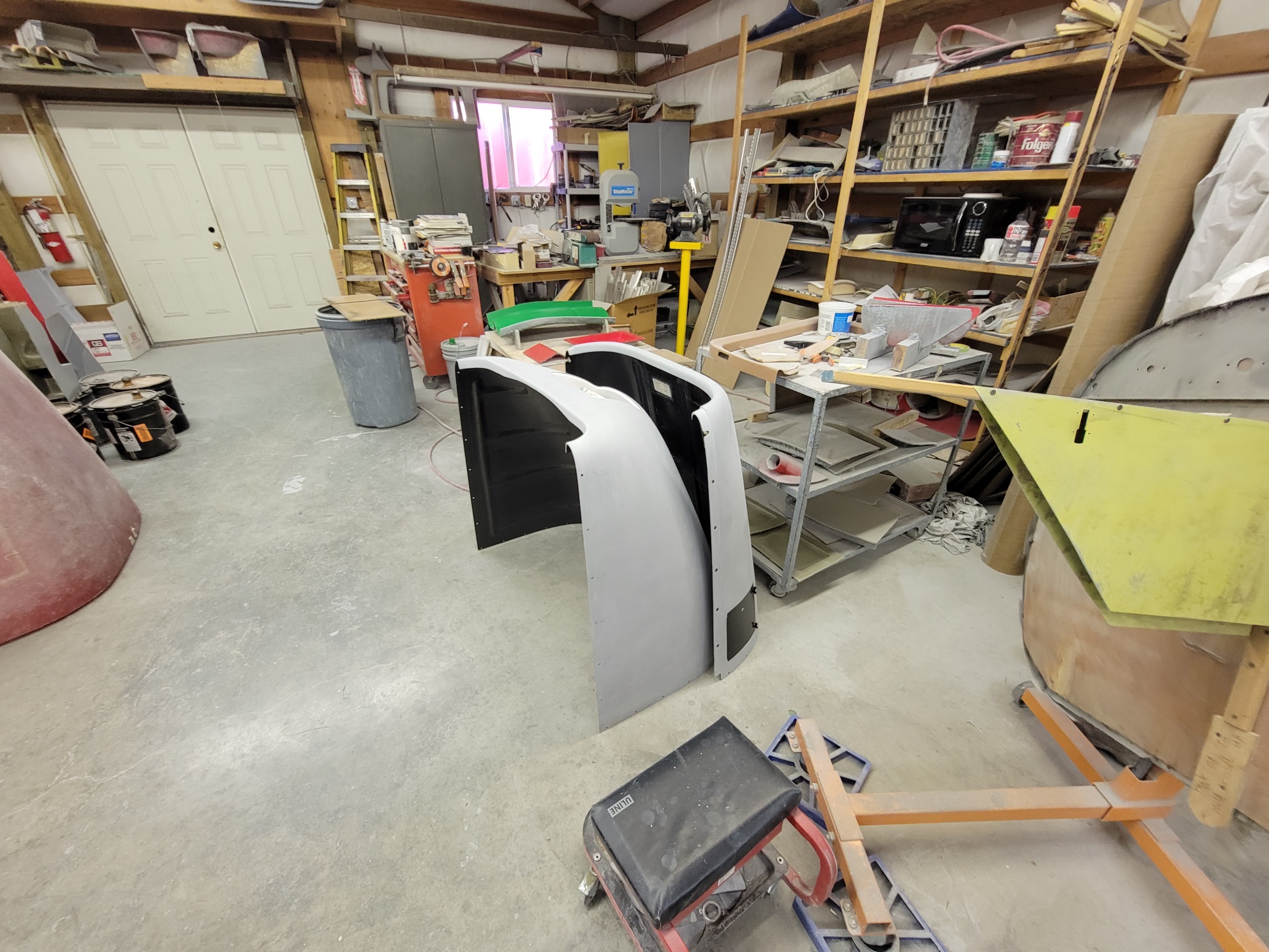

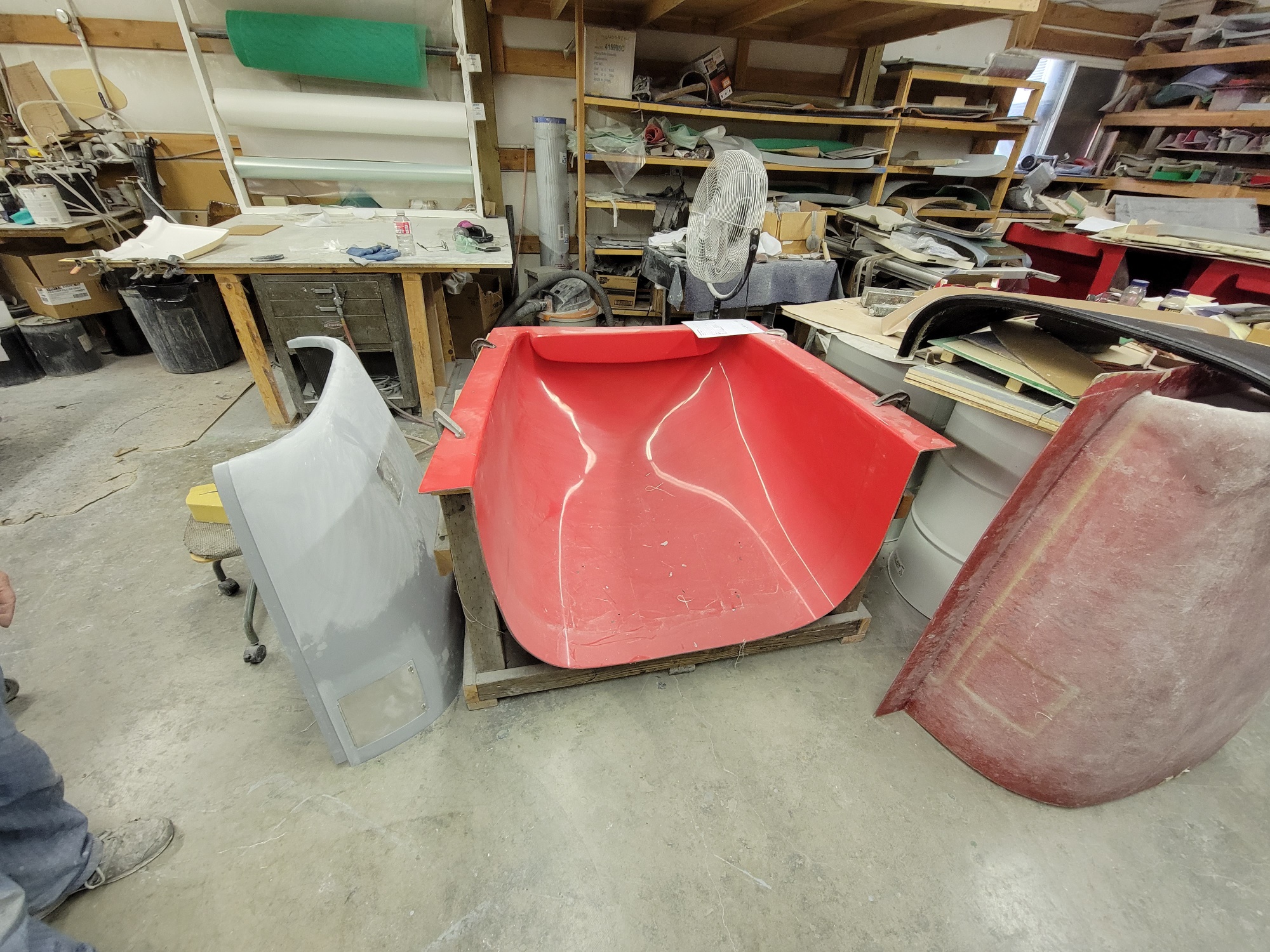

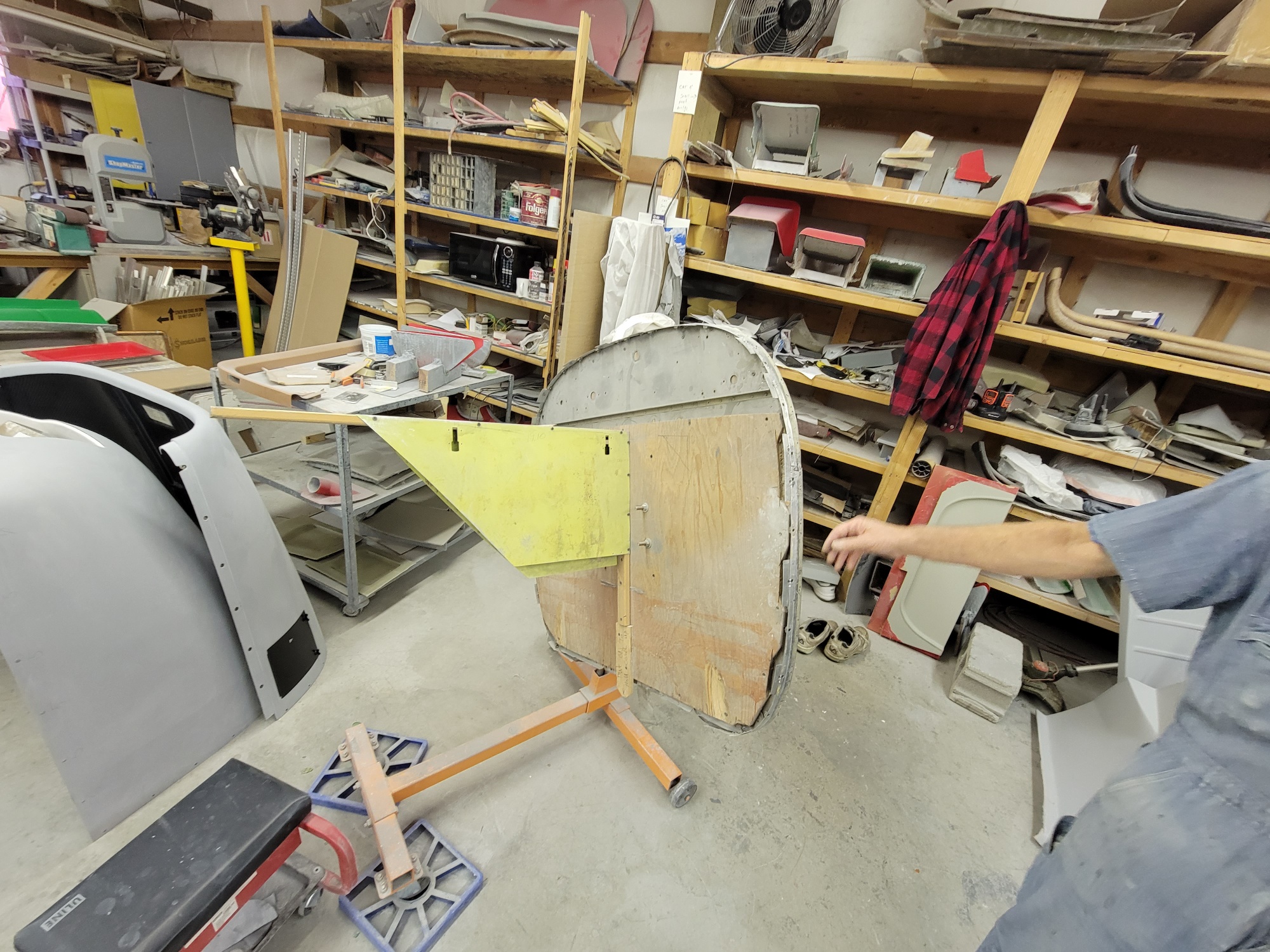

I just drove out to Selkirk and picked up my new Cat 4 cowl for my "54" 180. I want to update firewall forward to be like my 180K and have most of what is needed----just need to get motivated to do it. I haven't tried fitting anything yet but have a friend that just put the original style on his 182A and it fits great he said. Here are a few pic's of my cowl, the firewall and mould used to make the Cat 4. I am keeping the original screw holes but will need to change to floating nut instead of the original tinnerman's at the firewall.

180Marty wrote:I just drove out to Selkirk and picked up my new Cat 4 cowl for my "54" 180. I want to update firewall forward to be like my 180K and have most of what is needed----just need to get motivated to do it. I haven't tried fitting anything yet but have a friend that just put the original style on his 182A and it fits great he said. Here are a few pic's of my cowl, the firewall and mould used to make the Cat 4. I am keeping the original screw holes but will need to change to floating nut instead of the original tinnerman's at the firewall.
Marty do you still have the dual exhaust on your 54?
I see the cat 4 cowl is later model stuff, so is set up for single (RH tailpipe) exhaust as well as the narrower cowl flaps.
Personally I'd prefer the early (cat 2) cowl, I like the shark-mouth induction air opening.
I think the early cowls are sleeker looking in profile too.
I notice that the Selkirk cat 2 nosebowls don't have the upper-to-lower connecting ring behind the spinner,
which is good cuz it's a PITA,
but it doesn't seem to have the sort of squared-off inlet which I like (see pic).
