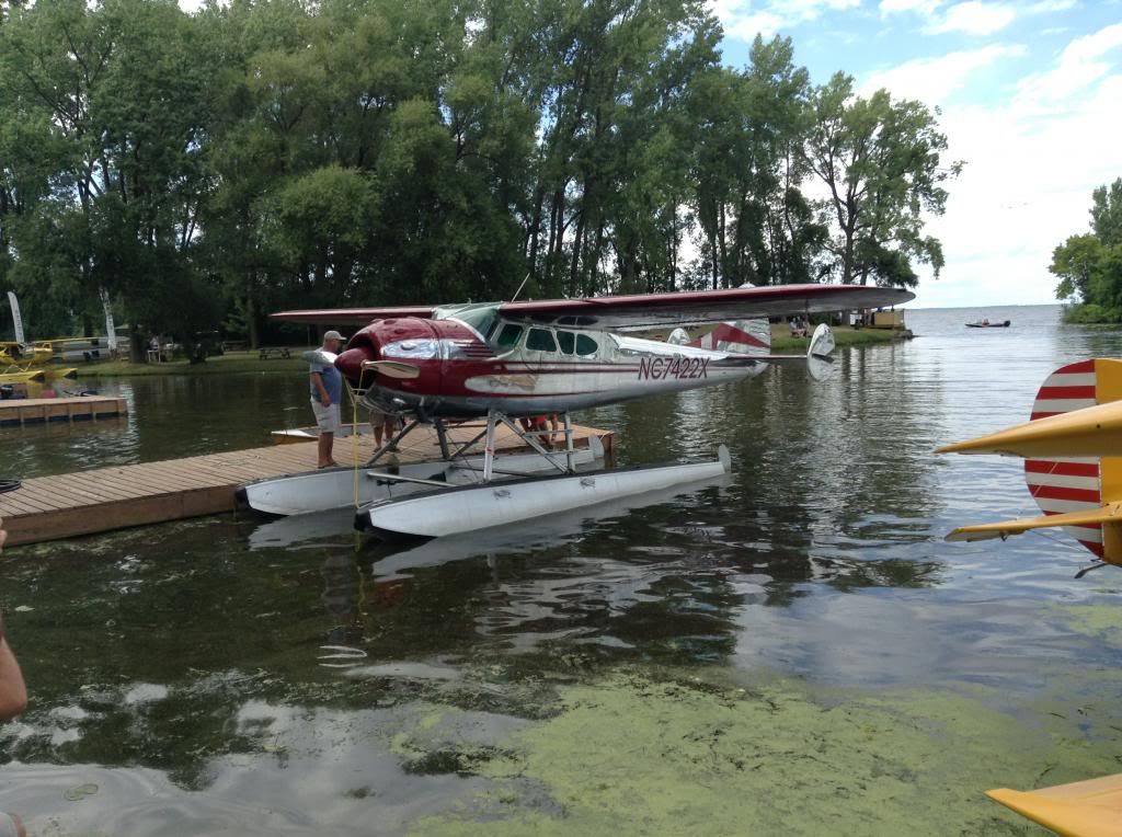

Saw this at Oshkosh this year...had to reel back in my drooling tongue

Last years (2012) Grand Champion, I believe.

mnewb1 wrote:Saw this at Oshkosh this year...had to reel back in my drooling tongue
Beautiful.
