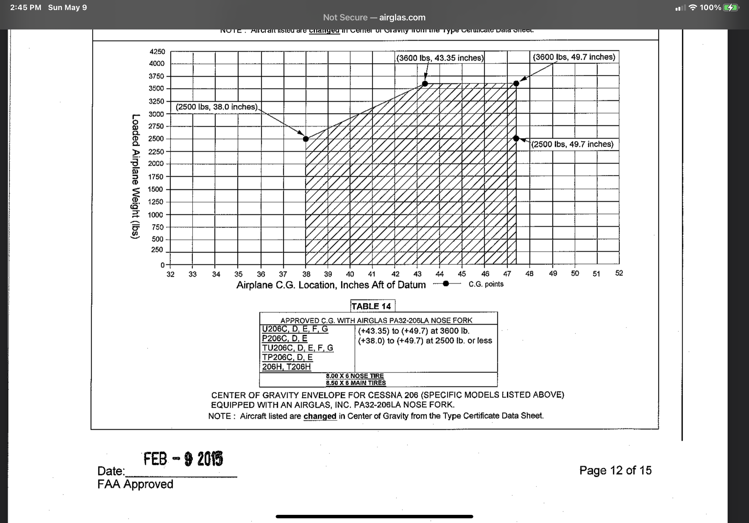

… I did not consider it while looking at propeller choices, but just realized that the air glass fork POH supplement moves the forward center of gravity envelope back from 33 inches at 2500 pounds to 38 inches at 2500 pounds! With two people in full fuel and an aluminum three blade prop, I believe I would be past the forward limit by an inch or so, with the MT I would barely be inside of it. I realize a little bit of luggage in the back of the plane will make the difference, but thought I would post this for those who may not be aware.

AZ Flyer wrote:… I did not consider it while looking at propeller choices, but just realized that the air glass fork POH supplement moves the forward center of gravity envelope back from 33 inches at 2500 pounds to 38 inches at 2500 pounds! With two people in full fuel and an aluminum three blade prop, I believe I would be past the forward limit by an inch or so, with the MT I would barely be inside of it. I realize a little bit of luggage in the back of the plane will make the difference, but thought I would post this for those who may not be aware.
The nose fork cuts the first five inches off of your CG envelope? Interesting :-k
Let's see pics of your new ride?
It looks like it is only certain models setup with a specific tire size. Very interesting though. I wasnt aware of that, but mine is not one of the listed models...

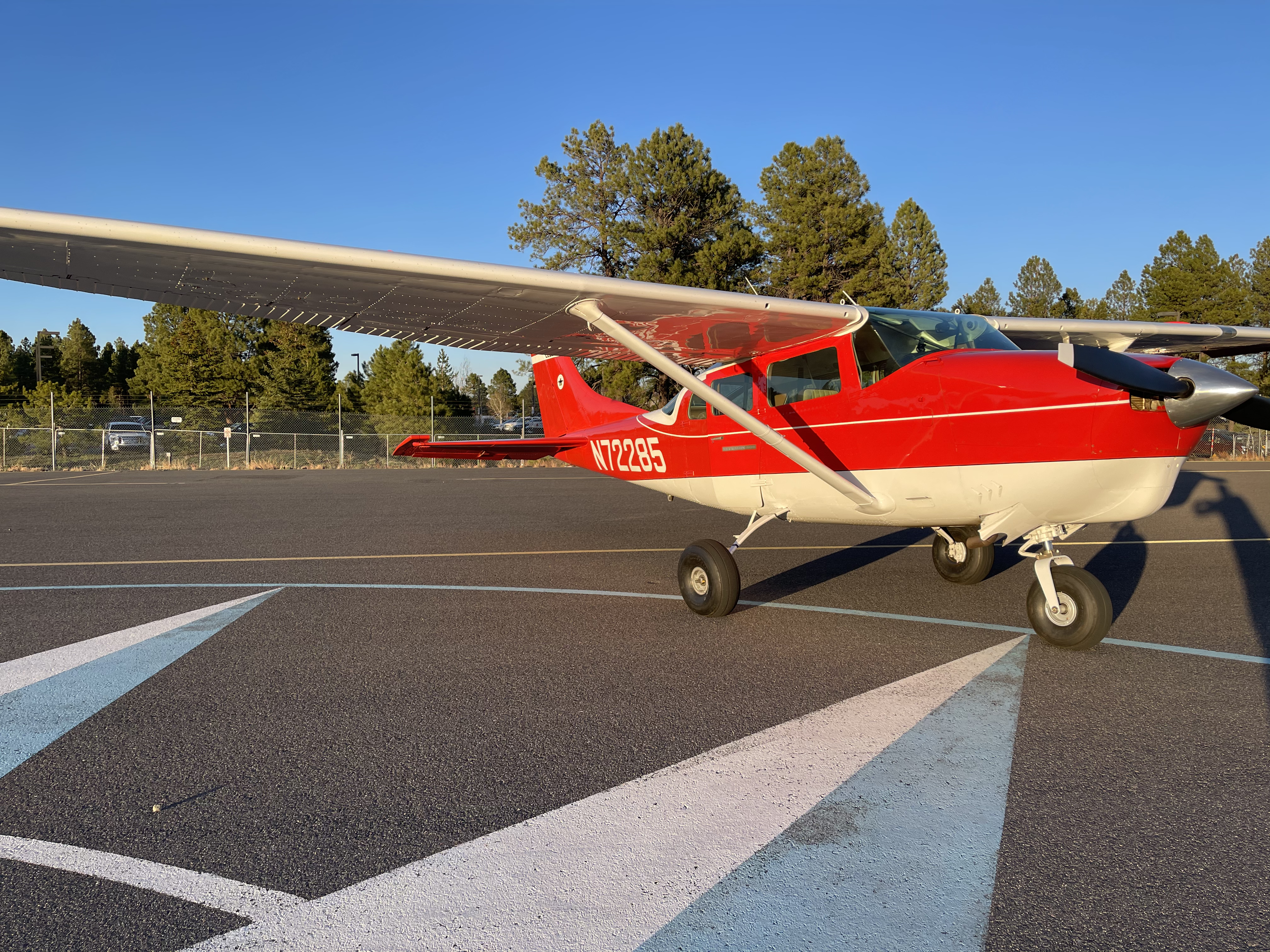

Here is a picture!

AZ Flyer wrote:Here is a picture!
Looks like a beauty!
I love a red and white airplane, and I love a 206!
