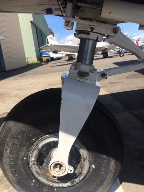

Hi All,
Thanks for the information so far. More work done today but still no answer on the issue just yet. I pulled the steering collar to look at the bearing, and although it was a little dry, it did rotate. Cleaned, washed out and repacked with Aeroshell 6 and reshimmed. Nice and free so connect all back up and try it. Nope, still wont steer.
RYB 1.jpg (103.5 KiB) Viewed 2721 times
Attached is the image of the gear, as you can see, the strut isnt overinflated so the lock isnt an issue. Oh, and thanks for the heads up on possibly being a 310 fork, I never even considered that one. Good call.
My only other thought or what I hope someone may know, why is the wedge plate used on the heavy duty leg?
With the wedge in place, the fork is raked forward which will change the castering effect. From what I can see, if the light nose gear was installed, the leg would be more vertical and possibly easier to steer.
I'm sort of at a loss to what to do next, except pull the entire leg and bungee mechanism and strip it on the bench and really start looking hard.
Any clues??
Thanks for the replies so far.
Rgards
Rob

Re: Cessna 210-5 (Cessna 205) nose wheel steering issues
I have the 310 fork on a C-182 powered by a 520 without the wedge plate. It steers just fine and has had no problems since it was installed years ago. The nose strut is the basically the same mechanism on both the 205 & 182 but the centering mechanism of the nose wheel is different.
I recall the 205 shows the wedge (shim) in the parts manual with the heavy duty nose fork, which is the 310 nose fork. Your pic shows the wedge in the correct position according to the parts manual.
FWIW, a friend had the 310 nose fork with the wedge on his 1963 205 and it was more difficult to steer than with the light duty nose fork. He was careful about aft loading to keep the strut from fully extending.
-0-
dogpilot offline
Took ball and went home
Posts: 902
I was just looking at the parts manual and it shows that the heavy duty gear was available for all the 205's as an option, however it shows no wedge that I can see. I don't think thats your problem though.
Things are pretty tight under there where the bungee mounts to the pedal bar. Check your clearances. A bit of horizontal play in the pedal bar could cause some rubbing or binding. As I recall, it's tight enough so that if the bungee mounting bolt is slid in to the mounting hole from the right instead of from the left as the manual shows, there were clearance issues. While you under there checking for binding or clearance issues, check clearance on where the push-pull rods mount to the pedal bars.
Also move the rudder trim wheel full left and back to full right and see if it steers better either way. That would help rule in or out the bungee itself.
Did you figure this out? I notice given your serial numbers you may have some
Incorrect parts! Yours are before 480. So the torque link shouldn’t have that centering pad. See the parts manual page PDF 110 vs 113. That may or may not effect it. Also it does show the shim in the 205 manual.
