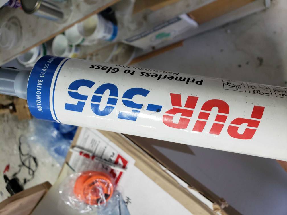

This is what I use. Works great as well. I use electrical tape instead of fine line because it basically does the same thing for a lot less money. It allows you to follow bends and contours pretty easily.
I like that link you provided Greg. Thanks, I'll get some of that for when I do all my 206 glass.
