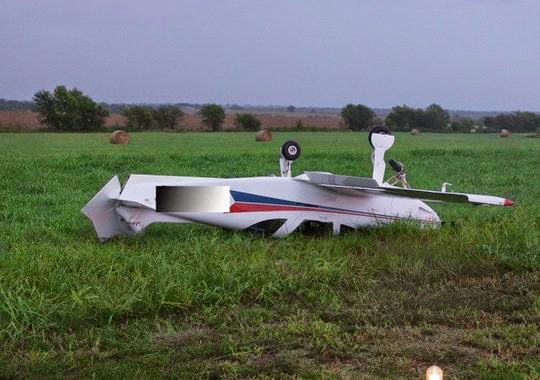

I hear that landing a trike on soft ground where the front wheel can begin to catch softer dirt and gravel can be an adventure \:D/ Similar fun can be experienced with the collapse of the nose wheel which in many Kits, LSAs, and Experimentals is not as robust as it might need to be for more demanding off airport activities. Weight vs. robustness. I've always admired the robustness of the nose gear on a Bonanza retractable; you could do carrier landings with that gear I think.
#-o
Short Video
https://www.youtube.com/watch?v=2p0fcKC04Dk
#-o
#-o
#-o
I am sure tail draggers have issues as well, but probably to a far lesser degree. As always, pilot skills and judgement probably count for way more than the plane. For years now I have been looking in the Sporty's catalog for " pilot skills and judgement " , but I still can't find it listed. I'll take two please.
