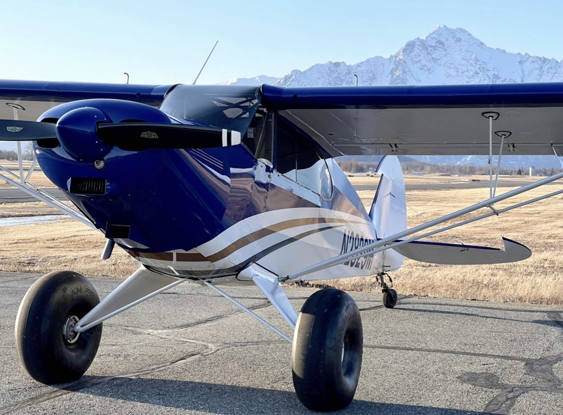

Ended up trading for my old 172.
About 100 since top overhaul and fuselage and fabric redone about 10 years ago. Pretty much stock but still feels lot funner then my old 172.

Nice looking machine! Congratulations, now burn some gas!
And let us know how it’s working for you.
