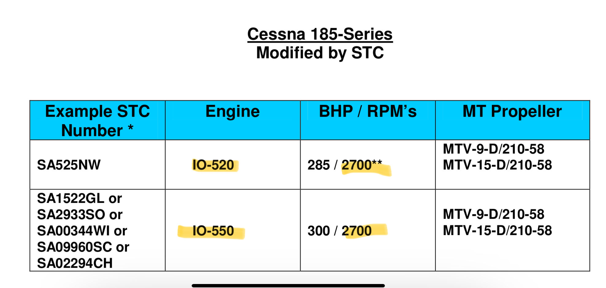

Unless, something has changed, Flight Resource has the MT prop STC for max RPM of 2700. If you buy the prop from them, it comes with that STC. If you buy it elsewhere, you don’t. My understanding is that Flight Resource undertook the testing to receive the approval so as not to be limited by the lower RPM restriction directed by the European agency. That restriction is for noise compliance, not operational limits.
Did some digging, this is from the flight supplement for MT propellers installed on 520/550 equipped 185’s per Flight Resource’s STC, 2700 max RPM:
