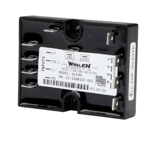

Re: controller for the landing/spot
Wouldn’t be certified
But I wonder if any of the police/EMS controllers/switches from whelen would work?
https://www.whelen.com/product/ulf44-un ... #gallery-4
“ LED or Super-LED® flasher with synchronization
60 Watts per outlet
Four outlet, four channel flasher with 62 Scan-Lock™ flash patterns allowing for alternating, simultaneous, and synchronized flashing lightheads
Each channel can drive up to 5 amps (60 watts) and is short circuit and thermally protected”
Picked up a auction detectives car a while back, it’s got all the hidden flashers and stuff, the controllers and all seem tuff as nails, don’t see why it couldnt work on aviation lights, I mean a LED is a LED
